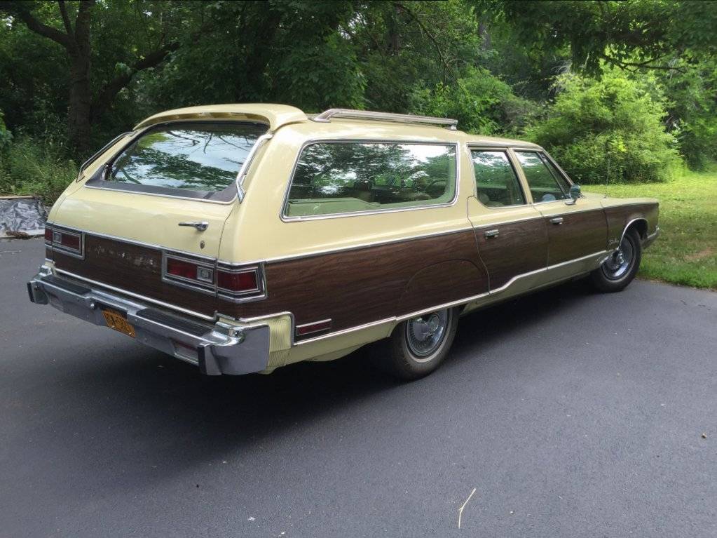

OK, so a photo would have shown that I have a 77 not a 78. Just a little difference there! I got confused with my recent 78 NYB addition.
So I am pulling off all the trim in advance of paint. The roof rack gives me the most concern

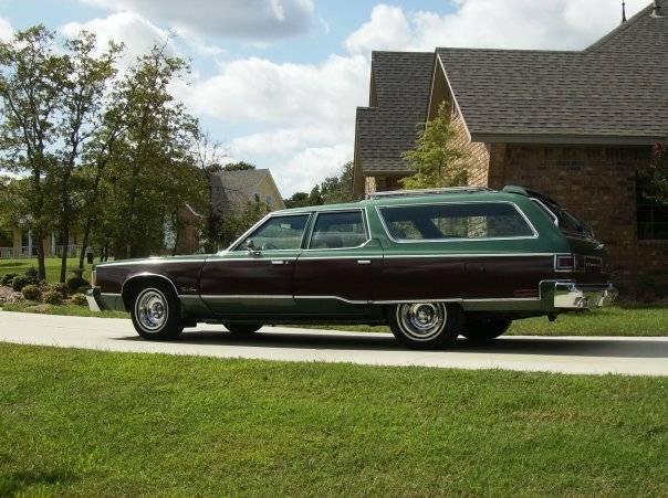

My wagon:
