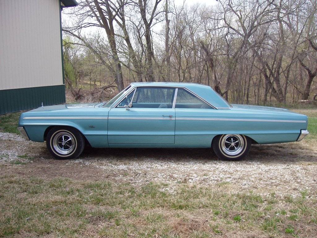

Thanks again for all of the input. Some people went beyond the scope of the question, and some people clearly didn't read my own comments about what I've done/not done, but that's all ok. It was a great discussion.
As I suspected, 10mpg is about right for putzing around town with what I have. I'm gonna do a long road trip and see what she gets on the highway, which I think will tell me more about whether my upgrades have made an improvement or not.
I definitely have a plan for the car going forward - installing dual exhaust and a 3.23 rear end taking the priority. If I get crazy enough I might seek out a 68 or later 440 with all of the "Super Commando" "Magnum" "TNT" specs and replace my existing engine outright, but we'll see. I'm not drag racing the thing . . .

A few sensible things that you could do that would help mileage with your 383:
Replace your water pump housing with a lighter aluminum unit and pump.
Replace the intake with an aluminum dual plane, square bore and 600 cfm Edelbrock.
Install headers and duals.
These upgrades will take some weight off of the car and add some performance at the same time.
While you’re in there you can remove the timing chain cover and see what is what in there. I know you said the PO told you it had been rebuilt but without proof, who knows?
Like I said before, right now you don’t have to run the high dollar gas. Put the cheap stuff in it it.
Swapping in a heavier engine with 57 more CID and a CR that demands 91 octane? Add some lower gearing?
You can forsake all hopes of better fuel mileage!
