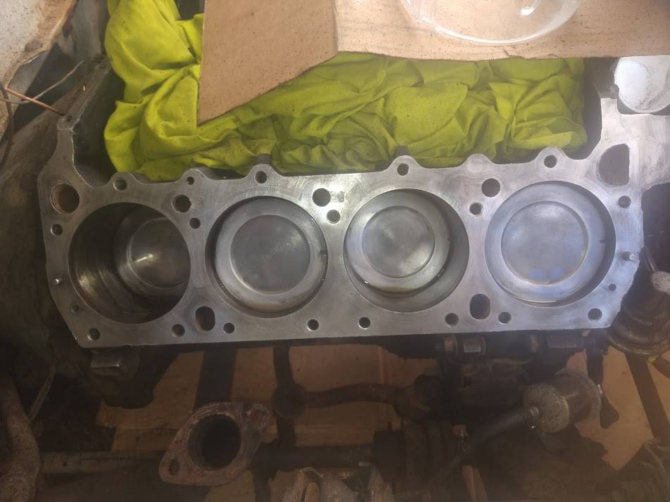

NOW we're ready! Squirted a little 5W-20 into each bore after cleaning, then swabbed the deck w acetone. Time to CLOSE IT UP!
Here's where being "Mr. Meticulous Autistic" pays off. I liked labeling each bolt as I pulled it. The baby food jar contains hexachloro-ethylene,

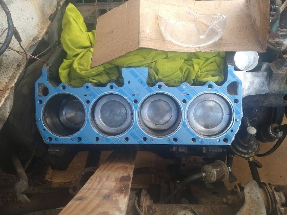

The gasket lays ready to have the head and be bolted: The board I thought would serve as a good rail to help guide the head down, but I had
to just put my foot down on the ground up front by the fuel pump, and CAREFULLY curl that iron down, put my bare fingers under it just above the dowels, then ease the head onto them. It went pretty nicely, and God-willing, should seal. I then put my numbered, cleaned, (with a PLASTIC brush!) bolts in, after dabbing a spare amount of 5W-20 on one side of the threads, wiping it around to just coat them, then torquing them down as per MoPar's venerable instructions.

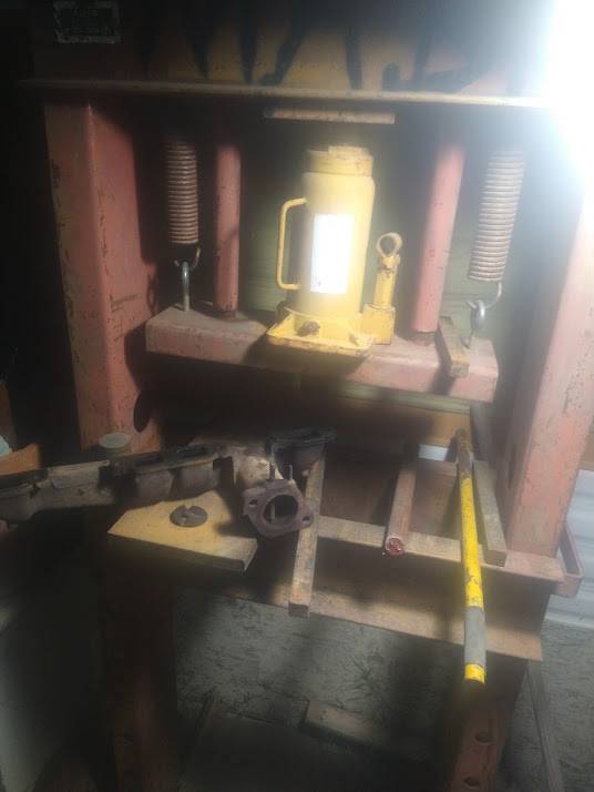

One Last pleasure to Share for now: I pressed out that damned warm-up flap valve in the exhaust log! This motor will never be afflicted by that source of overheating again.
See how handy a 20 ton press at home can be? Every Moparian should have one!

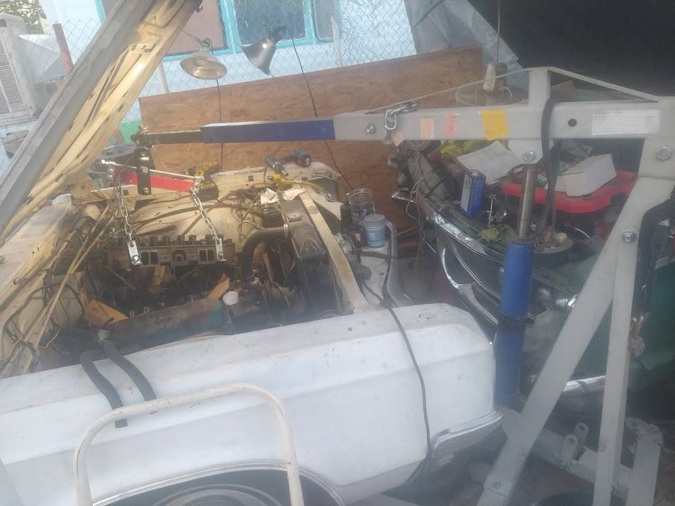

So, I limbered up my shop crane, extended the boom another 24" with some unistrut, properly bolted into the main boom, and now can handle that ~60# iron with ease and precision. I'll show that off soon enough, going, then coming, as I figure there are more than a few elderly men (or women) attending to this Forum who can benefit from such lore. My MAIN reason for typing and showing in detail what surely is a monotonous bit of drudgery to seasoned mechanics is to give hope and courage to those folk who WANT to do their own jobs, but FEAR to. My work here is for THEM.

ANYWAAAAY, the driver side head came off easily with the help of my shop crane, as shown below:
HANDY isn't it? It will be more so when time comes to INSTALL the head, over the new gasket. Yes, that's poor Mathilda in front of Gertrude. See now why I had to extend the boom?

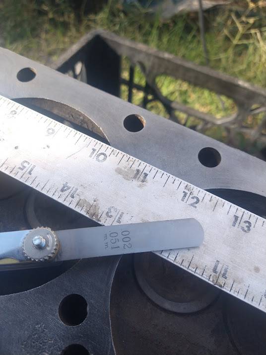

Pity I didn't have a TRUE straight edge. I warned the Babushka that this ruler, while good for most of my shop work, wasn't true.
I figured if I couldn't jam a .002" feeler under that ruler, I probably was OK. Now, I remind myself that with head gaskets, 99.9% STILL FAILS!
Here's a handy tip for those who view the exhaust crossover as affliction. You can press the flap pin out, then remove the thing. I returned the pin to the manifold, just to close the hole ,made for it.

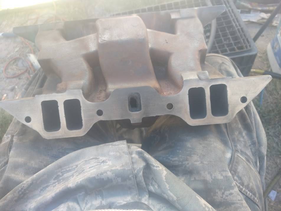

Here's the intake manifold, scrubbed, then burnished. At least I sealed THAT properly. NO evil hiss of vacuum leak ANYWHERE. That carb never gave trouble on the other motor, and likely will be returned to it, at least, until I can get the Edelbrock 1405 rebuilt.

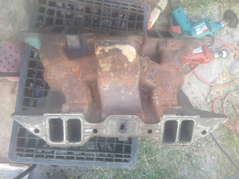

Like anything else with any atmospheric exposure, the intake showed some erosion beneath before cleaning.
