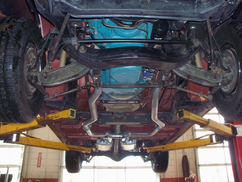

    My Father in Law took the 65 to a local guy I know. It turned out good.
    • Like Like x 2

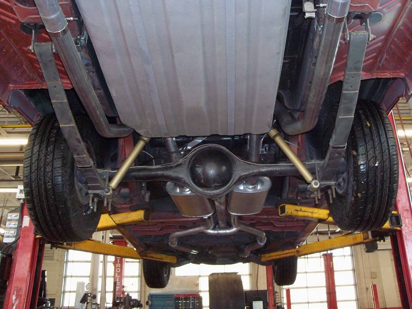

    TTi on my 68 Newport.

    They are my preference for reducing engine temps, improved fuel ecnomy (if you can stay off the go pedal),and a gain in torque and HP is a plus.
    The H pipe on the TTI makes the exhaust quieter than you think.

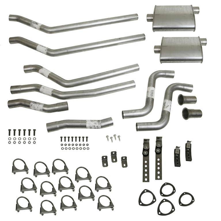

    This system from Summit is for headers and back.
    1974 DODGE CHARGER Summit RacingĀ® Header-Back Dual Exhaust Systems SUM-680140.
    For the price,261.99 --worth getting and when at your exhaust specialist,he can cut the crossover and weld in front pipes to mate to the kit.
    Did that to my 73 wagon.
    Bonus is you can do headers if you want later down the road.
    I had done this before and used the Summit kit on other Mopars. (68 Dart GT 'vert and 74 Challenger Ralleye 360)
    Fits very well and the two piece tailpipes make adjustments a breeze.
    TIP: snug all the pipes up and check for any rubbing or banging.
    Once set,tack weld the pippes in place and air ratchet down the supplied clamps.
    As I mentioned the 74 Charger and the 79 Cordoba are both B bodies and have the same 115" wheelbase and the kit will fit.
    Hope this helps
    • Like Like x 1

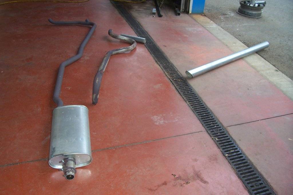

    For reference since my wagon is a B body same as your Cordoba.
    Top pic shows where the crossover was cut.
    Second pic if you look closely see where the new pipe was welded to the front pipes going to the manifolds. The welds further down on the intermediate pipes is where the headers would have been.
    • Like Like x 1
