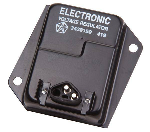

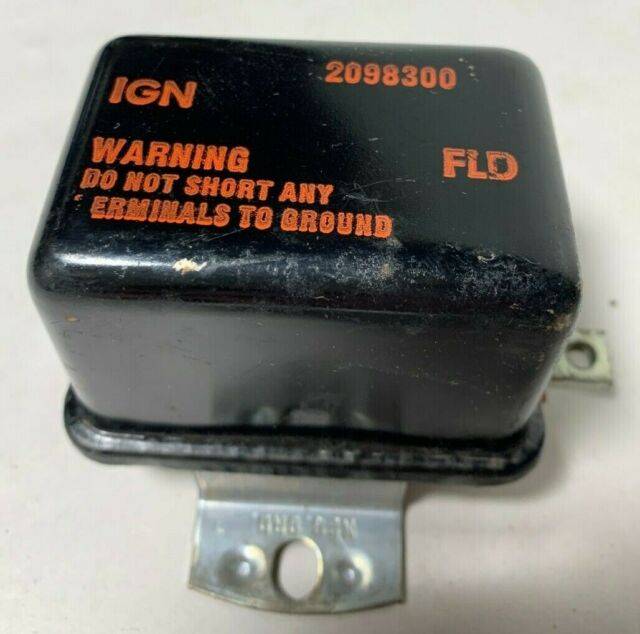

So... Did the regulator you pulled off the car look like this?
Or like this?
Then just to cover our butts, what does the new one look like?

My VR is as pictured 2nd: the box with a connection at each end.

I read through the suggestions you made in this thread and I realized I misread what you said when you asked which VR I took off the car. Actually it was the solid state 1st one, the 2nd old-style with points is what I bought and want to install. Very sorry to screw that up. I plead sleep deprivation.

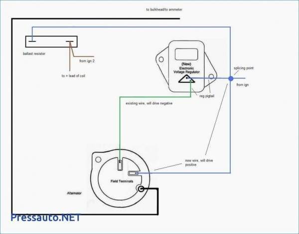

A little history... In 1970 (or 69 with Imperials) Chrysler changed to the isolated field alternator. This alternator used 2 field connections. One field connection went to power (switched 12 volts) and the other went to the the voltage regulator. Very simplified is what would happen is the battery voltage dropped and the VR would complete the circuit to ground... and that would energize the field which would make the alternator charge.
In the '69 and older cars, the alternator had one field connection. That went to the VR and the other end of the field was grounded internally to the alternator. Again, simplified, the VR would control the charging by switching 12 volts positive to the field, and that made the alternator charge.
So, which is better? I can make arguments that it really doesn't matter much, but I'll give the nod to the later version as having some advantages. First and foremost, the later VR seems to be more reliable and easier to find. It's still a simple system and it works well. You have that... so use it.
Instead of grounding one of the field connections, you now have to connect one (doesn't matter which) to the VR and one to power that switched on and off with your ignition. This means not using the new VR and instead using the existing one... As I'm reading it, there was no issue with it, just an alternator bearing.
Here's a simple wiring diagram that I found. Note that the VR and one field connection gets power from the ignition at the ballast resistor. This is a good place and what Chrysler used for this setup.
