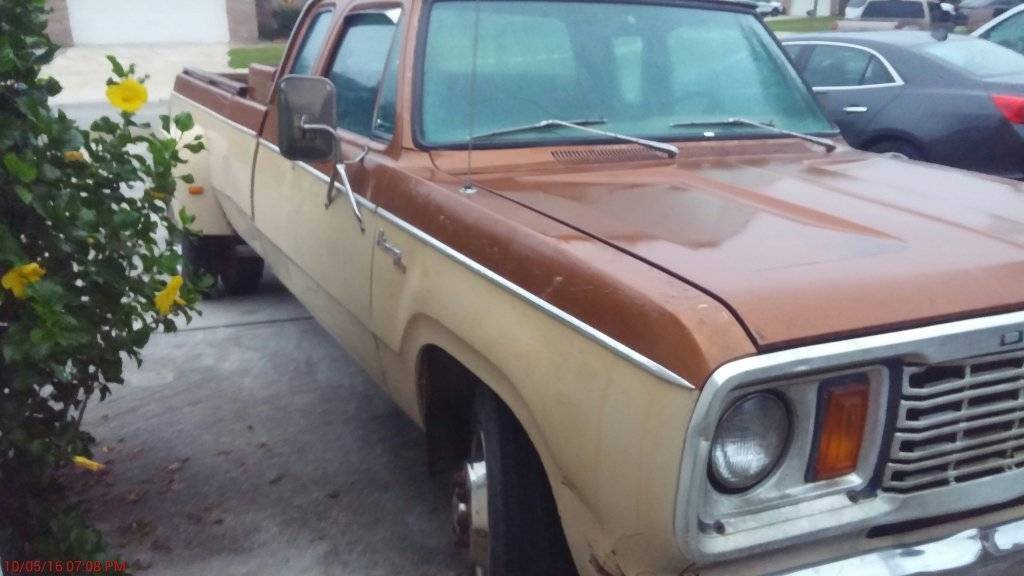

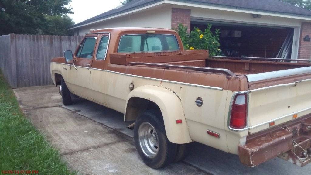

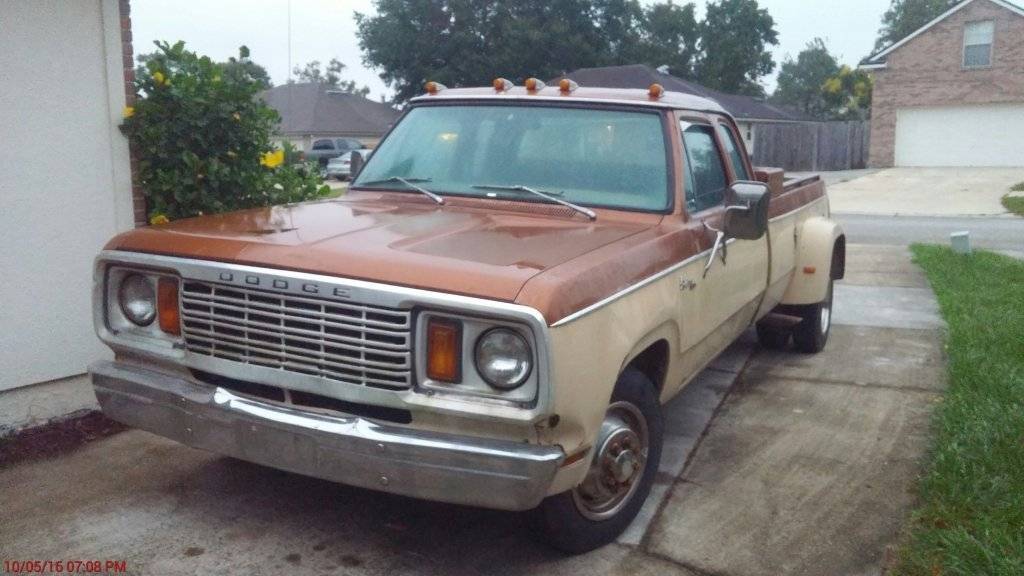

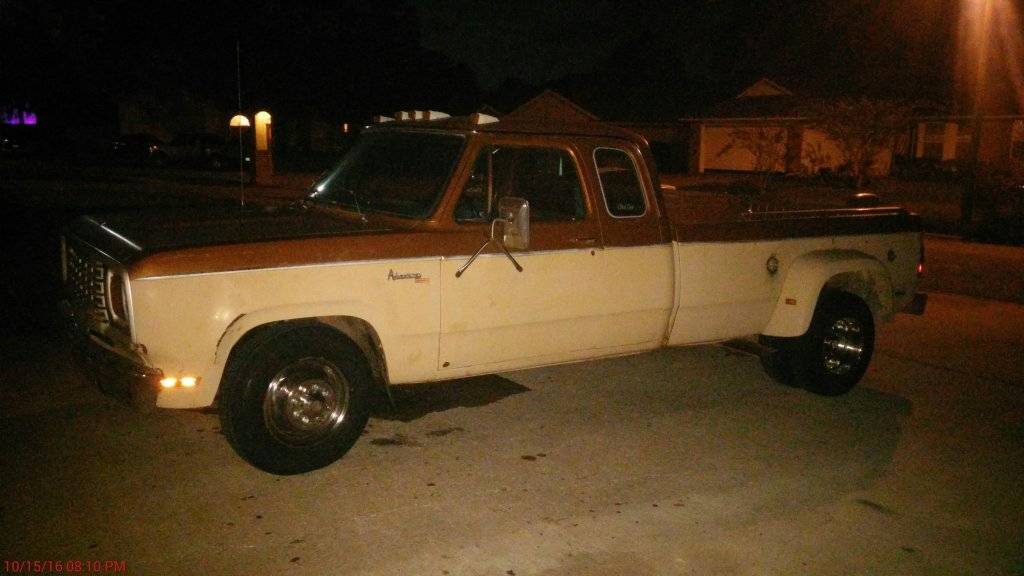

Another orphan found our driveway...

Looking at the truck again, wow, sure is a beast!
Appreciate the info on the tanks! Will have to take a peak at em when its here.
I'm sure I'll bug you guys when the time comes lol.

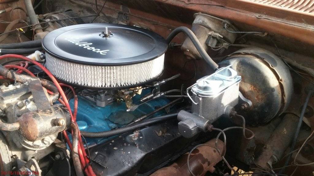

The next day the old eddy 1405 that was on her puked her guts all over the engine. After a trip up to oriellys, got a new 1406 on top. She fired right up.
The kickdown linkage is binding up, and the throttle cable is VERY jerry rigged. Ordered a new matching set of lokar cables to go on, along with a TON of other parts on the way.

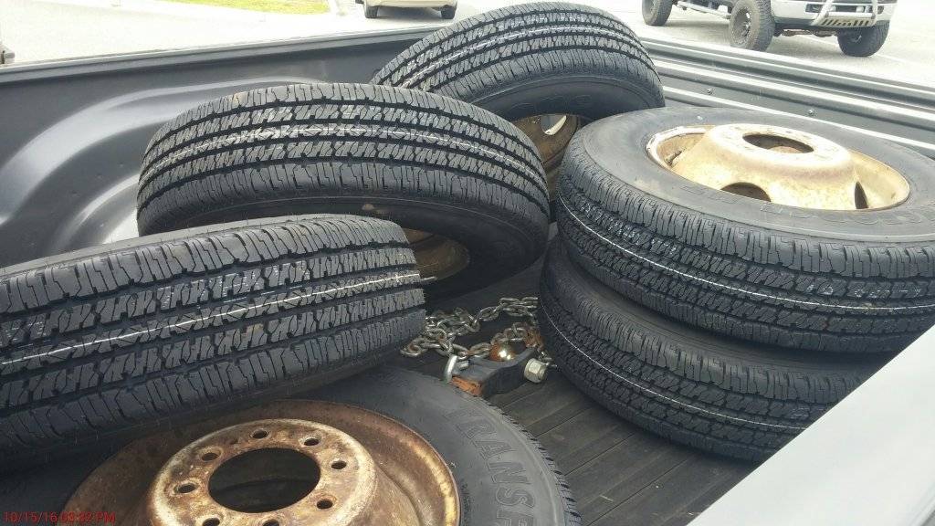

The other rims don't want to fit. Lug holes arn't big enough, and I don't want to drill them out. We sourced a new set of firestone tires for the original 16.5" wheels. Only 2 tires availble new in this size. The firestones, and some chinease brand "Road king" lol.

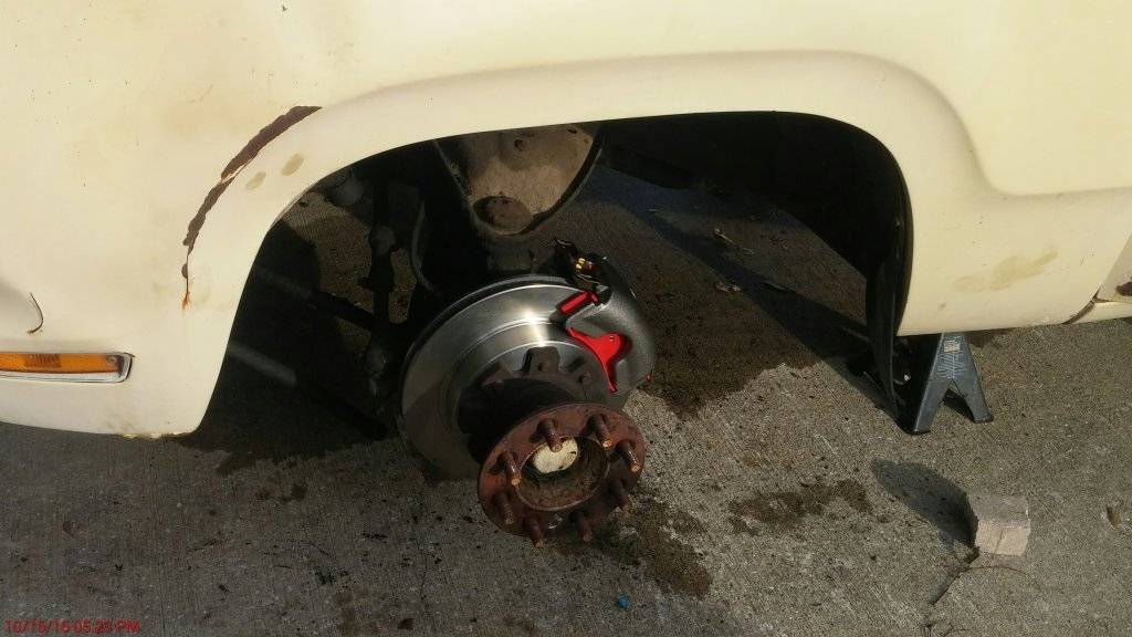

Been a BUSY, and long week. Been doing a ton of work to this old girl.
Rear end serviced
Sway bar link bushings
Front calipers, pads, and rotors
Master cylinder
POS, and NEG battery cables
Lokar cables installed
New carb tuned
Air cleaner
New tires
Wheel covers cleaned, and polished
Some more I'm forgetting lol

The lokar cables made the biggest improvement. Its like we unleashed 100 more HP putting these on. With the throttle cable working correctly now, along with the kickdown working correctly, its a diff truck. I already have the kickdown cable for the Blumo. Might do the whole swap over like this. I like it alot.
