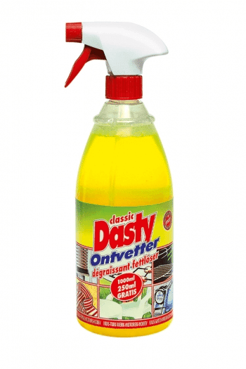

I don,t think they sell this in the US but this is the best and fastest way to make them white again .
No hard scrubing , spray it on , wait 5 minutes , was it of and ready.
Wibra is the only shop selling this product and they sell a lot of these bottles.
We use it for bikes , motocycles , boats , caravans , BBQ,s , ..........
Dasty superontvetter met sproeikop | Wibra
But on an old car that doesn,t look new i like them a little yellow..........
