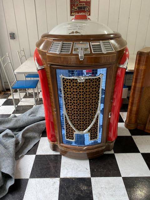

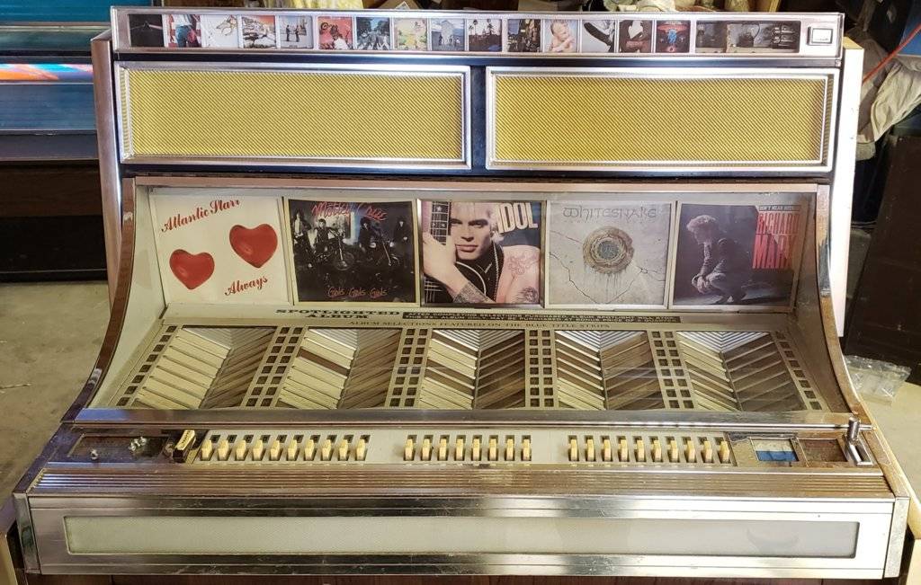

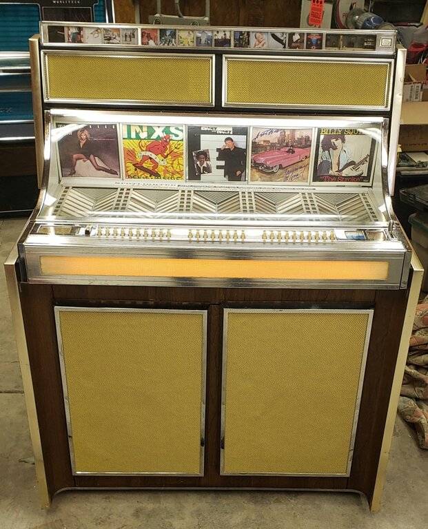

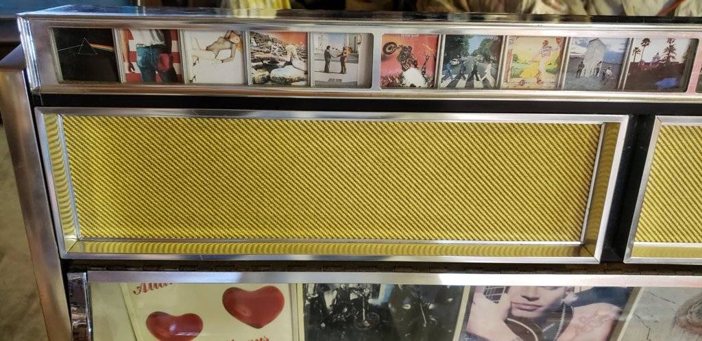

Finally got my next project cleaned up. I have got the components ready to go into one machine. Tomorrow I start installation and sorting out the mechanics. I had to do a little cosmetics, the speaker cloth is mid 60s Fender cloth I had left over from a sub woofer I put in Goldie.

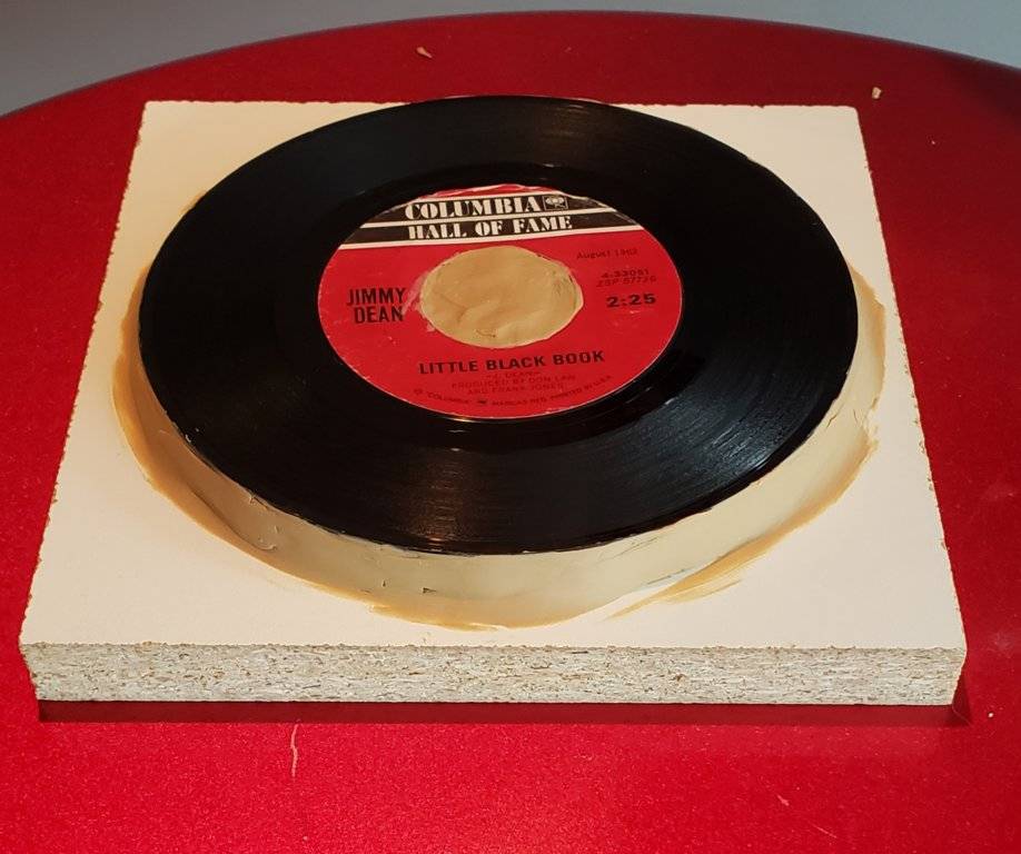

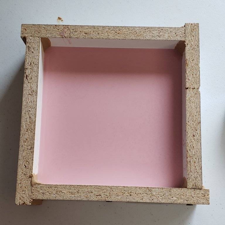

I bought the materials and made my 1st pour of a squeeze mold, to try and reproduce a stereo double sided 45. The only reference I have is a mono one sided 78 which was successfully made. I am using the same mold material and polyurethane resin for the actual record.
I will complete the mold this afternoon and then Monday evening pour my first record. It will be another couple of days before I can actually play it.

I bought 2 parts jukeboxes for $50, seems likely the parts which were removed were probably the only parts which were functioning. I have had 2 components professonal rebuilt, and I can see 2 more may be above my abilities.
So it looks like my abilities are cleaning and cosmetics on this one. Covered the lower woofers.
The good thing is I have a great local business working on my components and these things are basically indestructible so they can all be rebuilt.

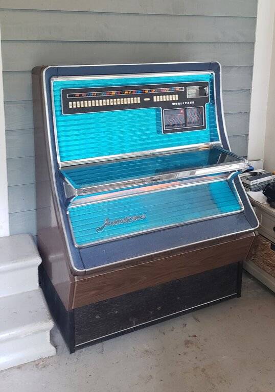

I got the Wurlitzer finally to the house and will be able to enjoy it all summer.

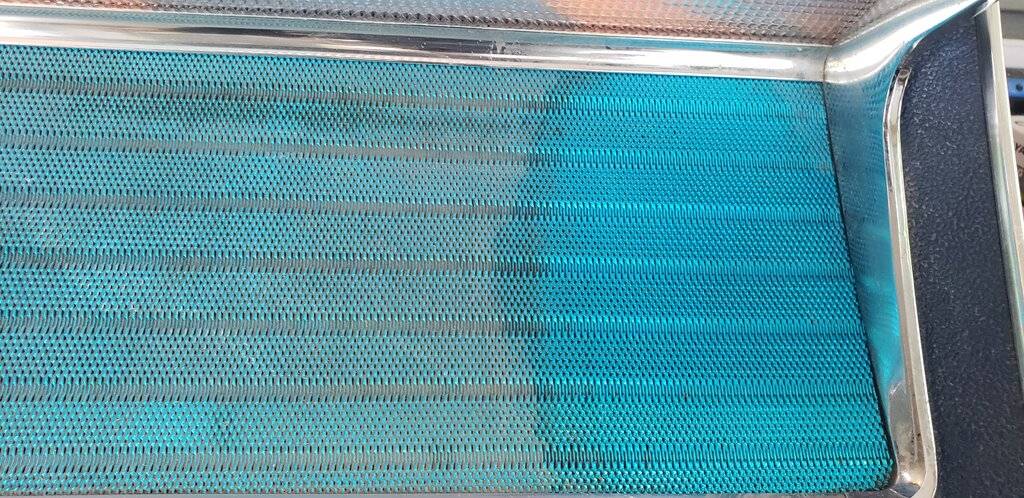

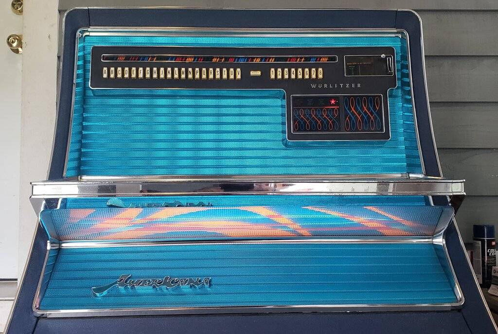

The blue grill is anodized aluminum. I couldn't get over how well it cleaned up. It is shiney and bright like new. There is a before and after shot. The dark blue surround band is pebbled vinyl and I found a SEM dye that matches perfectly. The lower black panel is a steel grill and I'll just repaint it black.
Well it took me a year to get everything sorted out to get this one working. Literally every component has been rebuilt. Based on the records installed it has been about 40 years since it ran. This one will be my shop jukebox after spending this summer in my breezeway at home.

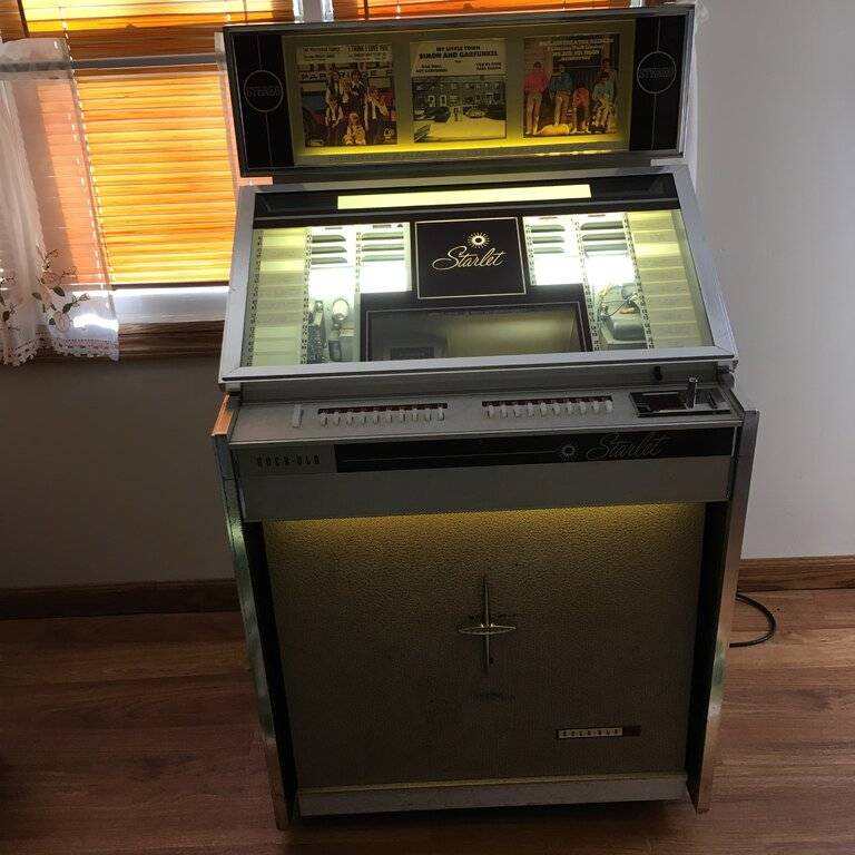

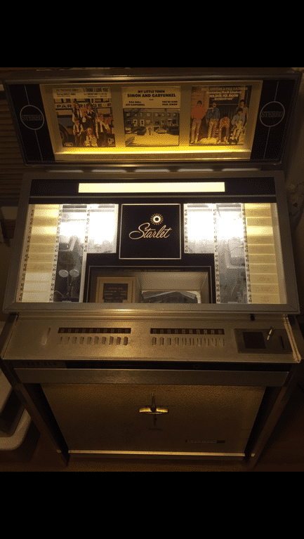

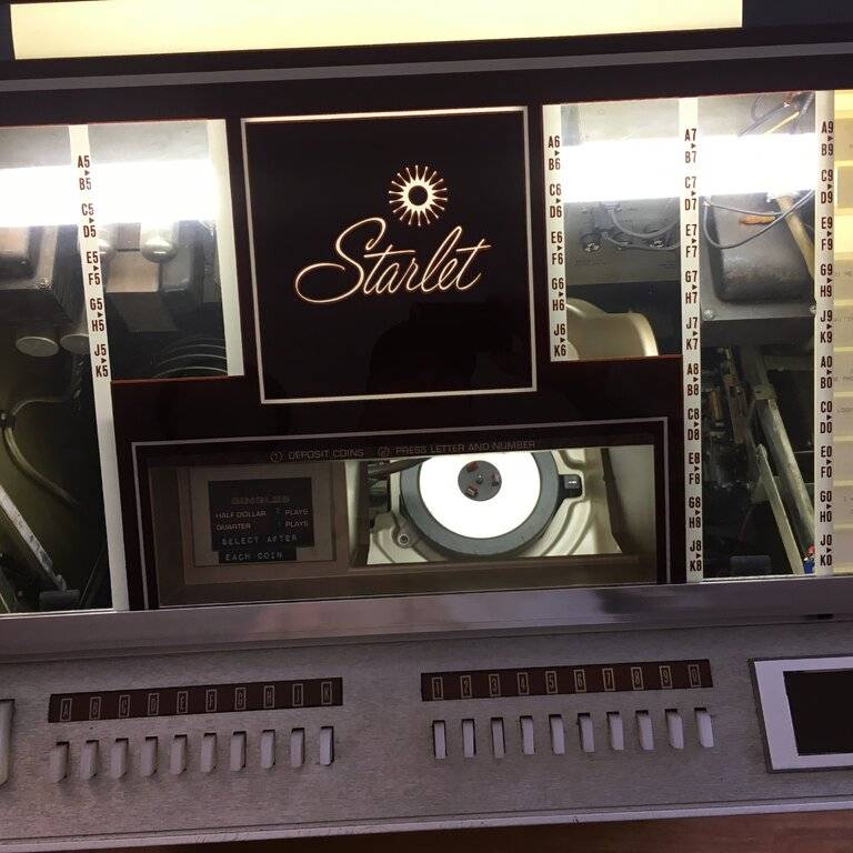

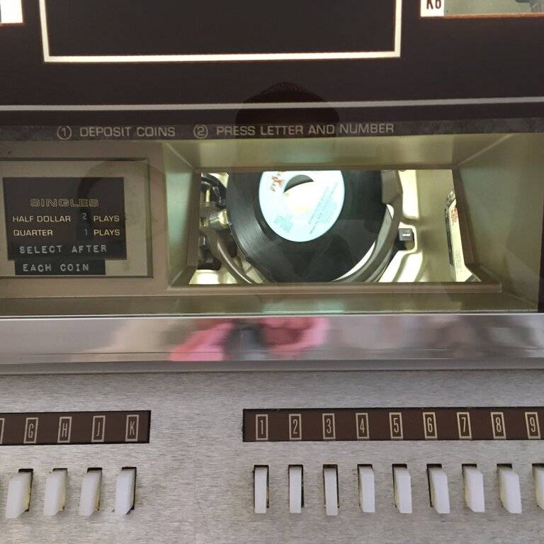

I saw this topic a few times and now I have a reason to post something. This Rockola Starlet was my nieces’ who got from her Godparents. I traded a pop up camper for it. It’s working well since tinkering with it. It plays most of the selections but not all. The volume control has intermittent highs & lows and can change with a change of a 45rpm record. I did get two big bins of 45’s. @Zymurgy, you have some beauties there and now “pressing” your own records damn impressive.
Wow that looks in really good shape.
On the volume control just for the hell of it shoot it with the electronic cleaning compressed air, it did the trick on mine.
I’ll try the electronic cleaning compressed air, once I figure out what it is, lol, and get to the volume control on the bottom back. I’ve already learned how to open all the doors and compartments. I’ve also seen the plastic “song call out” holders, parts, and a manual on ebay.
@haywire 440 if you are on FB I would highly recommend a Rockola group. I am in both a Wurlitzer and Seeburg group and they have been extremely helpful. There is some really knowledge guys out there.
If you haven't already bought a service manual get one. I really like an original hard copy if not available Jukebox Arcade makes an excellent hard copy with usually every thing available for that model, including the installation and operation manual.
