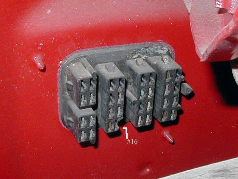

Glad to hear you got her fixed! Years ago my Fury had a dead battery. I jump started it, drove around and all was well until the next morning, dead battery again. So, new battery, worked for a couple of days, then dead battery again. So rebuilt alternator, and a jump start. This worked for nearly a week, then dead battery. I played this game of throw parts until winter when I parked the pig in back yard. She sat for 20 years. As I was taking everything apart I discovered my "bad battery, bad alternators, bad voltage regulators" hiding in thed bulkhead connector.

If only I had used my multimeter instead of my wallet to trouble shoot. What irritated the most, I'm an Electrical Engineer and darn well know better. BTW, pin 16 on a '70 car is the main battery feed and if it gets dirty, it gets hot and burns the connector. If left too long, it burns the whole car.

Anyone who says they have never done something really silly and embarrassing even though they knew better is A LIAR. Thanks for sharing, I appreciate the insight and consequences...even though I know better too. Cant count the number of crispy connectors I have redone over the years, often due to a little corrosion somewhere... I often have found poor ground connections are damaging to electronics too...
I still have not had the time and energy to check out the Imperials as I would like to...and some of the wiring in this generation of cars has caused me problems in the past. I do not want to let myself get lazy and comfortable about this stuff.
Eep! That will give me no end of sleepless nights now! Ill check that bulkhead connector out this weekend. Gonna be 20 degrees Friday woohoo!
