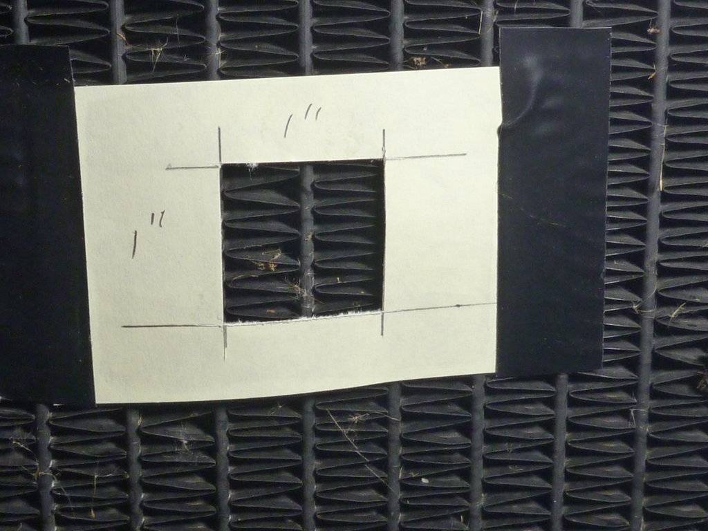

Mine ap[pears to be a tad over 1.25" thick, two rows with fin spacing of about 10 or 11 per inch. In theory this should work, but it doesn't. I notice the fins are not continuous, they have bits cut out. Maybe to reduce the weight (cost) of copper.

I started this thread ready to buy an aluminum rad, but after a ton of google searches, I've changed my mind. Copper is a much better conductor of heat than aluminum. Aluminum can't be easily repaired if a stick, stone other other road debris punches a hole in the core. Copper is easily soldered.
Mind you, a gleaming aluminum rad with an array of pusher and/or puller fans with a thermostatic control for the fans looks very sexy. However when you add up all the parts and compare it to a top of the line copper rad, the aluminum option is twice or more expensive and nothing is repairable.
So copper is king and the question becomes number of cores, tube size, fin size and fin spacing. Be interesting to measure the dimensions of a unmolested factory 22" rad from a 383 or 440 car.
