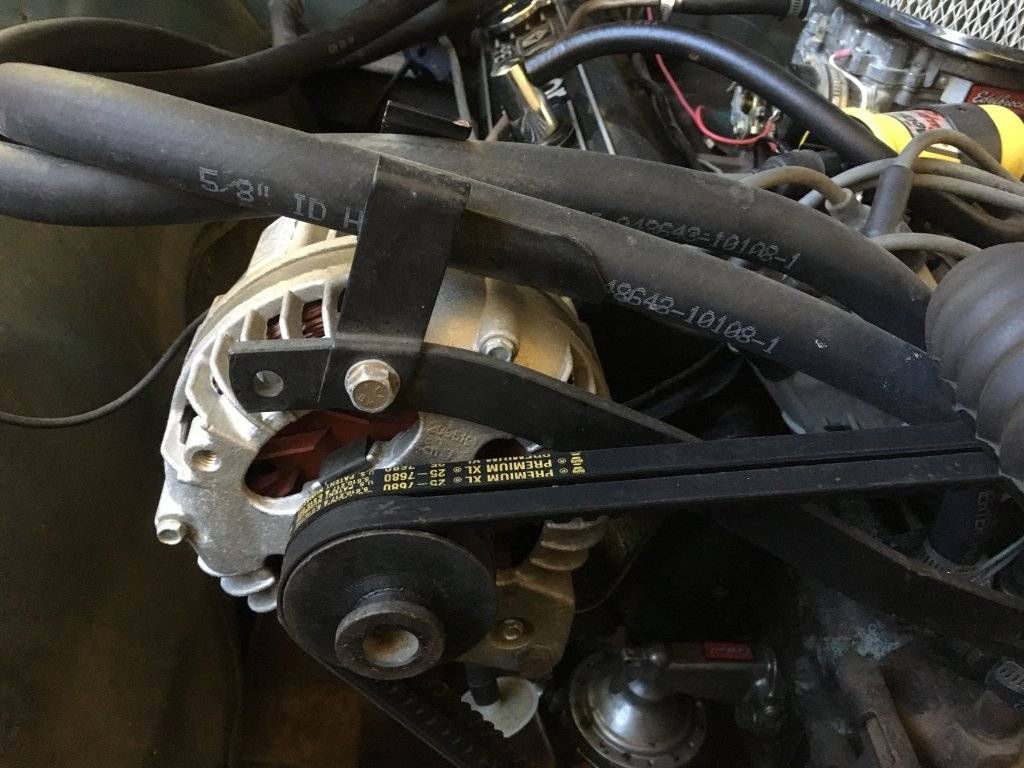

    See the pic below where the alternator adjustment rod is bolted to the alternator in the inner most hole. To get the maximum belt tension without going to the end of the slotted section by the thermostat switch to the outermost hole instead:

    Ross, the bracket you show is confusing me.
    [​IMG]
    • Thanks! Thanks! x 1

    Hmmm ... on my car the slot is on the thermostat end. I can see that reversing the tensioner rod wouldn't work as pictured on your setup. However the solution is basically the same - move to the other bolt hole and there'll be an inch more adjustment available on the belt.

    Yah, see what I'm saying? Don't recall ever seeing the bracket installed the way it is in your pic.

    As far as I know the way it's shown in my pic is correct for 65 - 66 and I think 67 and 68 AC big block cars. That's a pic of Rexus' motor.
    I am not sure on later years, such as shown in your pic.

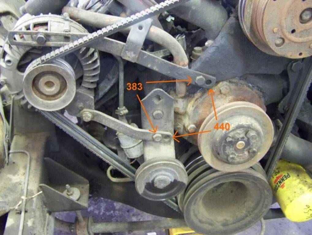

    The number of Mopar brackets and combinations out there can make your
    [​IMG]

    Just this minute I saw this in another thread.
