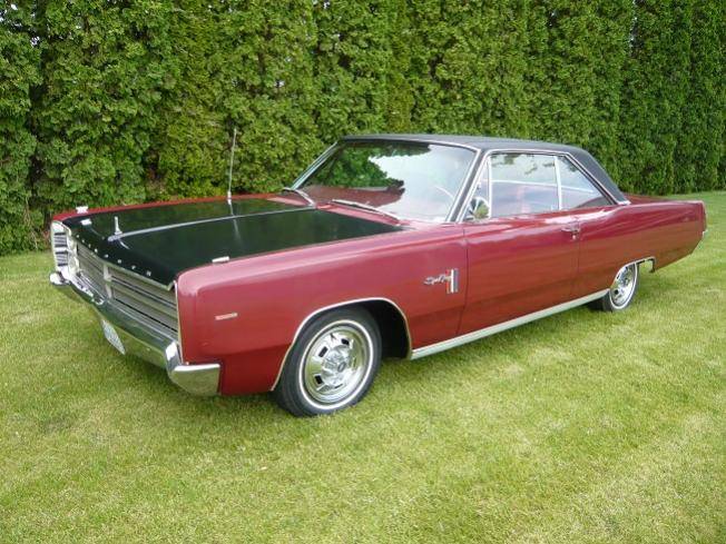

Thanks for the quick response. Yep! your right...the window sticker says "sure grip" differentail. I didn't think Furys had a black hood option. What is strange, I can't find any sign of original red paint anywhere on the bottom of the hood even in the hard to get to spots under the reinforcing structure. It was a woman who originally purchased the car. The lady passed away a number of years ago and the car just sat in an out building. Her son said the car had a black hood as long as he can remember.

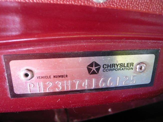

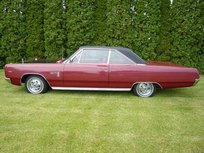

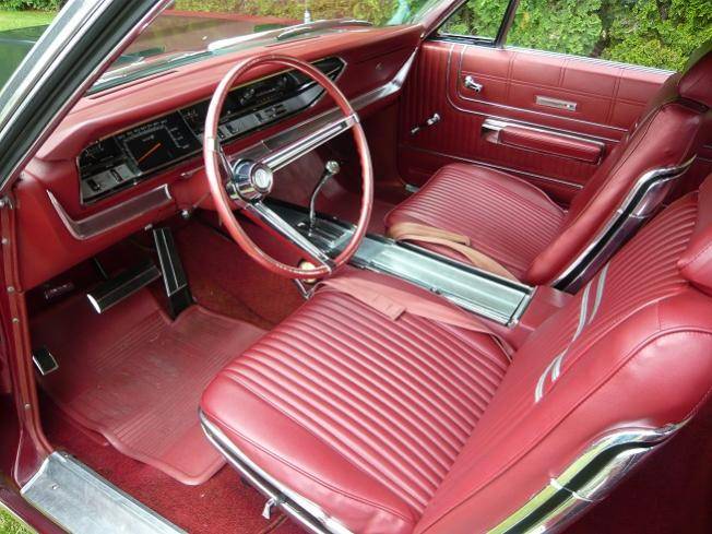

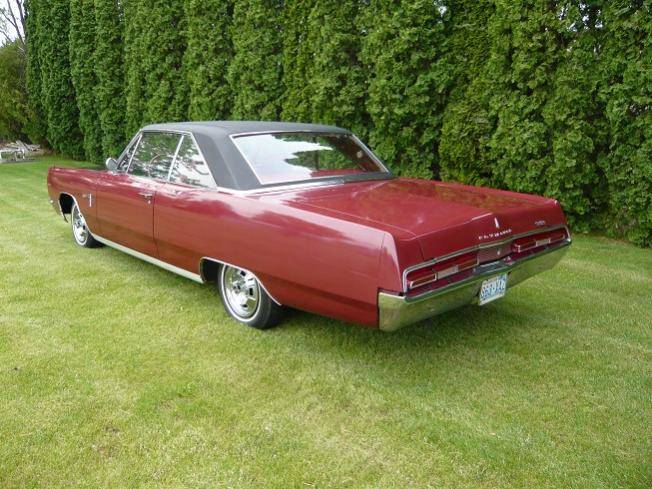

I live in West Richland, WA (south eastern part of state). Car was sold new in Grandview, WA at now defunct Anderson Motor Co. and was always within 40 miles of where it was bought. You asked for photos...here they are...probably too many

Replacement hood from an accident????
Collision replacement parts come in primer. That shiny black hood had to come from a another car unless the painter was a real perfectionist.

Could be... That is the most logical answer. However, if there was a front end accident, the front of the car and fenders, if involved, are perfectly repaired. Since the black hood has been on the car for at least 35 years, one would think insurance would have covered a new correctly painted hood. Perhaps a hay bail fell on it...and the son, in his youth, rattle canned the hood black before his mother found out...!!! It is a mystery to me.
WOW....... That is one NICE Sport Fury......!!!!
Even when mopar painted black on the hoods of their cars the bottom would still be the main body color. The hood on your car most likely was replaced. I'd get it to a good paint shop and have it color matched to the car.
Gorgeous car, talk about falling into a bucket of **** and coming up with a ham sandwich......she is sweet!!
IF........... and thats IF the hood was originally black the cowl would also be black ..... it serves the car well with its HP heritage, I like it
