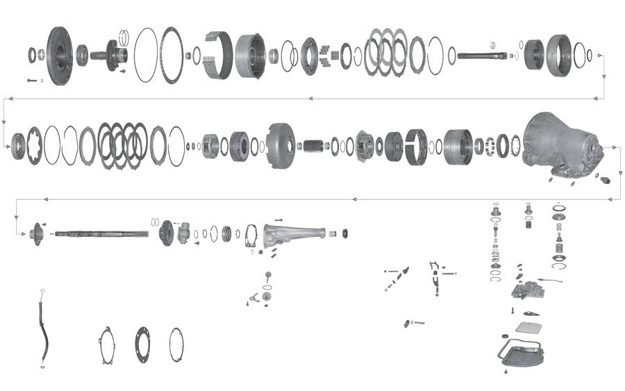

Whatever It Takes Transmission Parts
https://www.wittrans.com/parts?type=A727

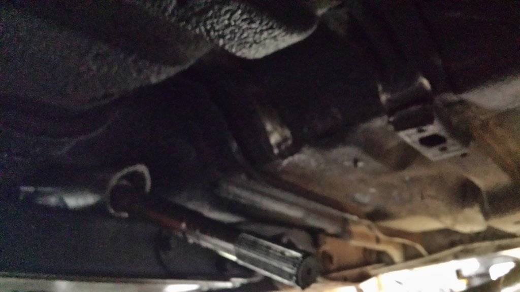

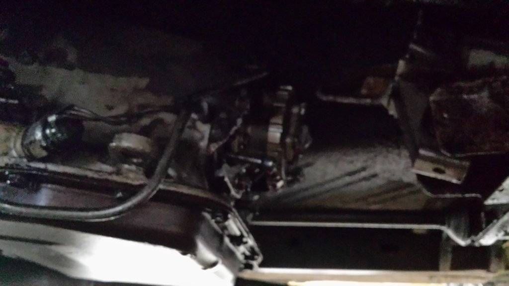

Holy crap! I've never seen anything like that before! Glad you two are ok, doesn't look like the car suffered much, but it could be repaired. Did your car have that U shaped brace that bolts in just behind the front seat? I would have thought that if in place it would have prevented the drive shaft from dropping at least.
My assumption is that you will take it to a reputable transmission shop to diagnosis and estimate? Or will you just treat this as one of life's mysteries and swap in another one? Those pictures are amazing and scary. If it was me I'd like to know exactly what happened. Running these old cars is a constant learning experience.
