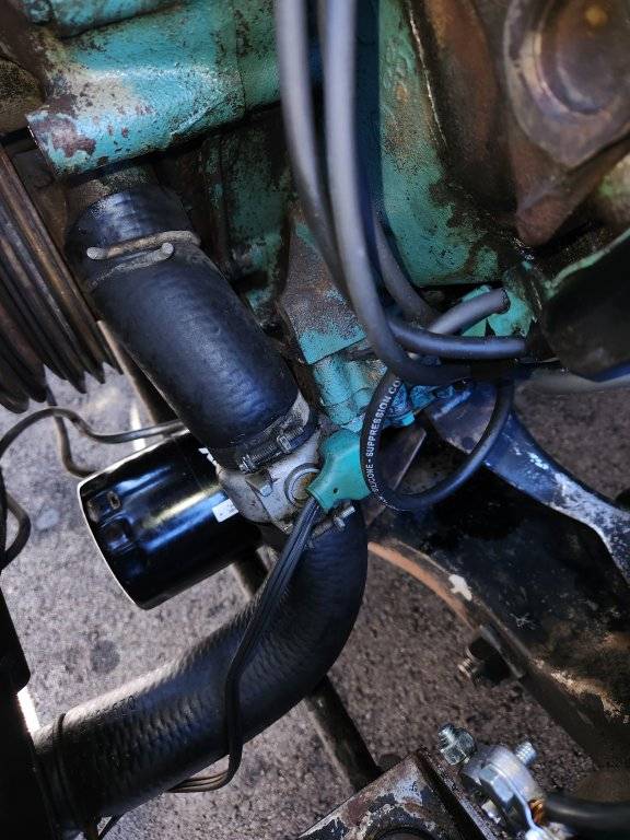

This is what is on my '68 300. The build sheet I found under the driver's seat is not marked for engine block heater but there is one on the car. This was a car ordered at the dealer for a customer in Minnesota. Dealer installed?
A block heater is in the block. That inline hose heater was sold in an auto parts store. We still had those on the shelf in the late 90's at the store I worked at.
