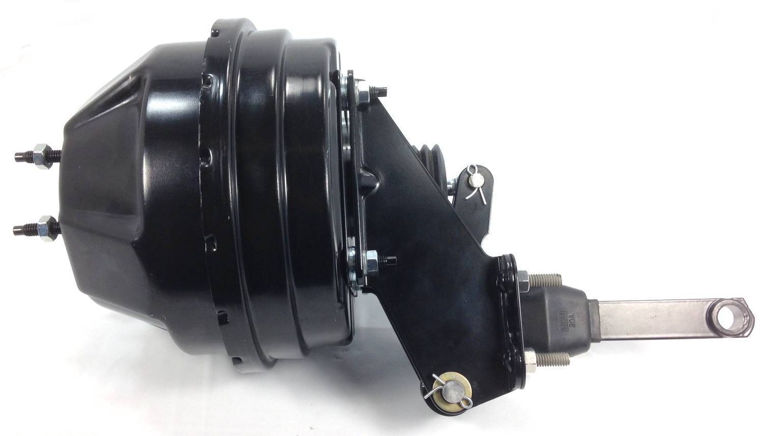

Isn't that why MA had this style booster in a B, why not a C?
A very similar booster was used with C-discs in 70, perhaps 69. C-bodies used different pedal bracket assemblies between MB and PB, and some of the other car lines did not, so a different leverage bracket setup was required for them. I've seen that bracketry in some B-bodies and A-bodies, and as a PB retrofit for Cbodies. Don't know if that's the case here relating to fitting a Hemi, though.

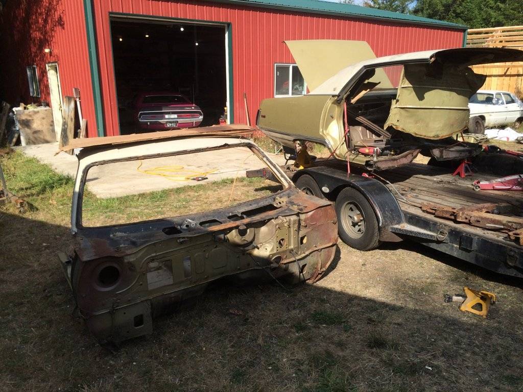

Thanks for asking Dave. I've been busy with customer restorations and other projects, but I have secured a NON A/C front cowl, and floors for parts and repairs. I'll be stripping the tub soon for dipping soon. Then the metal work begins!
I've been gathering parts,...wheels, NOS heater stuff, bumpers etc., what I can find. All parts will be dated and matched!
Thanks for the update, when I first saw the pic I thought what the heck happened to the car then I scrolled down to the captions and now it all makes since.
