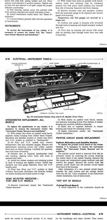

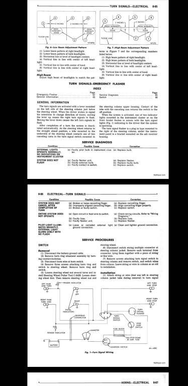

HEY SEND ME A PAGE FROM THE WIREIG DIAGRAMS & I WILL TELL U IF ITS RIGHT OR NOT if it saids this covers multiple yrs thats wrong all ready they make small chages every yr. & when u tryig to run down a wireibfg problem have the one for yu yr is vastly important

Which specific page do you want a picture of?

just pic one say of the dash wiring / the under the hood will sray the ame from yr toyr unless in 1970 they went to a electronic voltage regulator the wirig is all the gethe differant for a 2 wire ectronic one over a multiple wire mechanical 1. likei told u i have ben playing with mopars from 1978 . now m dad was all mopar , but he had all opars frp]om the 1940-50's

ow it maybe ok ut there is a better chance its all generized' im 70 y/o old . my first car was a piece of junk 1967 chevy impala it had a wore out 282 it burned a qt of oil every 500 miles then the next one was a 1969 4 dr impala i drove it into the ground . then i bought my firs mopar ( a 1973 dodge polara . @ 110k miles i built the 400 b motor it was all direct connection i used the dc racing book to build it . the car weighe 4560# it had 2.71 sure grip in the rear . with the cam & head work it got 16.5 @c115 mpr in rhe 1/4 it out ran a bunch of gms & fords (they couldnt cautch it on a staged elememator . when i got a 3-3.5 sec head start)

Sorry about you loss sir,
Here's the pictures which seem specific year enough.
