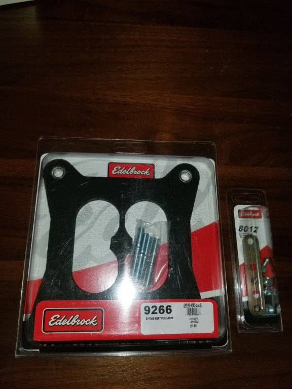

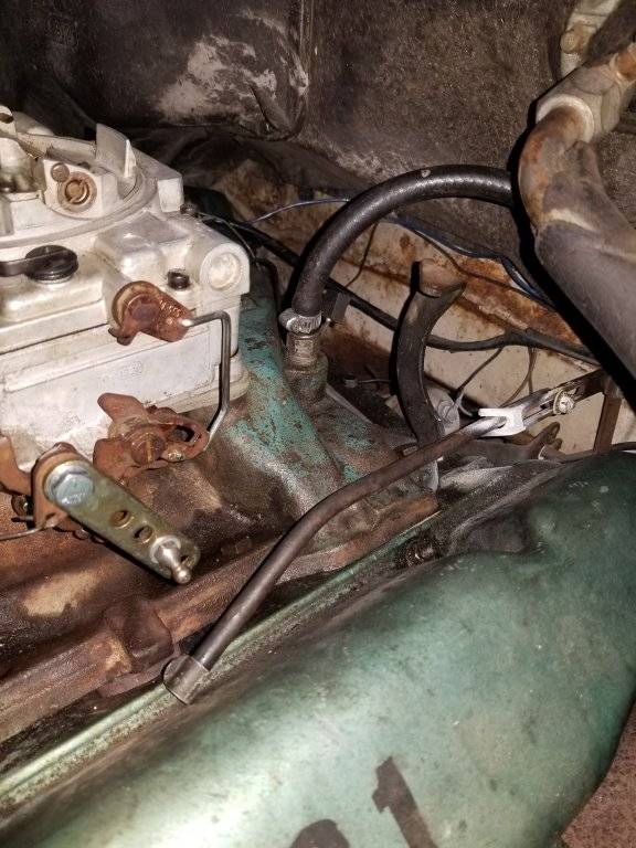

Parts arrived for the carburetor, this insulator & AT rod extension kit to rig up to the carburetor throttle linkage.
Insulator does seem like hard rubber of composition, i do hope it seals better than the fiber composition Fel-pro insulator.
I'll see if I can rig up the AT cable extension to work as a linkage connector without modifying/drilling holes to make it work.
Currently raining cats & dogs, cutting the task of the throttle linkage adjustment short for another day.
Going to wait til tomorrow, rain is supposed to stop then.

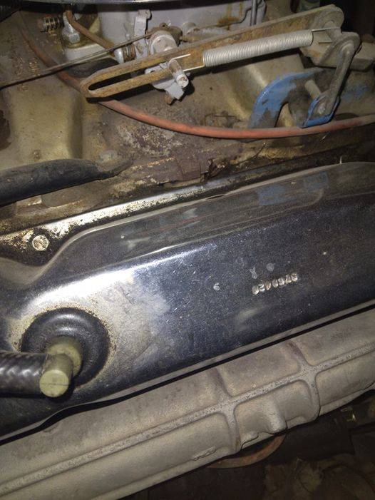

Adjusted the throttle linkage to as close as I can to make the throttle work.
Puted the car around the block
(mostly in 1st gear on the pushbutton selector)
Then switched to the drive selection.
but the shift is delayed, trans shifted into second but I didn't allow the trans to shift further in higher gears as I didn't want to potentially burn the trans out. Will adjust throttle linkage throw.

I just gave the throttle rod adjusting a try and the trans shifts way too late. Or doesn't shift into 2nd.
that cause it too short if u kep driving it like that u will burn the 727 up u need the right length downshift road . now if u pull the rod all the way forward it will up shift fast but i will have no down shift the down shift rod length & the adjustment @ the carb is critical just 1/10th of a inch will cause the up shift yo be early or late . after u get the right rod then tack it to a transmission rebuild shop& let them do the find adjustments
