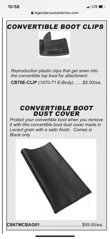

https://www.legendaryautointeriors....8/08/2019-Chrysler-A-and-E-Body-Catalog-1.pdf Page 106 of legendary auto interior’s Mopar catalogue
They say the clips are for an e body but they look a lot like what the Fury would use. At 5 bucks a pop it may be worth buying 1 first to make sure they will work properly.
