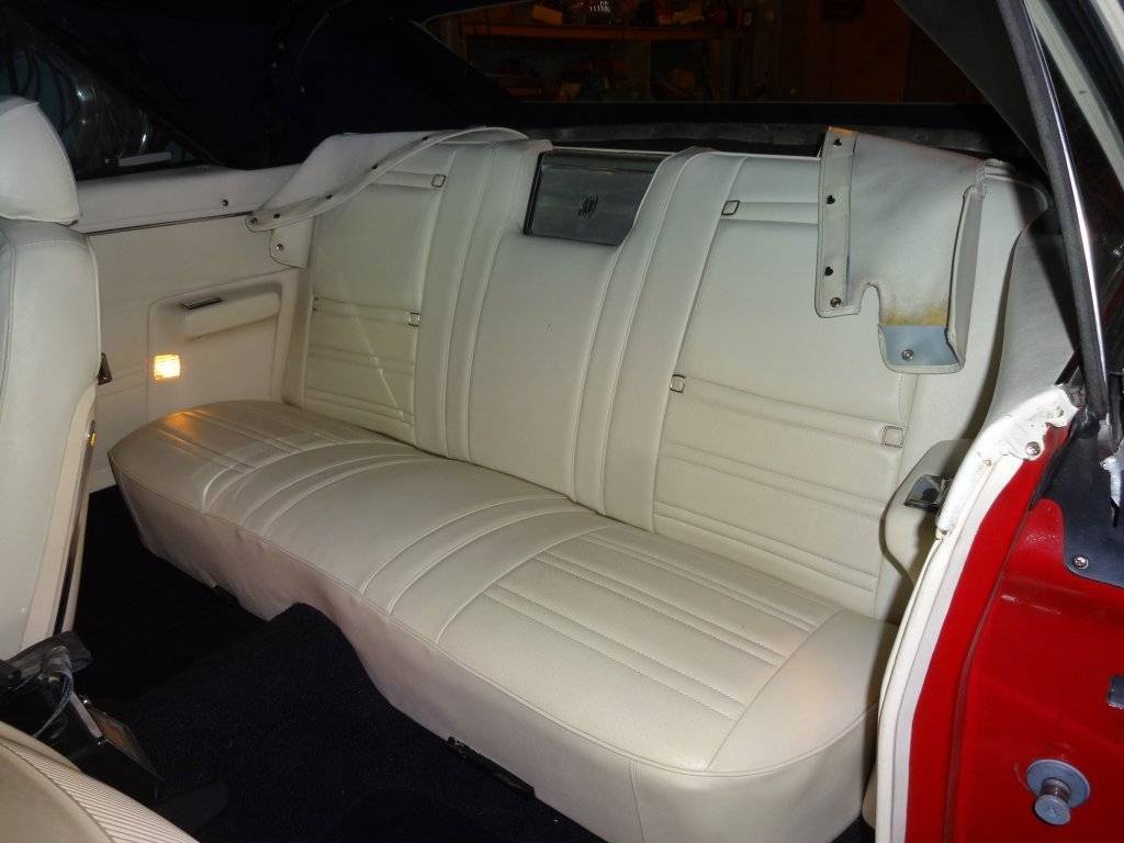

Here is a picture of the insert on the rear seat. I understand that the top is supposed to be painted "argent." They must have chromed the whole thing and then painted that section.

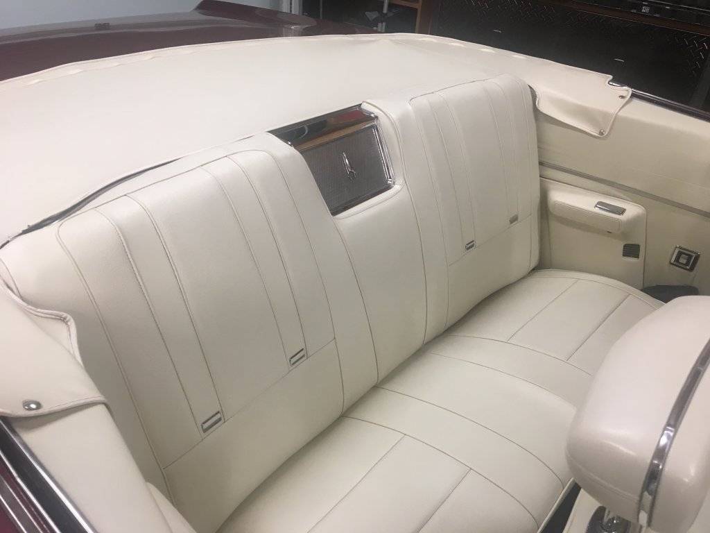

Jeff this is what came from the factory on my car.

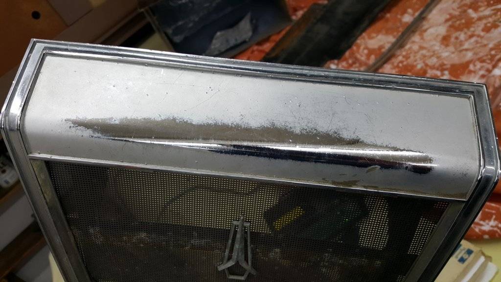

Paul cleaned it all up and decided to renew the argen. Since the argent is a matt finish he didn't clear coat it so a problem has appeared. Usually when I'm running with the top up, I just drape the tonneau cover over the back seat rest. That way if I get the urge to drop the top I don't have fiddle with anything, just pull the latches and hit the button. The tonneau cover rubs against the top of the speaker grill and now I have a bald spot with chrome showing and an argent smear on the top surface of the tonneau cover. So either clear coat it or just leave it chrome.

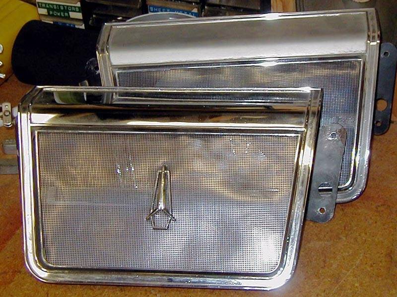

As it turned out, I had two grills, one argent and one chrome. The argent one is from my car, the other I'm not sure. They are identical except for the paint.
I thought the argent looked classier so I stayed stock, but whatever floats your boat works too!
Great info! That probably explains the bald spot on mine too. Thanks Bill.
I painted mine with this: NEW Mopar Performance Argent Silver RALLYE WHEEL Enamel Spray Paint, OEM Mopar | eBay
Matched very well to the original.
Shop around for a better price.
John, is there a close, off-the-shelf version of this color paint? Krylon or Rustoleum? I have painted the silver with some satin paint I had, but the chrome underneath does not have good adhesion even after first scuffing and then using etching primer. I plan on a re-spray only this time laying on a few coats of matte clear.
There probably is. I think I read that there's a Krylon that's close in color. I looked around and ended up with the Mopar Perf stuff. It seems to be OK... If you remember from Carlisle last year, I did have an issue with my grille, but after stripping the paint off, I decided it was a problem with the old paint underneath.
It's been my experience that silver paint in spray bombs is a little problematic anyway.... The thickness builds fast but doesn't dry correctly... That said, I've had no issues with the paint on my wheels or the speaker grille. After I redid the grille, it's been good.

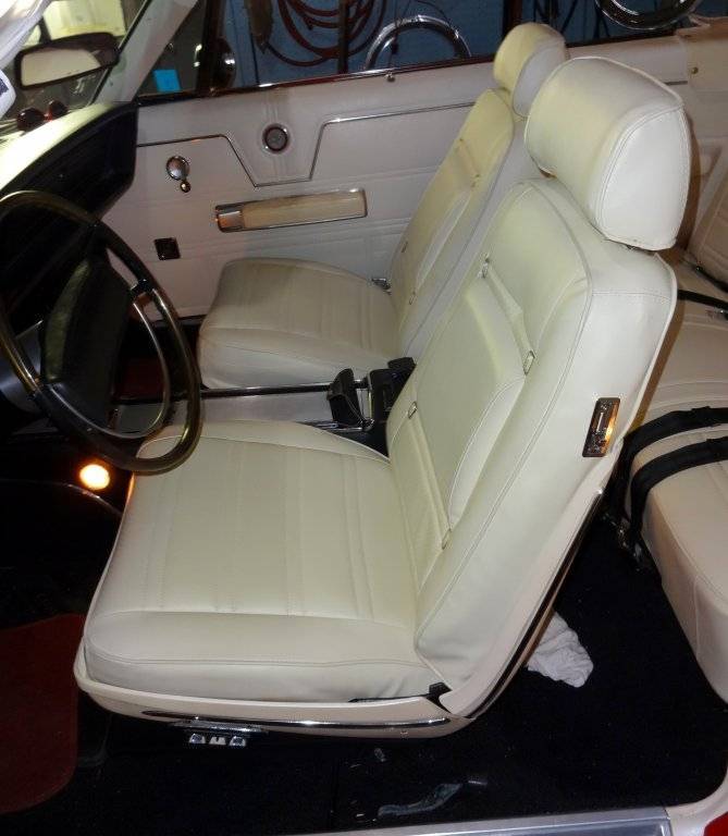

You can remedy that by placing a soft towel over the area before draping the cover over it.
I used Legendary for my 69 300 seat covers and top boot and was very pleased. The rear seat cover is not to difficult to install yourself, but I left the front covers to a pro trimmer. Be sure to use an automotive grade foam for the buns. We went a bit thicker on the front seats and it made a BIG difference in comfort.
