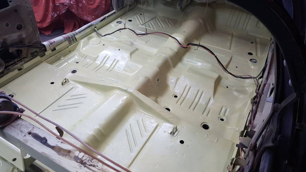

Me: Some primers absorb water and must be top coated. Is that true for your primer sealer, or can I use it as a topcoat? I painted a car floor with it and want to put the rug right on top, without topcoating, unless the primer will absorb water.
Duplicolor: The Primer Sealer will prevent it from absorbing water, so you can top coat it. It is not designed to be used as a stand alone product.
Me: Is that because of UV or moisture or something else? The particular application is a car floor, so it wouldn’t be exposed to UV.
Duplicolor: It is designed to be top coated. It will not hold up well as a top coat.
AFAIK primers are designed to perform 3 functions, form a tight bond to bare metal surfaces, have enough filler to fill minor surface imperfections and finally to provide an optimal surface to which a top coat will bond to. The ability to bond to a top coat means the surface must have some porosity, so without a top coat to seal it will allow it to absorb whatever chemicals it comes in contact with.
I don't know it if is an AFAIK primer. It is a lacquer-based primer-sealer. Just kidding.
I'm really glad I decided to paint. It is looking really nice after the first two coats.

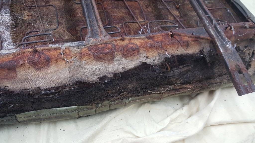

The under side of the seats are a real mess. I hate to put them back in on top of the shiny new floor and carpet.
Luckily they look bad because of moisture and not because of mice. I cut away all that ratty material hanging down from the frame in the picture.

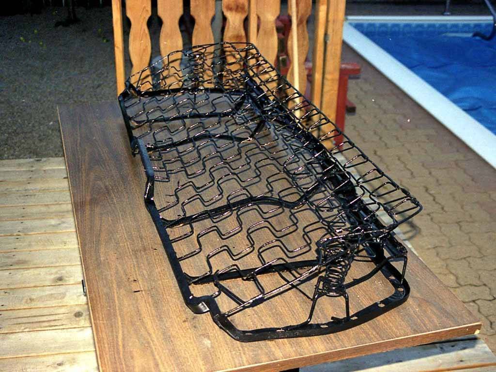

My rear seat looked near perfect on the top side, but the underside looked just ike yours. I carefully removed the hog rings and slid the spring assembly out then sandblasted all the rust. Then sprayed it with some water to let it flash rust as a prep for POR-15 rust converter and a coat of POR-15 black.
Then pulled the fabric and foam.
Took it all to my upholstery guy and he replaced the padding and reinstalled everything. Not too shabby for the factory vinyl.
That turned out great. I think I will take my seat to an upholstery shop and see if they think this is possible with mine. The front is decent, but certainly not perfect, and the vinyl seems brittle. It might be a project for next winter. I want to get this back together and drive it this summer.
