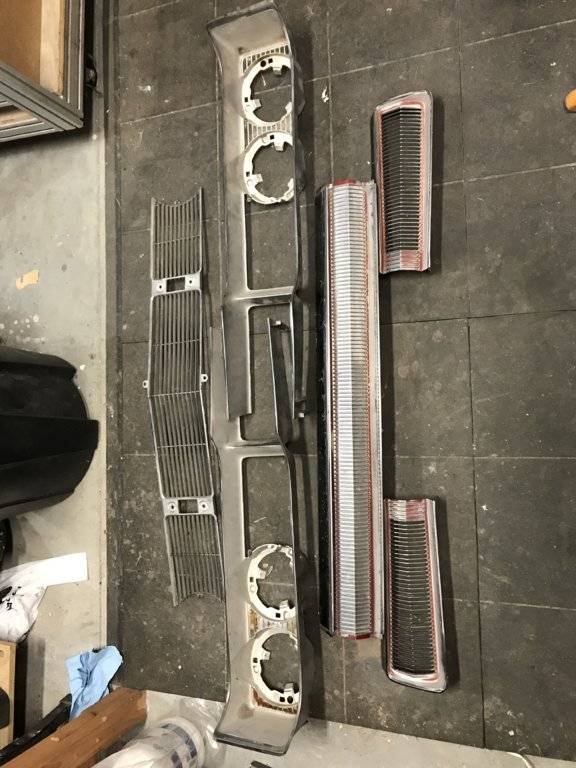

I am looking into re- chroming my grill, rear tail light filler and other parts. I am going to take a two and a half hour drive next week to to talk to a plating/ chroming place. I have no idea what to expect for pricing, what they can and cannot do. My expectation based on what I have researched so far is they will strip the old off, repair issues ( Up to a point)and re- start the plating process.
Depending on price there are a couple of pieces I could probably strip the paint and polish up. But there are others that are starting to pit. I am afraid they will not match if I clean up some and re plate others.

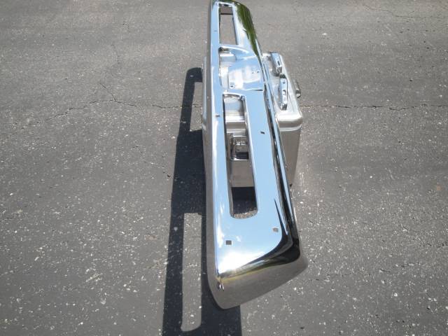

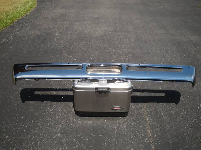

Wow, those are definitely ugly. That's the advantage of having a shop close by, You can walk in with the part and make sure there are no misunderstandings. If they did that to me, I'd be in there tearing someone a new one. My experience was without issue and quality was as expected.

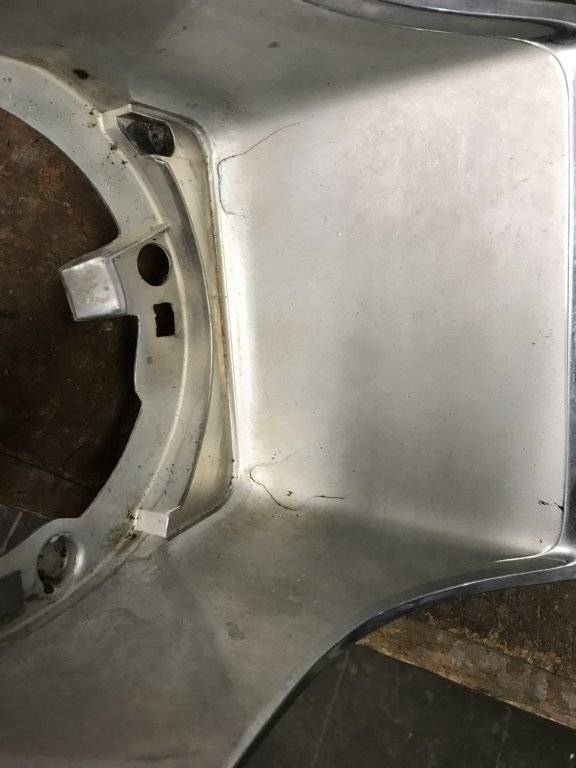

Some of the reasons above is why I plan on hand delivery next week. My tail light and filler panel bezels should not need repair nor should the grill. My front fascia for the headlights has a little stress cracking on the front side of the mounting studs. The good news on where the cracks are is covered with argent silver paint. I do have two sets to choose from, my originals have the best surfaces, but the largest cracks. My second set has more pitting but only a small crack.
