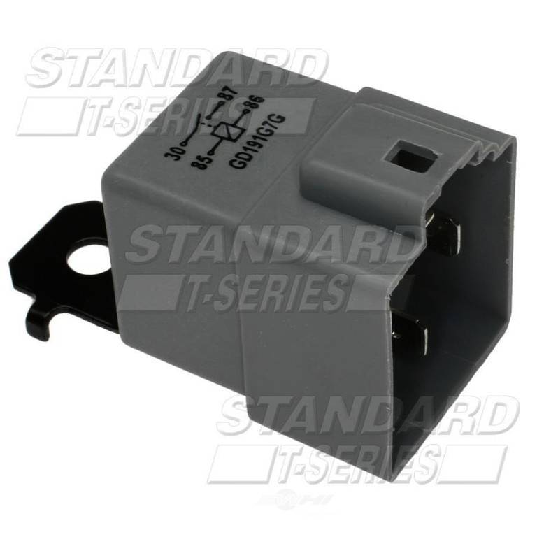

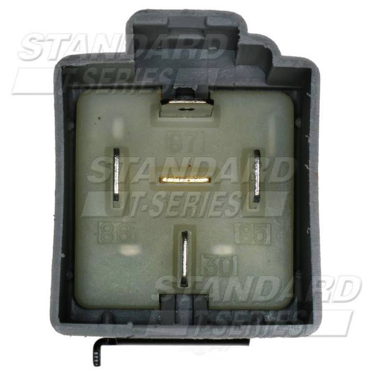

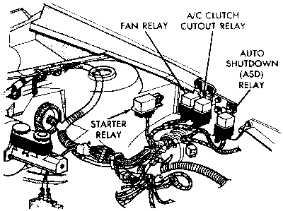

Another common issue is the Auto Shutdown Relay.or the PCM wiring relay.
The PCM operates the Auto Shutdown (ASD) relay and fuel pump relay through one ground path. The PCM operates the relays by switching the ground path on and off. Both relays turn on and off at the same time.
The ASD relay connects the battery voltage to the fuel injector and ignition coil. The fuel pump relay connects the battery voltage to the fuel pump and oxygen sensor heating element.
Part # RY108

The PCM turns the ground path off when the ignition switch is in the OFFposition. Both relays are off. When the ignition switch is in the ONor crank position, the PCM monitors the distributor pick-up signal. From the pick-up signal, the PCM determines engine speed and ignition timing (coil dwell). If the PCM does not receive a distributor signal when the ignition switch is in the RUNposition, it will de-energize both relays. When the relays are de-energized, battery voltage is not supplied to the fuel injector, ignition coil, fuel pump and oxygen sensor heating element.
The relays on her car are not the common square 4-5 pin you showed, other then one of them, they are the metal case units. I was considering rewiring them to all run the cheap and easy to find Bosch style relays. I had thought perhaps the ASD relay as well, but I had read that it controlled the fuel pump as well so when the fuel pump was still priming I assumed the relay was OK,
