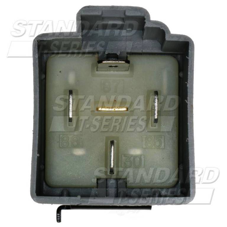

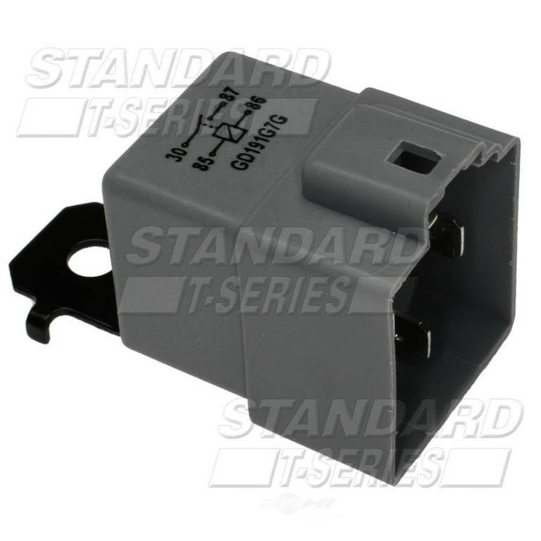

Another common issue is the Auto Shutdown Relay.or the PCM wiring relay.
The PCM operates the Auto Shutdown (ASD) relay and fuel pump relay through one ground path. The PCM operates the relays by switching the ground path on and off. Both relays turn on and off at the same time.
The ASD relay connects the battery voltage to the fuel injector and ignition coil. The fuel pump relay connects the battery voltage to the fuel pump and oxygen sensor heating element.
Part # RY108
