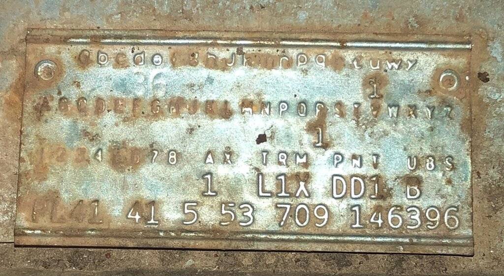

Yesterday and this morning, the MoPar decoder finally broke me.
I have tried to enter my fender tag information 20+ times and no joy.
could someone be kind enough to decode for me?
What year is it?
318, torqueflite auto, 8.25 x 14” ww tires, built VERY late 7/9/68, 2.76 open axle, trim-Low, Black cloth and vinyl bench, mist blue metallic, black upper door frames, am economy radio and it was a sold car/expedite.
Bare bones Fury!
Bare bones Fury!

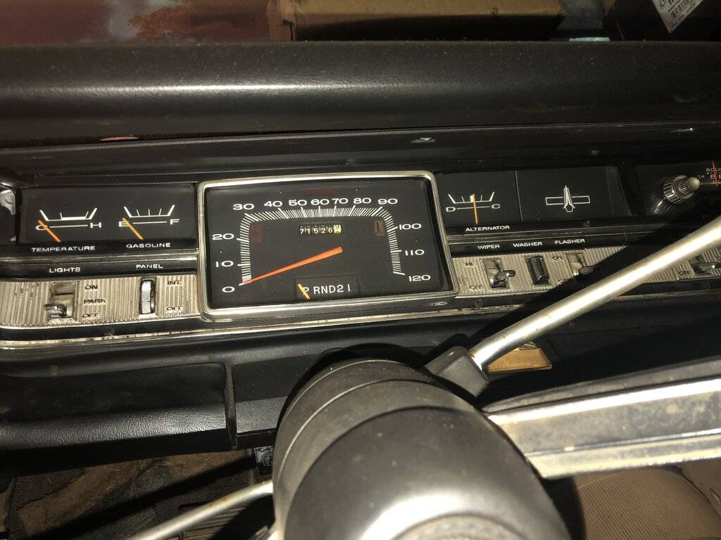

I wanna believe that it’s 71k miles.

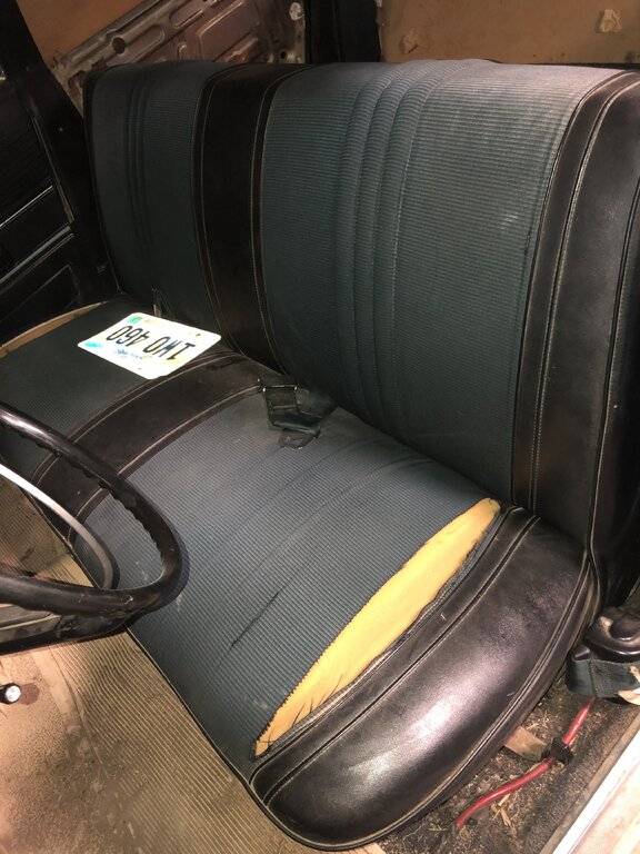

He has blue cloth seat coverings. I will also look for a build sheet.
Yep 727, your cloth probably started as black and has faded to that blueish tint.
