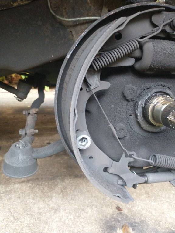

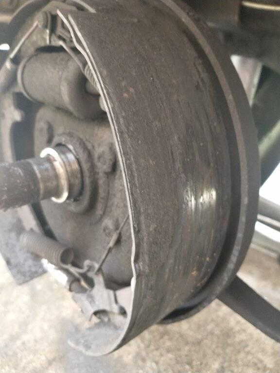

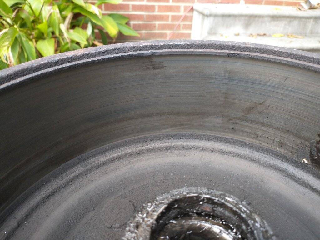

Okay guys, I pulled my front drums.
The drivers side has some grooves in it. The shoes are gone.
The passenger side looks pretty good.
I'm going to get some shoes, cylinders and spring kits for all 4 wheels and a dual tank master cylinder.
I pulled my booster and I'm going to send it to Booster Dewey today if I can get it out the door.
Look at these pics and let me know what you think about their condition.
Drivers front.
Passenger Front.
Drivers Drum.
Passenger Drum.
This car is nearly 60 years old. I recommend you inspect the brake lines for rust. You wouldn't want to do all this work and have a brake line related failure. I replaced the rear line with nickel/copper 3/16". It wasn't that expensive. You can bend it with your hand if you're careful. But a tubing bender is essential and low cost. Use your original line as a template. It doesn't need to be exact. The front lines are difficult with the body in place. All the parts are available from several places. The mounting clips, tube nuts, and spiral shield are available on Amazon.

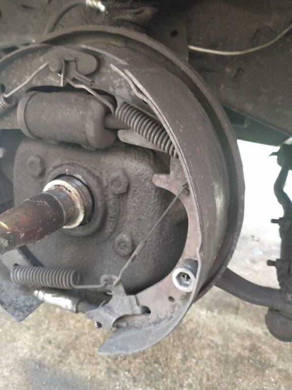

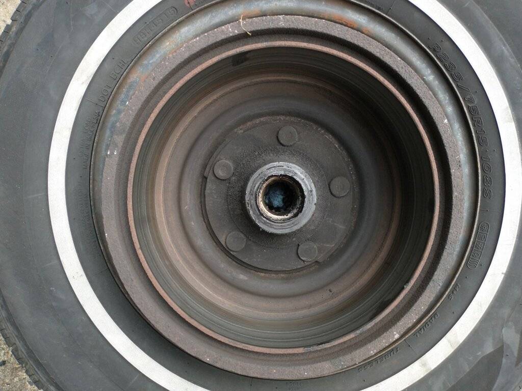

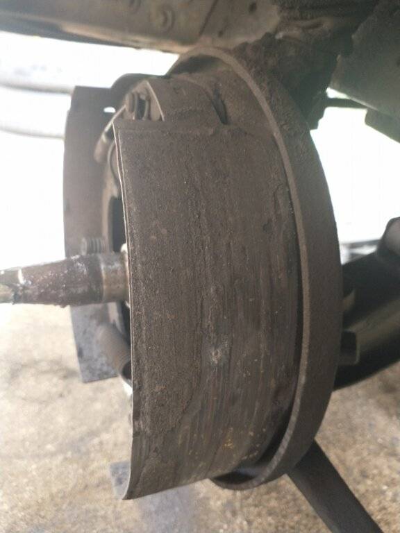

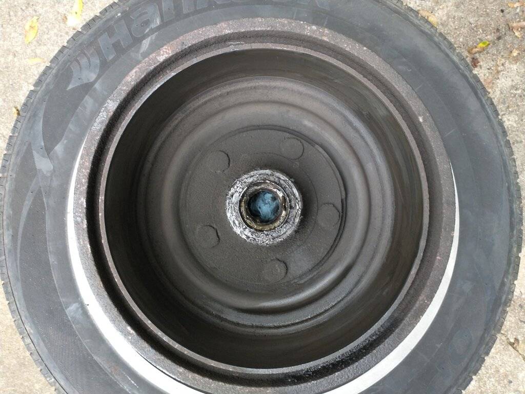

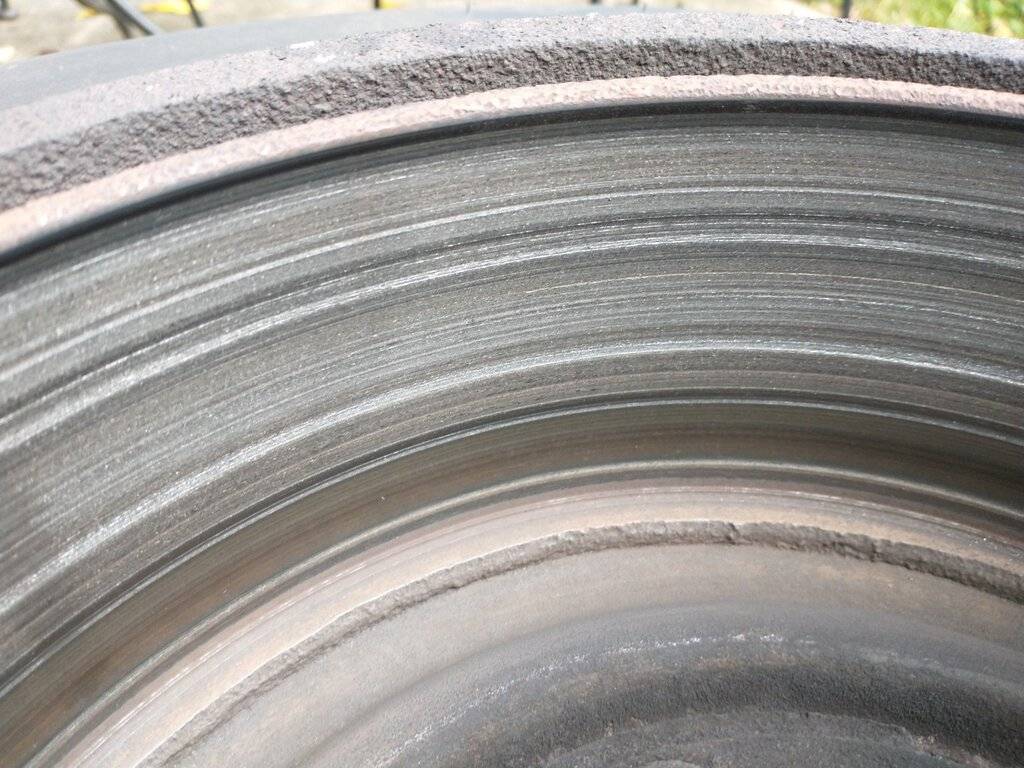

Drivers front.
Passenger Front.
Drivers Drum.
View attachment 489718 View attachment 489719
Passenger Drum.
View attachment 489720 View attachment 489721
Drivers drum needs to be turned. No discussion. Hopefully it will clean up and still be in spec. Years ago, I had friends that would turn drums for me and say "close enough" if they got a touch oversize, understanding the built in safety margins. In today's crazy world of litigation, I doubt if anyone would do that.
Hard to tell, but I'd probably turn the passenger drum too, with the request of a very light skim cut. In all reality, I've seen drums like that reused without problems.
