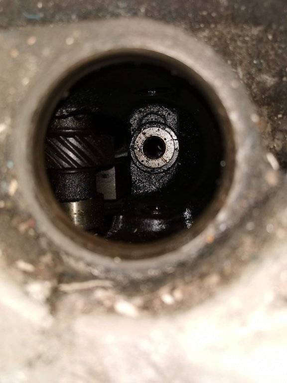

I recently installed the Distributor on my 1978 Cordoba but it spins freely by hand.
I guess it should connect with some drive gear of some sort down in the Bloch with the Shaft but i think it does not.
I not sure if the Distributor i got is the right one i just found it in the Trunk of the Car. (Pictures of it will follow)
Maybe a Bushing where the Shaft engages is missing i dont know.
How can i tell if its the right distributor?
Has anybode got pictures of the drive gear and Bushings in the Engine?

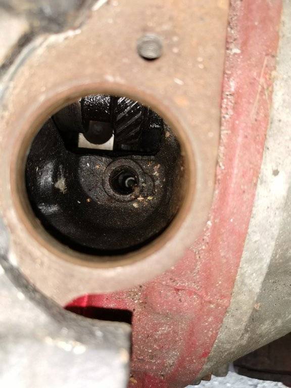

The drive gear is missing. Im running the 360cui. I guess also the bushing is missing.
It looks to me like the bushing is missing too.

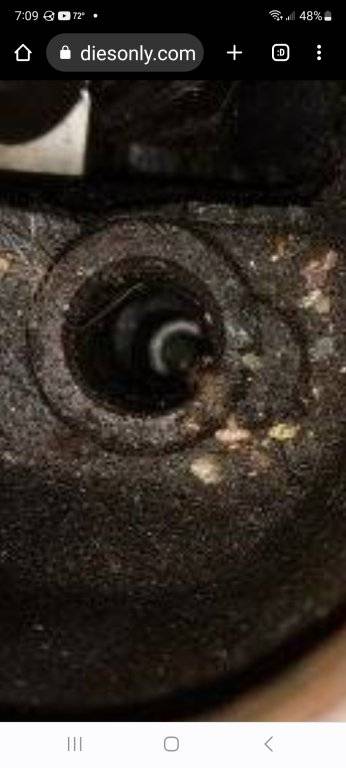

I don't like the looks of it but it looks to me like there is a bushing in there. Get a drive gear and put it in and see. As dirty as it is down there it looks like has been run a long time. Just remember, a newbushing needs reamed to size. It takes a special installer/burnishing tool.
I dunno... It's hard to tell. I blew up the pic pretty big and I'm not sure.
I have to say it would be very funny if the bushing was missing. I've seen them really scored up and worn, but unless it was pulled out deliberately, I can't see how it would just be gone.
Then again, why is the drive gear missing?
