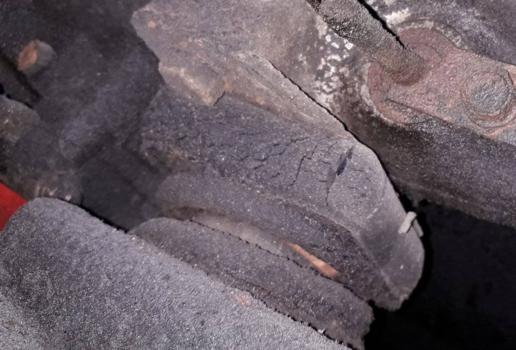

Hi! My name is Jimmy and im from sweden, i have a Chrysler 300 -64 and im going to change my -64 pushbutton 727 to a newer -66 and up 727 streetfighter. I wonder if someone havd done this swap? The early 727 have 4" between the boltholes to transmission mount and -66 and up have 2 3/4" so it is a bit different. My existing mount is a floating power style with a feather between the rubber and the crossmember. There must be some solution for this, some conversion mount or adapter or something? I have talk to Steve at Imperial service and he say he should see what he can do but i have not hear from him in a mounth now so i think i have to think something out myself. Do anyone here now what i can do or buy something for it. // Jimmy

Thanks for the answer! Im going to change to a newer trans -66 and up, i have order a TCI streetfighter 727, the difference between the early trans and newer is the bolt holes for the transmission mount, it is at the same location but on a before -66 trans it is 4" between the 2 boltholes in the trans for the mount and on a -66 and up it is 2 3/4" between them and thatswhy i can not use the my old mount, but a easy solution would be a adapter plate to bolt on the trans or something like that but i can not find any so maybe i have to try make my own or if some one have a better idea. There must be one more than me out there that have change to a newer transmission in cars like this.
