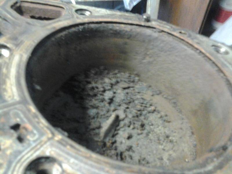

Sitting in a dirt floor shed for 33 years was more than even this old 361 could handle. #7 cylinder obviously was sitting with open exhaust valve allowing moisture penetration. The cure? '66 383 4 bbl should fit nicely in "Grace", the '62 Newport. Newport 040.jpgNewport 042.jpg

Looks like a complete rebuild is in order.Try cleaning up the cylinders first and see how things look. It will probably have to be over-bored,but that goes without saying.Hopefully it didn't eat into the cylinder walls necessitating the need for resleeving the cylinder.
I've already sourced a low mileage 383 4 bbl out of a 66 Chrysler. Since the '62 is not a high-dollar collector car I've opted to do the swap and junk the 361.

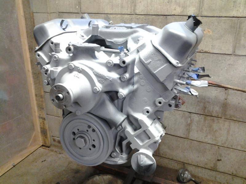

1-25-15: S-L-O-W progress is better than no progress: Work on "Grace" progresses as time permits. The '66 383 4 bbl sits with all new gaskets, water pump,etc. awaiting paint. Had a "suprise" of finding 3 stuck intake valves .."RoseAnna, RoseAnna Danna...It's always something"!

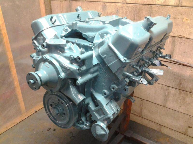

The 383 with it's new coat of "Chrysler Green" engine paint ( Dupli-Color # de-1619 ). Color appears very light in the picture but actually matches original color quite well.0130152029a.jpg
