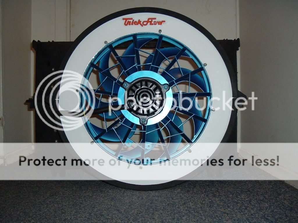

Nice that this just came up. I have an adjustable derale switch and a 16" proform fan. I just got home after the car overheated because the fan stopped working. The thermometer klicked to turn it on and i measured 12v on the wire to the fan but it just would not spin. I am rippi g that crap back out and am gonna get a mechanical fan.

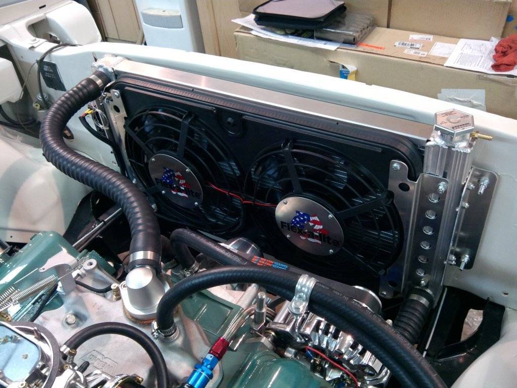

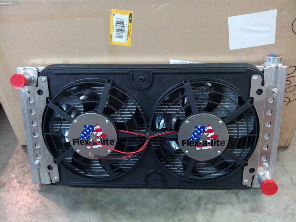

This system works flawlessly.
