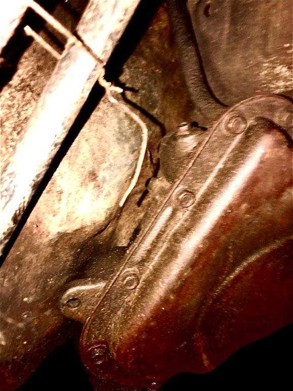

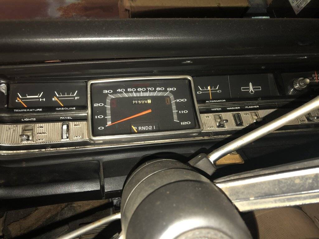

I believe that I have a 904 transmission in Elwood, based on the picture attached, which is in conflict with the fender tag decode that @detmatt did for me. (I tried and tried to use several decoders, and all they did was frustrate me. The damn spaces that I had to put in the decoder website is a bunch of CRAP!). I believe that the picture is all I need for validation.
If I am wrong, I will learn that the next time I work on Elwood (in about a month), when I look at the pan and search for a stamp Or casting characters on it.
It’s probably a 904 unless it was a fleet type vehicle.

1968 was the first year the 904 was put behind a C body 318.
727 was optional with towing package and as mentioned fleet services
My 68 VIP had the 318/904 combo
Our 318 69 Fury III was ordered with the 727.

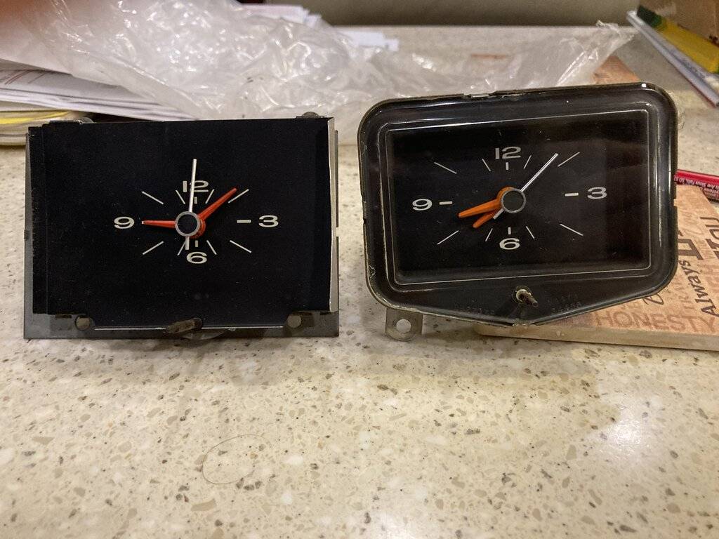

Today, I finally received the clocks that I ordered from Smith’s Classic Clocks back in March.
They are for Elwood (68 Fury II 4 door sedan) and Shamu (69 Fury III vert).
I will bench test them prior to installation.
An AM/FM radio also will go in Elwood (after I have it modified to add Bluetooth).
Checked out both clocks today and they work. I had to adjust the set gear (the one on the end of the adjustment shaft) on the 68 clock as it had slipped a bit.

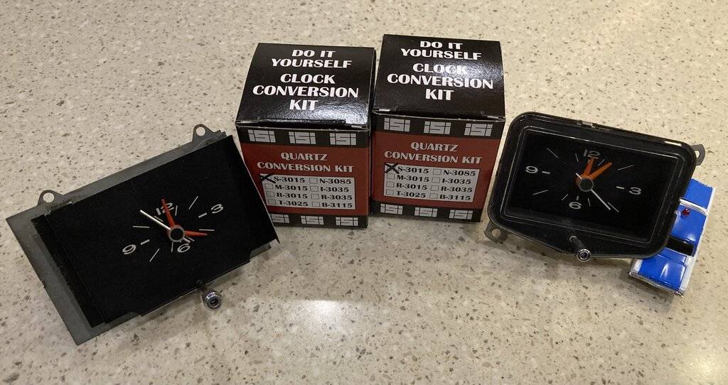

Going to start on converting the clock (and do the clock on Shamu’s 69 Fury III vert too).
I bought the clocks (68 on the left, 69 on the right), knobs and the quartz conversion kits. According to Instrument Services, Inc., both clocks need the same kit.
I will post progress on both of them as I progress, here.

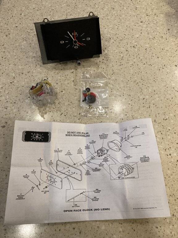

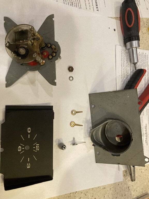

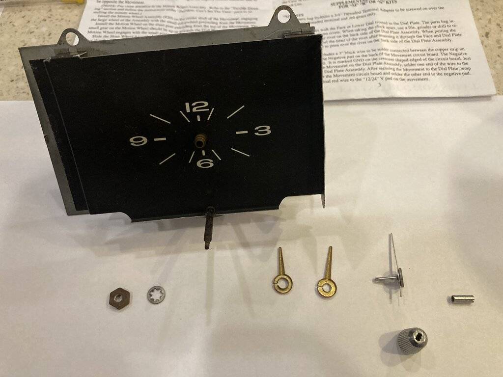

Got the kit installed in the clock housing.
Works with clip leads on the post (+) and the ground strap (-).
It appears that I need to scuff / burnish the inside of the case, but that will be after I sleep...
