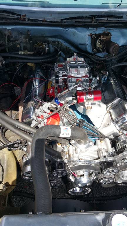

    I’m not saying this is your issue but recently I inadvertently put ethanol fuel in my Newport.
    I did drain the system and filled with non ethanol fuel.
    What I found out is the rubber fuel line areas that I had recently replaced were not the new type ethanol fuel resistant rubber hose.
    So as soon as the ethanol fuel touched it it deteriorated fast.
    May or may not be your issue...

    Can't see the 6AL box on the right side fender.....
