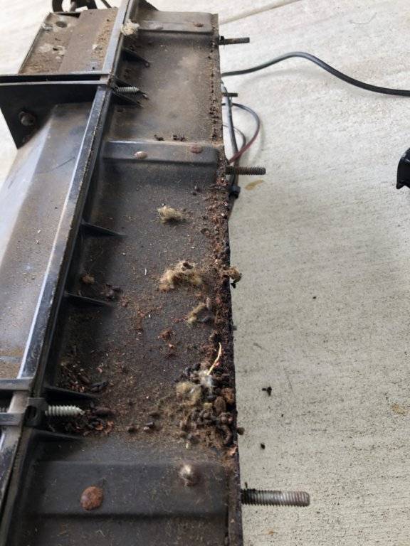

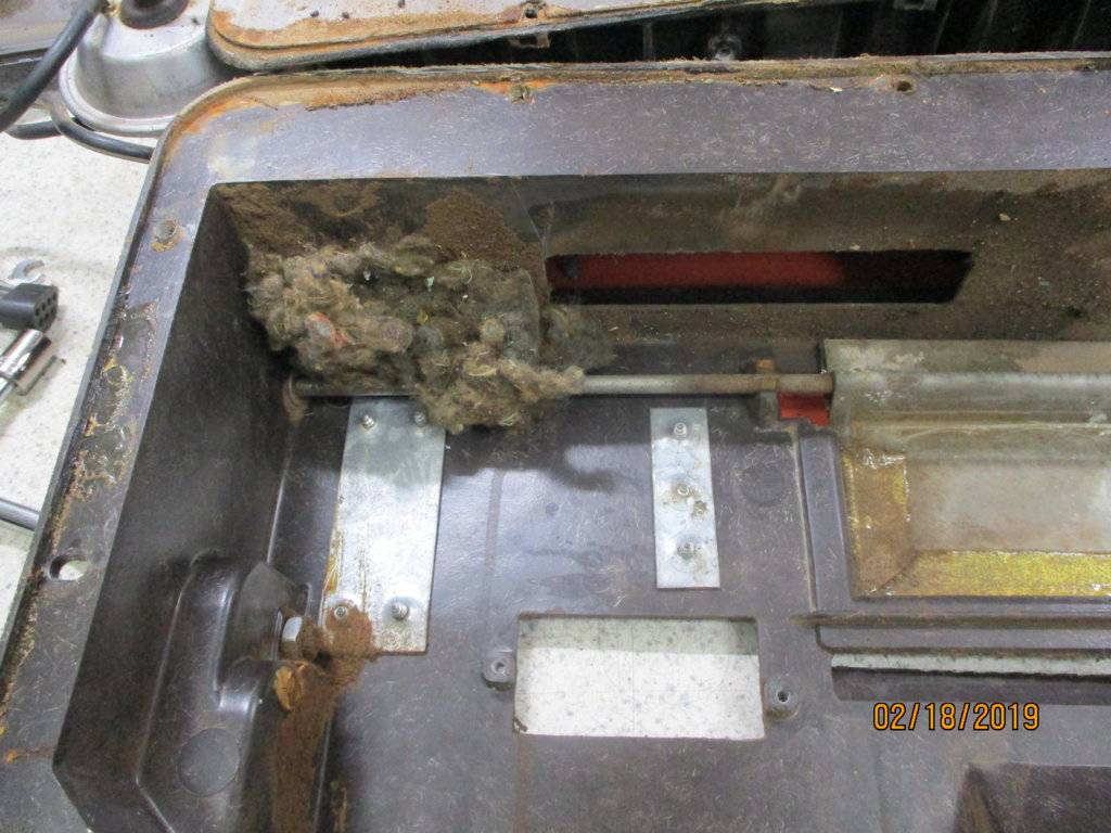

And to think I have this job ahead of me. Oh so much fun. lol
What's not to like about this? Mice are cute!
