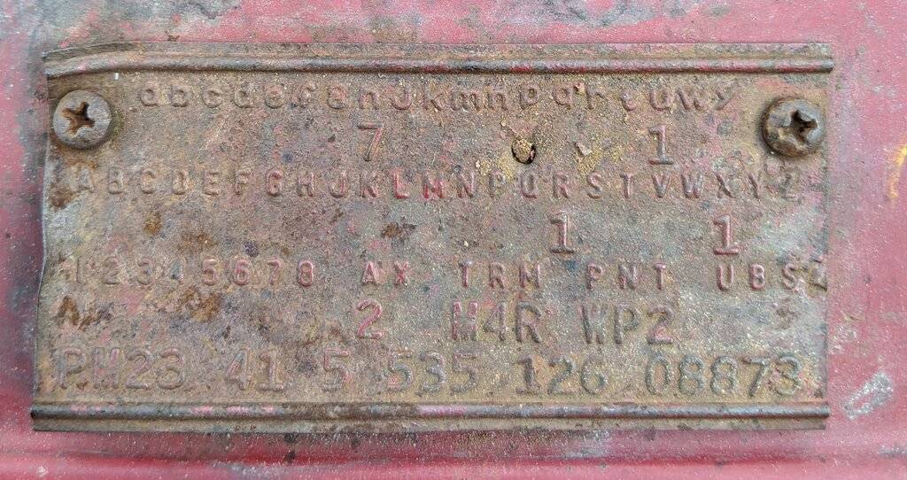

I figured I'll play the game. Found a picture of my tag from before I cleaned the engine bay!
1967 Plymouth Fury III
Does This look correct?
CAR: Unknown Make and Model.
ENGINE: 318cid 2-bbl V8
TRANSMISSION: 3-Speed Automatic
TIRES: Unknown tire code
BUILD DATE: January 26.
AXLE: 2.94 Rear Axle Ratio
INTERIOR: , Vinyl Split Bench Seats. Red Interior.
PAINT: Two Tone Paint, White Upper Body Color and Red Lower Body Color.
OTHER:
MOLDINGS:
ABC OPTIONS:
R1: AM Radio
X1: Tinted Glass (all)
abc OPTIONS:
h7: Fender or Hood Mounted Turn Signal Indicators
u1: Sold Car When Built (Somebody Ordered It)
I do know it was originally two tone.
I don't see how it has tinted glass though.
My 67 has a sticker on the back passenger side quarter Glass that says tinted windows.
Here are the results of the decoder I use-
CAR: Plymouth Fury III 2 Door Hardtop
TIRES: 8.25 x 14 white Wall 2-4 Ply Steel Belt
MODEL YEAR: 1967
BUILD DATE: February 6.
INTERIOR:
PAINT:
OTHER: White (Dodge, Plymouth), Persian White (Chrysler, Imperial) Upper Door Frame Color. Bright Red (Dodge, Plymouth), Scorch Red (Chrysler), Flame (Imperial) Racing Stripe.
MOLDINGS:
ABC OPTIONS:
R1: AM Radio
abc OPTIONS:
btw, I got two different results on the build date and the paint color depending on where I placed it them in the decoder, as shown below-
MODEL YEAR: 1967
INTERIOR:
PAINT:
OTHER: Bright Red (Dodge, Plymouth), Scorch Red (Chrysler), Flame (Imperial) Upper Door Frame Color. Gold Metallic (Dodge, Plymouth), Spice Gold Metallic (Chrysler), Cinnamon Gold Metallic (Imperial) Racing Stripe.
MOLDINGS:
ABC OPTIONS:
R1: AM Radio
abc OPTIONS:
MODEL YEAR: 1967
INTERIOR:
PAINT:
MOLDINGS:
ABC OPTIONS:
R1: AM Radio
abc OPTIONS:
MODEL YEAR: 1967
INTERIOR:
PAINT:
MOLDINGS:
ABC OPTIONS:
R1: AM Radio
abc OPTIONS:
For the build date you are correct in the 2nd decode, it was built on January 26. Regarding the paint I am not to sure about that one
