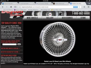

I ordered these this morning. 18X8 with 4.75 backspacing. They take 6 to 7 weeks to build.
I like those a lot but they look like they'll take forever to detail when needed.
Thanks, I love them & can't wait.
They make a supposed spray on/rinse off cleaner. We'll see....
From what i have found most Imperials are 5x5" bolt partern, which is the same as chevy fullsize trucks ( before they went to 6 lug) and most new jeeps. I'm running 18"x8.5"s and 20"x8.5"s on my 68. They clear.
Do you have a better picture of the rims you're using? It looks like there is a cap that goes over the lug nuts. I'd love to see the rims your using and where you bought them.
