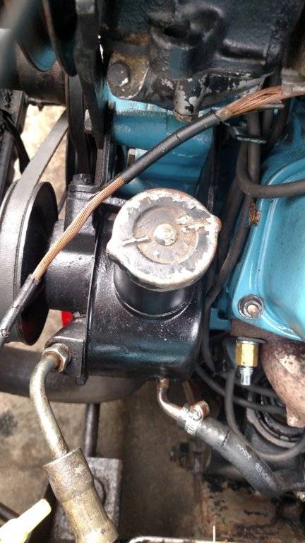

For those that noticed the missing power steering cap, I got a new one. Previous owner had aluminum foil and and pony tail holder around it.
So, a big thanks to Murray Park for having one to sell me!

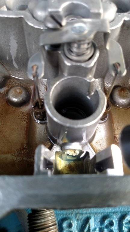

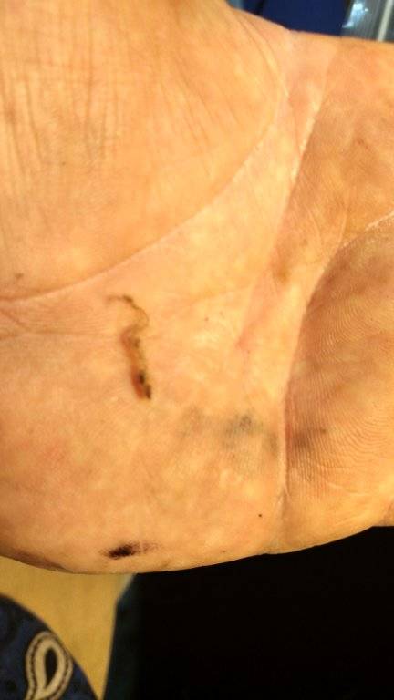

Clay like substance in carburetor. This is a fresh reman!
Second pic is after disassembly of carburetor. That is some kind of thread that was attached to the check ball under Venturi assembly (I think that is the proper name).
Sunday, I double checked timing with the friend who helped me with engine swap. The car would only run with idle too high. It would stall coming to a stop, so I am cleaning the carburetor.
Well, carb is a lot better. I can't get 600 idle like FSM says. I'm at 800, but it purrs now. No stalling in gear. Haven't drove it yet.
