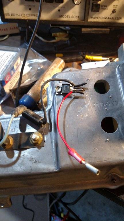

Replacing 5v regulator with 7805 while I have instrument cluster out. May pull the clock and see how bad it is.

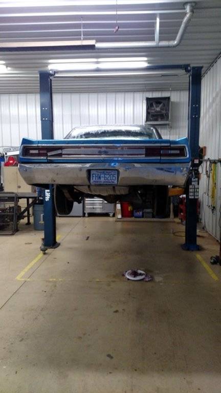

I pulled sending unit (new) because it wasn't indicating properly. It's tough under the car and I didn't get the seal lined up. I found out when I filled the tank. Luckily, I got access to a lift.
Looking under the car, the parking brake cable is gone from the pedal. Also found a dozen or so dirt dauber nests. Think this car sat in a field for a while.
You don't need another cluster. The gauges can be replaced.
BTW both the fuel and temp gauges run off the 5 volt limiter hence the incorrect readings.
Get the limiter I posted,replace the gauges,bypass the ammeter.
