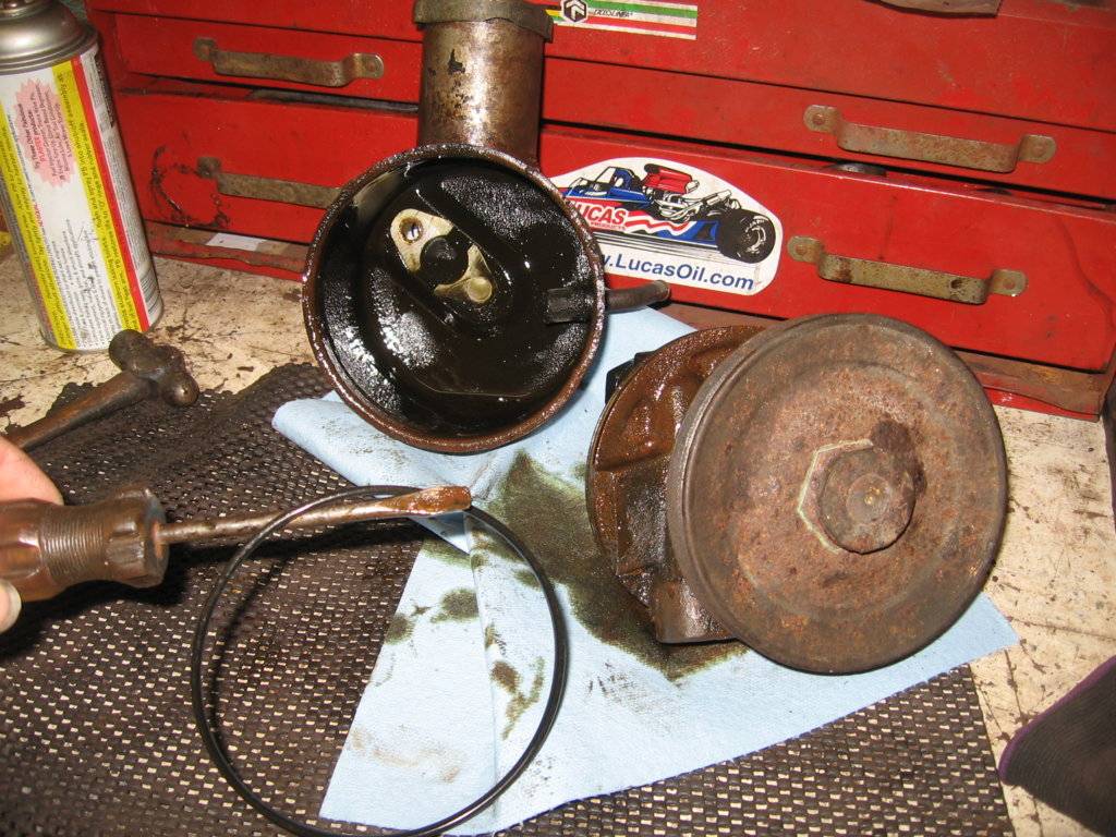

If you look at the parts book you will find there is an o-ring that seals the pump reservoir to the cast pump. I can’t quite remember how it comes apart. It has been a while since I rebuilt mine. The service manual made it pretty easy to rebuild.

I found it in my FSM. It does mention that reservoir solder joints can leak, but I am going to order the rebuild kit. $6 at Rock Auto versus $118 for a reman with reservoir. You are probably right about the oring. It's likely the original 50 year old pump.
You will need a pulley puller. If you don’t have one most parts stores will loan/ rent you one. I liked the one I got from O’Rielys so much that I kept it. I think I am now up to about 5 or 6 different pullers. I think I have one duplicate as I forgot I had it.
All the p.s. pumps I had (Federal,TRW or Saginaw) all leaked from big o ring between reservoir and body of pump.
Rarely had one leak from the shaft unless it had super high mileage on it.
Removing the pulley is a ***** and not often necessary.

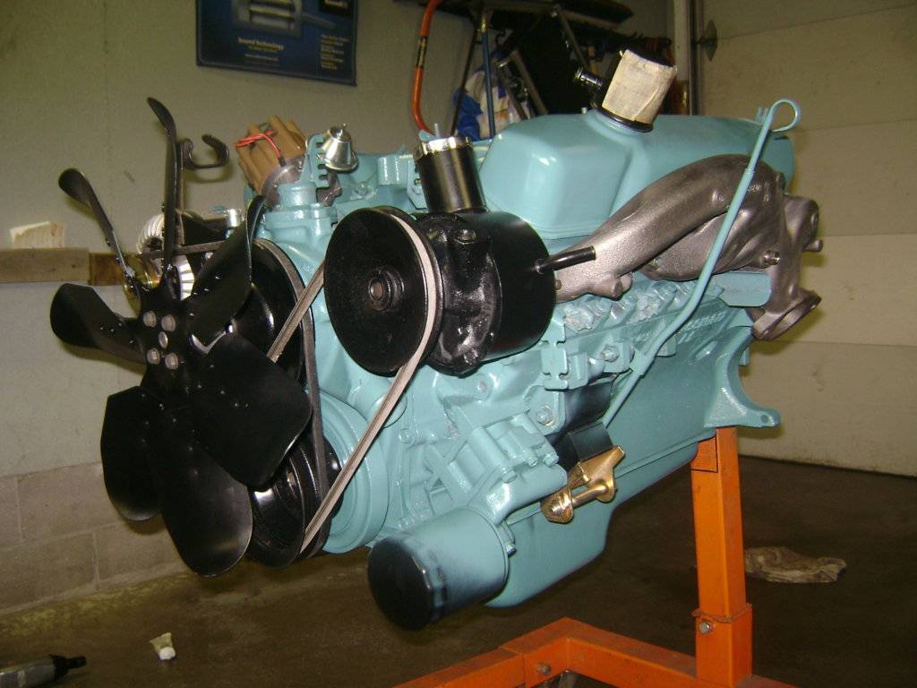

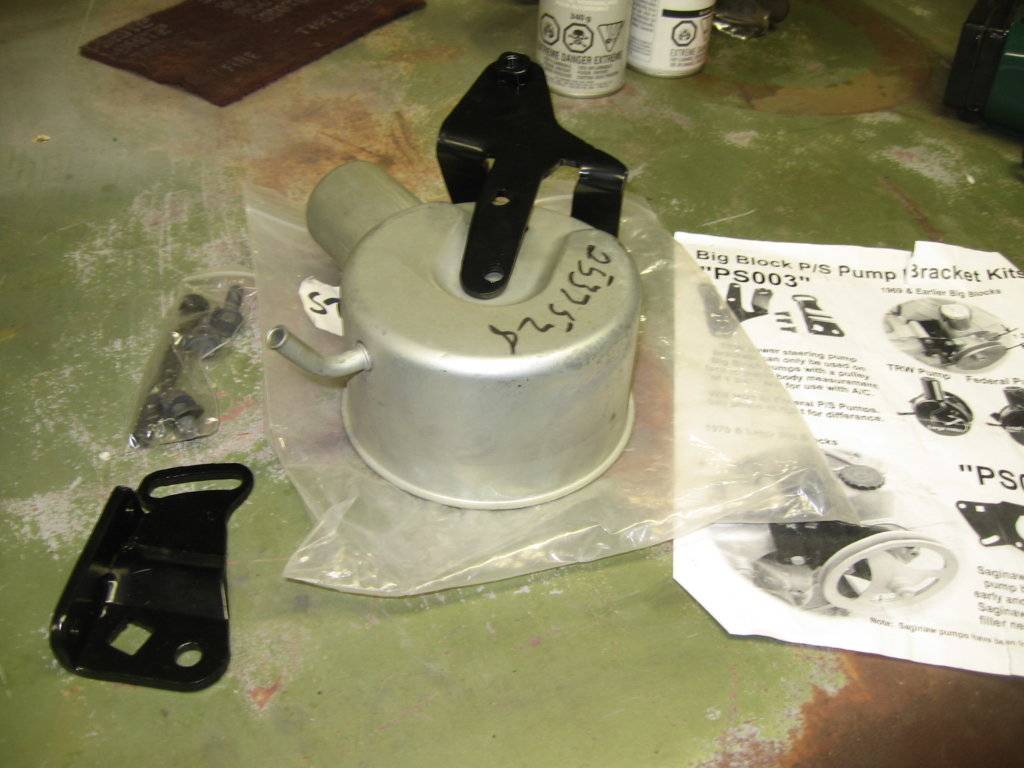

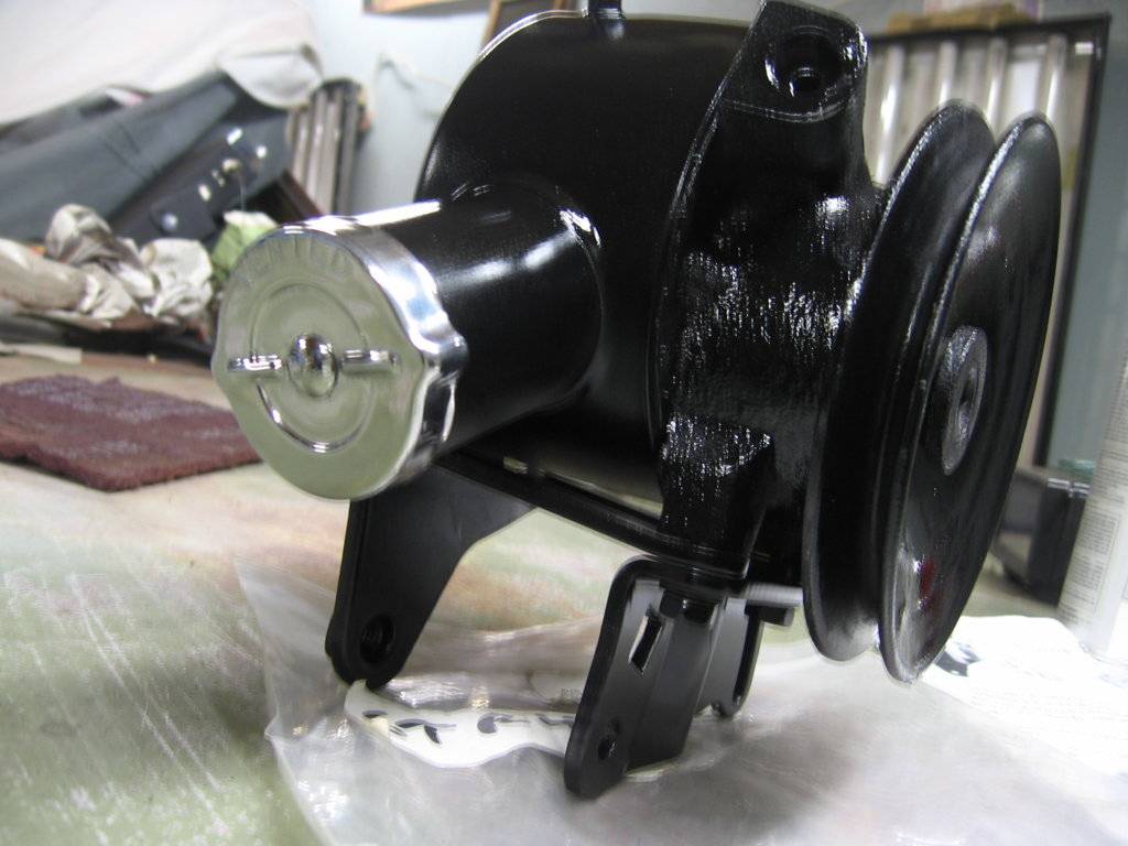

Since you will be removing the pump from the engine now is the time to upgrade to the solid pump bracket. The slipper type bracket is terrible and flops around causing the belt to also flop around.
I will show details later.
Thank you. The belt is floppy. I will look for the bracket and look forward to your future details.

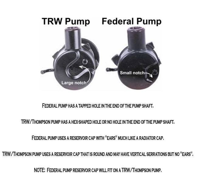

How do you know which pump is on the car?

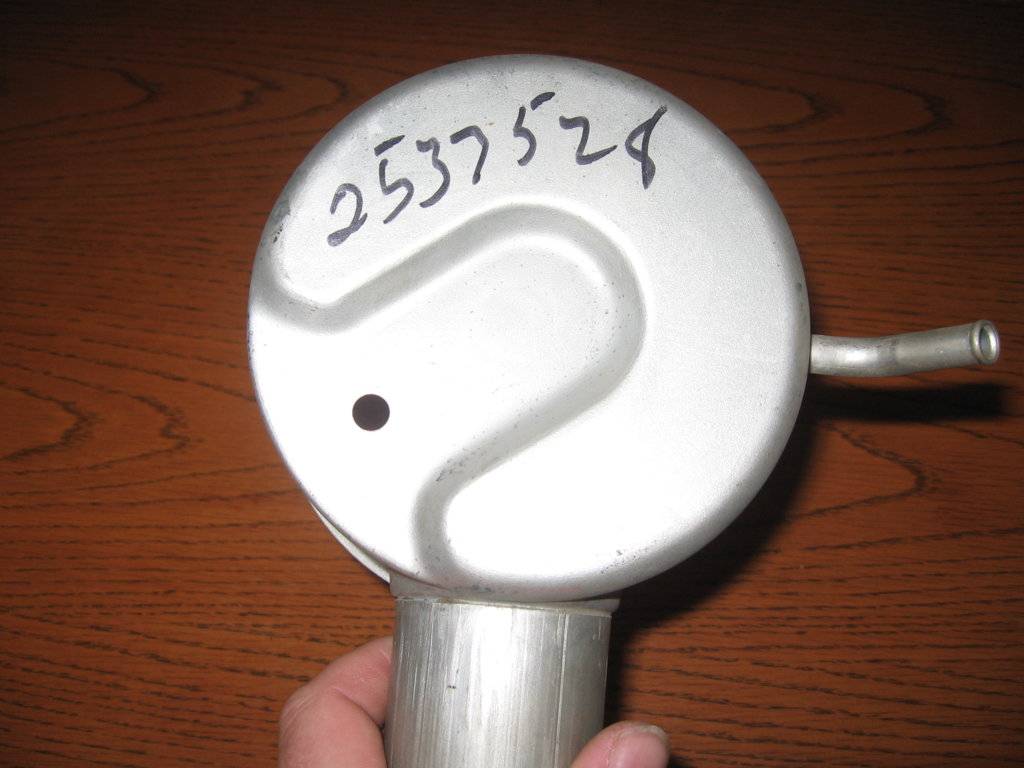

With a new o ring and reservoir can, I used "the Right Stuff" sealant.
No leaks as of yet..
I had that same bracket, and it didn't even fit on my trw pump, no matter how much i tried to get it to work
