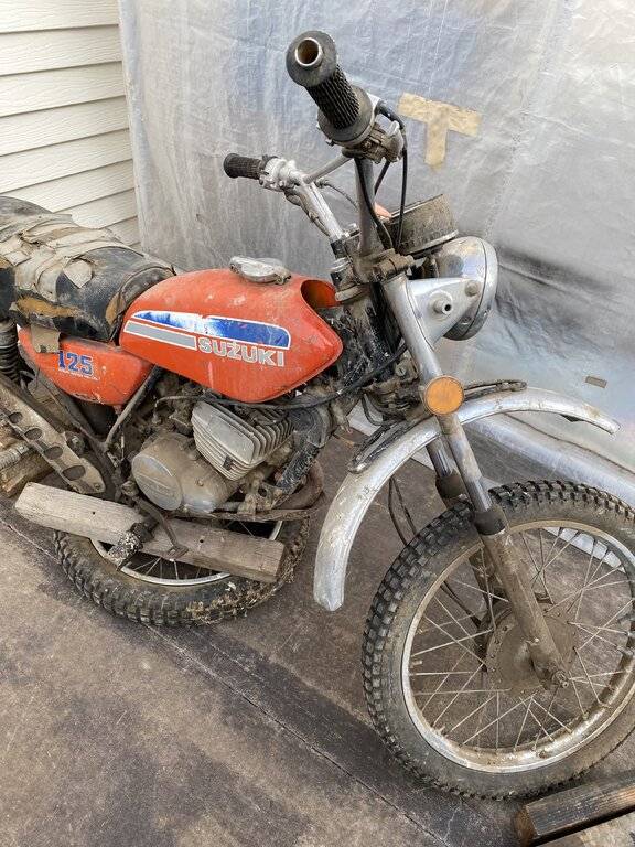

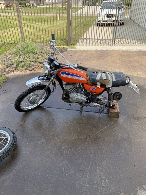

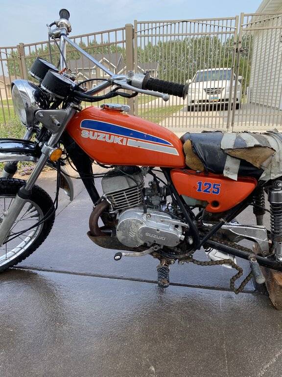

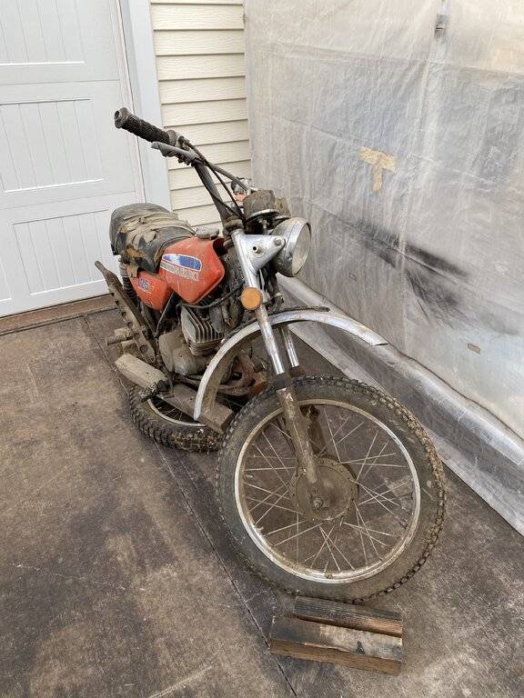

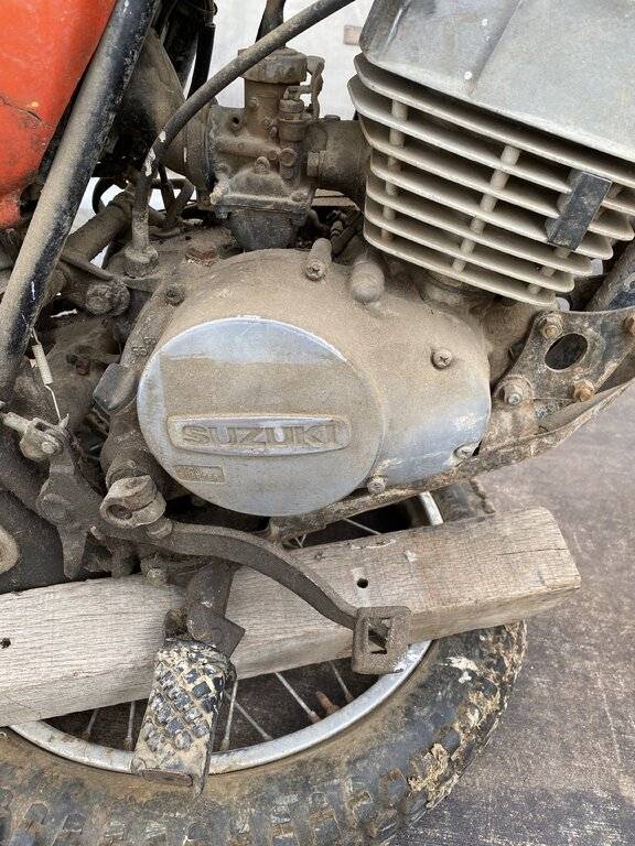

I went back to the homestead this weekend to help Mom clean out our old shop and brought my high school motorcycle back. It is a 1974 Suzuki TC125 Prospector. The TC model has a two speed gear box which gives it decent power in low range for hill climbing, but also ca get up to about 65 MpH for road travel. Not bad for 13 hp.
It ran when parked 35 years ago (kind of). Except the kick lever was broken off and the rear sprocket would pop off if you gave it too much gas. So far I have already spent $100 in parts, and haven’t bought the new rear hub or wheel I need. Another project that I will spend more than it’s worth. Not what level I will take it too yet. I will clean it up first, then start resealing the engine and transmission. We will see.
I have a parts manual coming and two service manuals. You have to get the TS125 manual for the engine and chassis and then get the TC125 man for the transmission and two speed related items.
Already bought a new seat cover, kickstand and rear wheel adjusters. Next is a rear hub/wheel, sprocket, chain, kick starter, engine and transmission seals, rear fender, tires…….. I will soon ha more than the $200 I spent on it in ‘84.

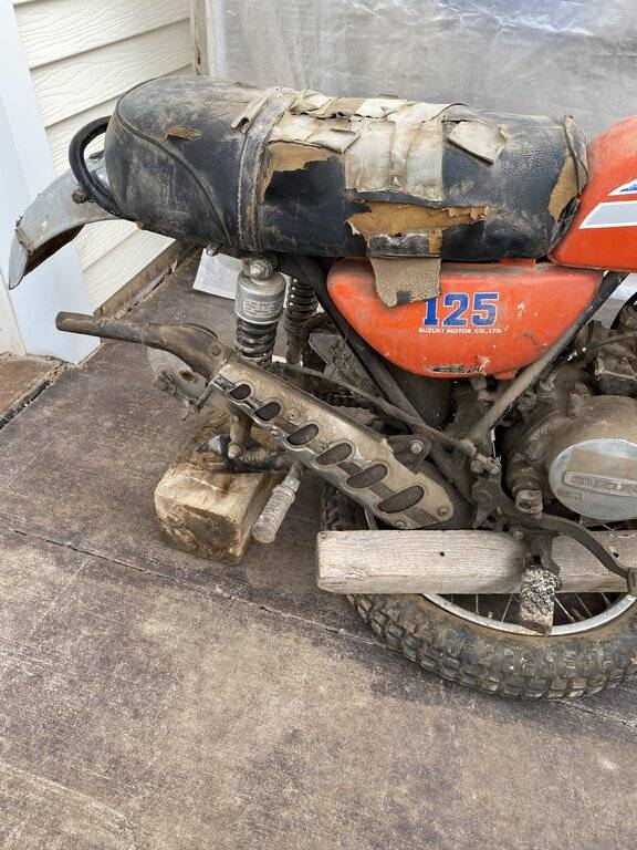

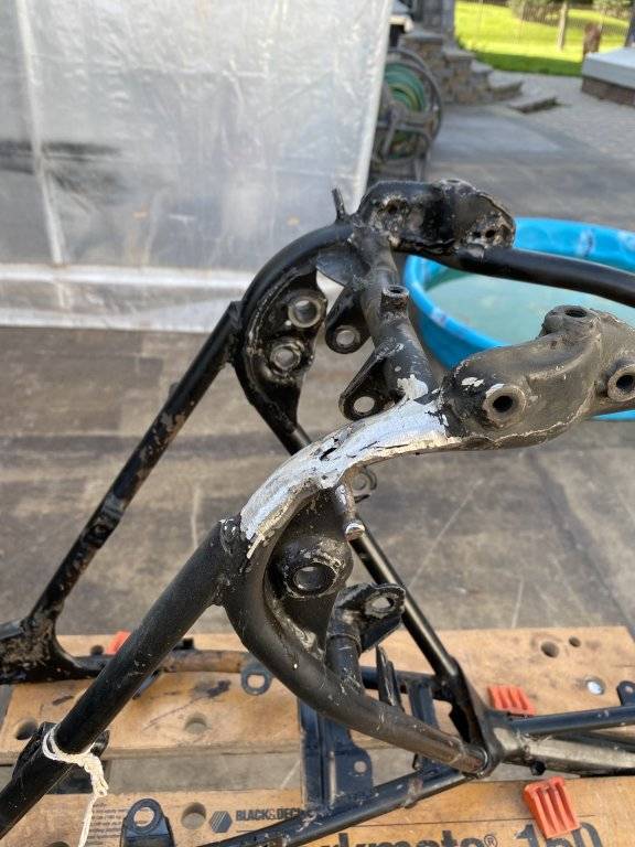

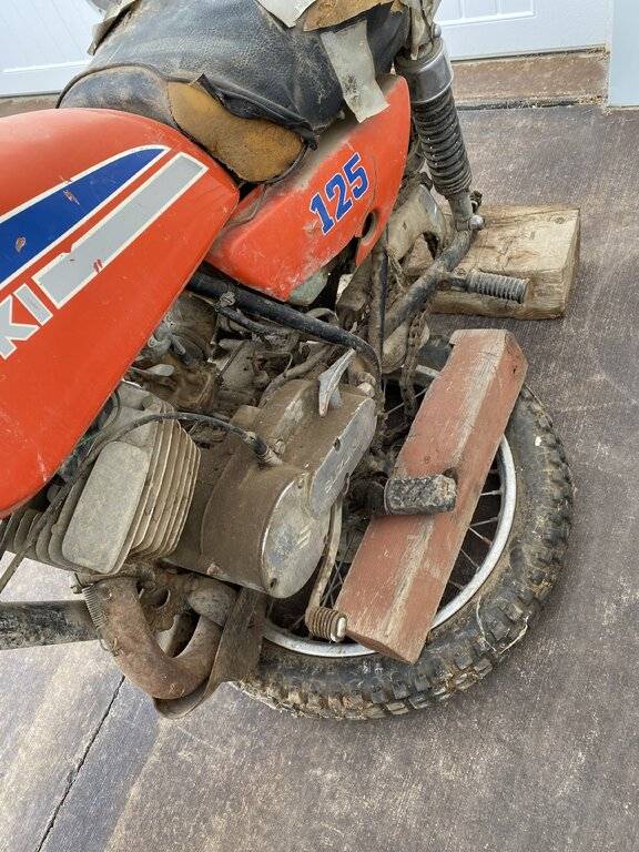

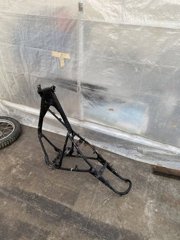

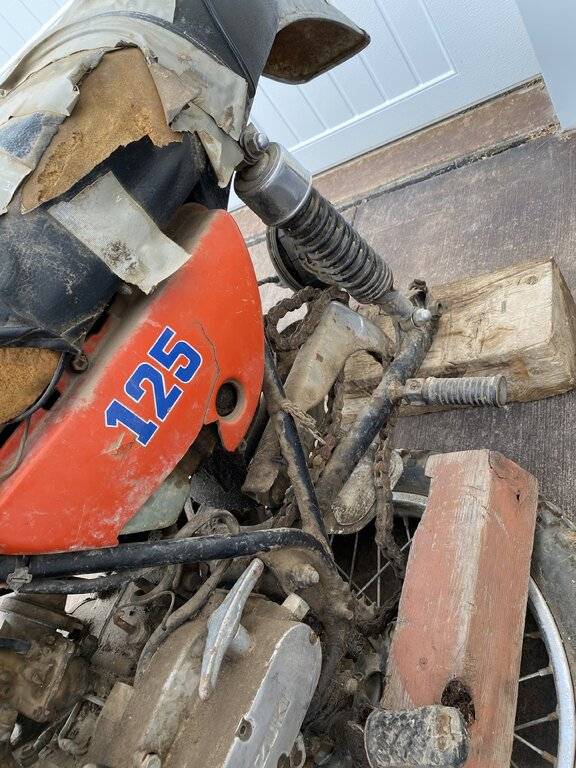

I washed it up this afternoon. I got most of the grease, dirt, and cow **** off of it. It looks like some frame repair is in the cards. I couldn’t be so lucky to find a parts bike or frame for cheap. I wish my dad was in better shape, He could weld anything with any kind of welder. It is about time for me to put my mig welder to good use.

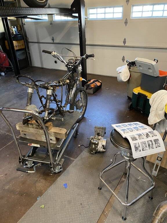

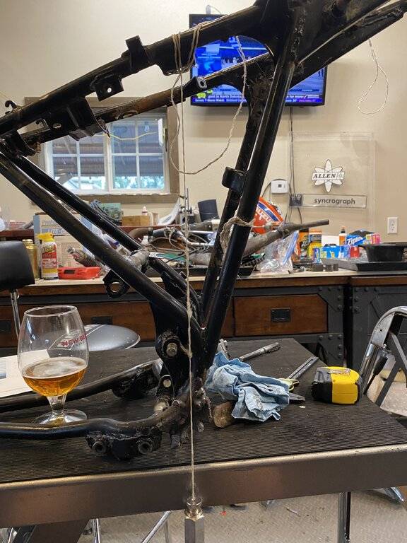

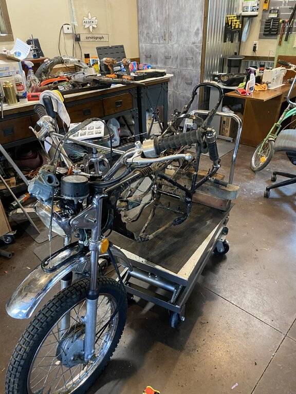

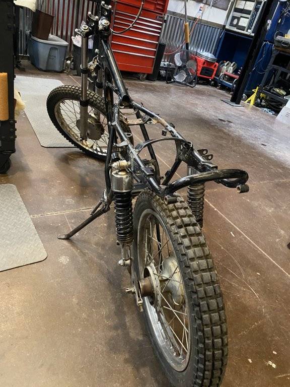

Time to strip the frame.

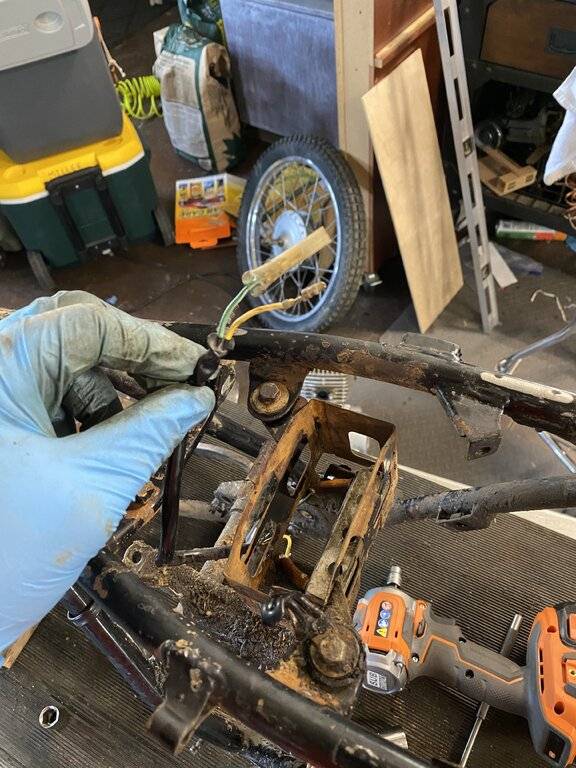

Pulled it in the garage today and started stripping it down and pulling the engine.
Next pull the wire harness, rear arm and front end. Then I can start with the frame repair.

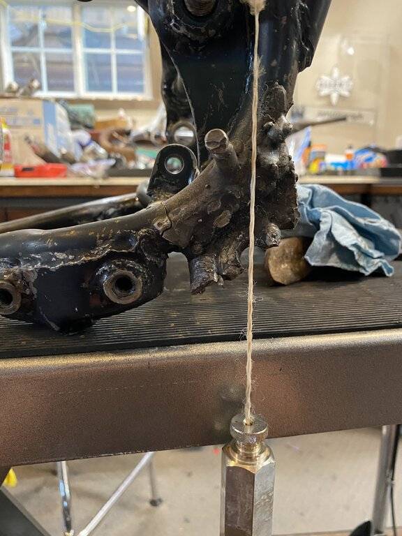

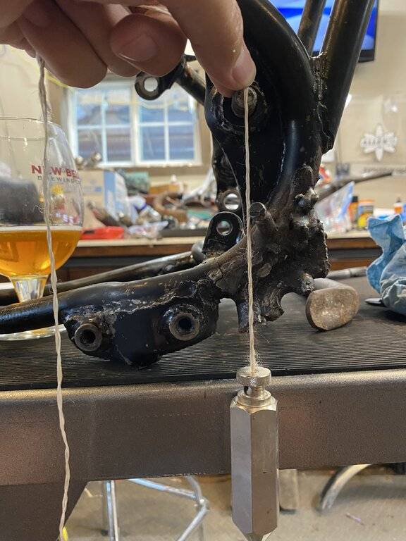

Did so “locating” on the frame to rebuild my kickstand mount. Also borrowed pictures off the internet.

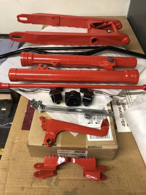

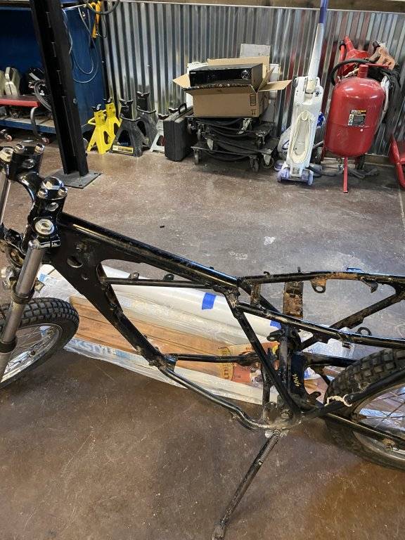

Been a couple of years since my last update on the Suzuki TC125 build. I have some catching up to do. Since July 2021 I haven’t made a lot of cosmetic changes, but have a good start on the core.

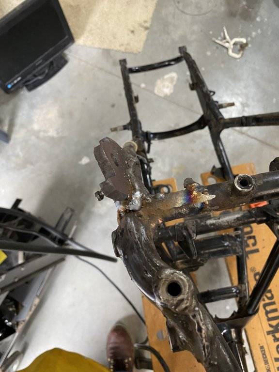

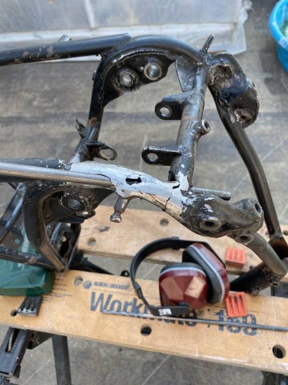

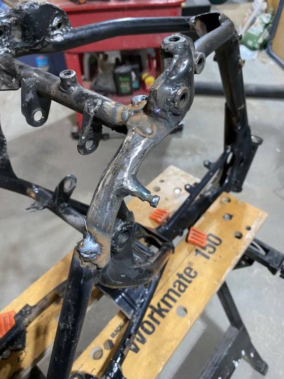

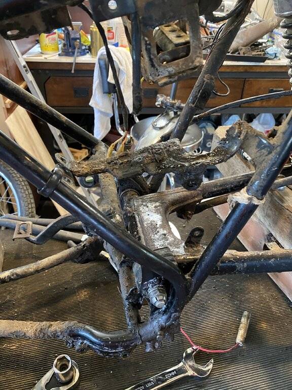

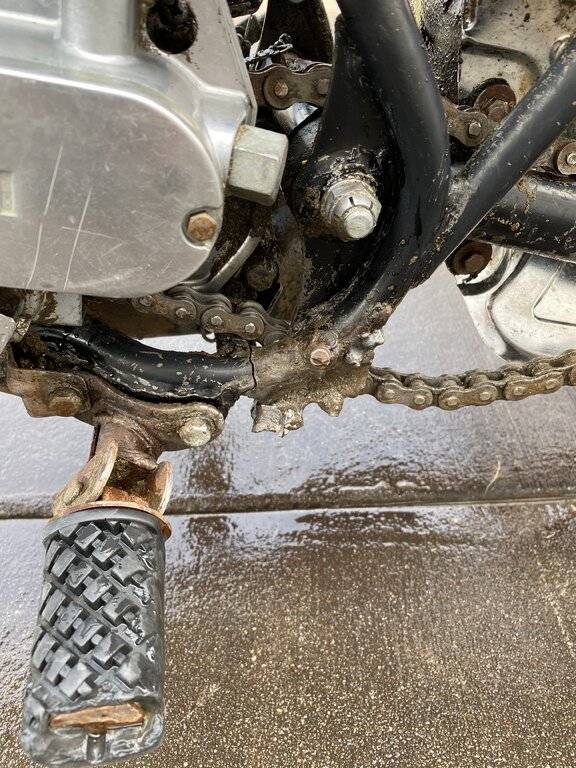

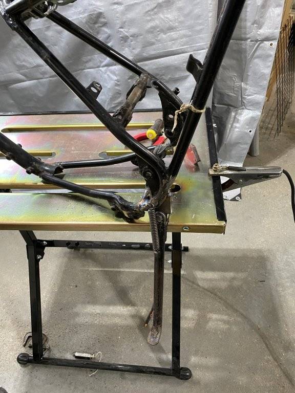

I had to brush up on my welding and fabrication skills to fix my broken/cracked frame. Where the break was around the foot pedals and rear frame, I ended up drilling through at an angle and welding in a splint rod to tie them back together.

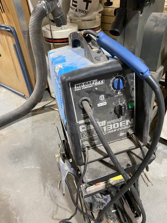

My skills are slowly improving. The tube doesn’t have much leeway between good penetration and blow through. I did add a gas bottle to my welder which helped.
Drilling for splint rod.
Rod through hole. Able to weld both ends and through the middle.
Kick stand plate will also bridge the area.

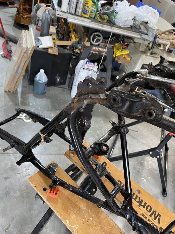

My welds don’t stand out to much more than the original.

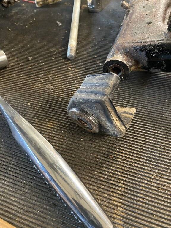

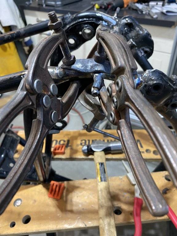

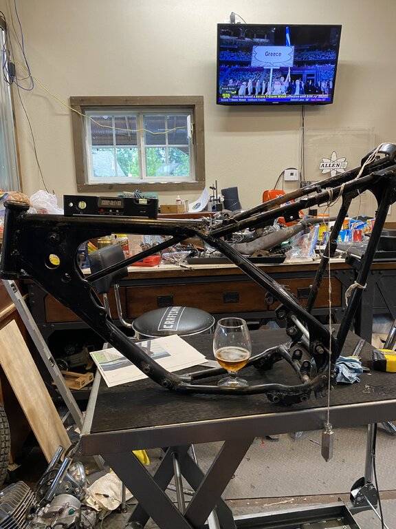

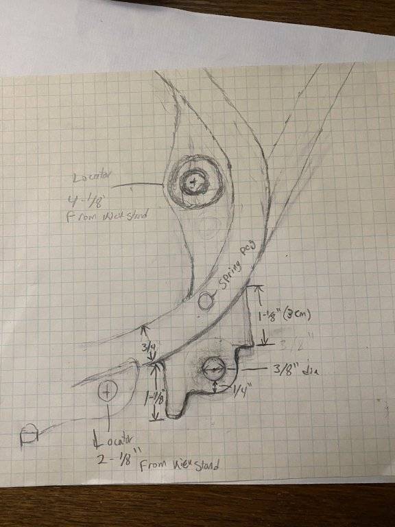

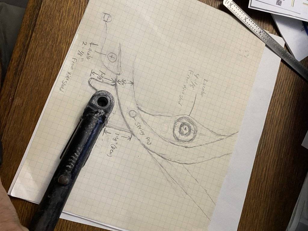

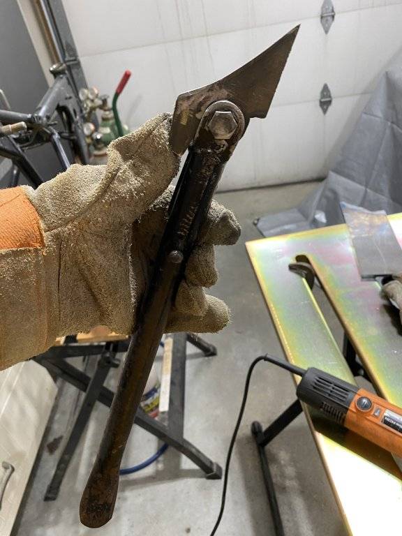

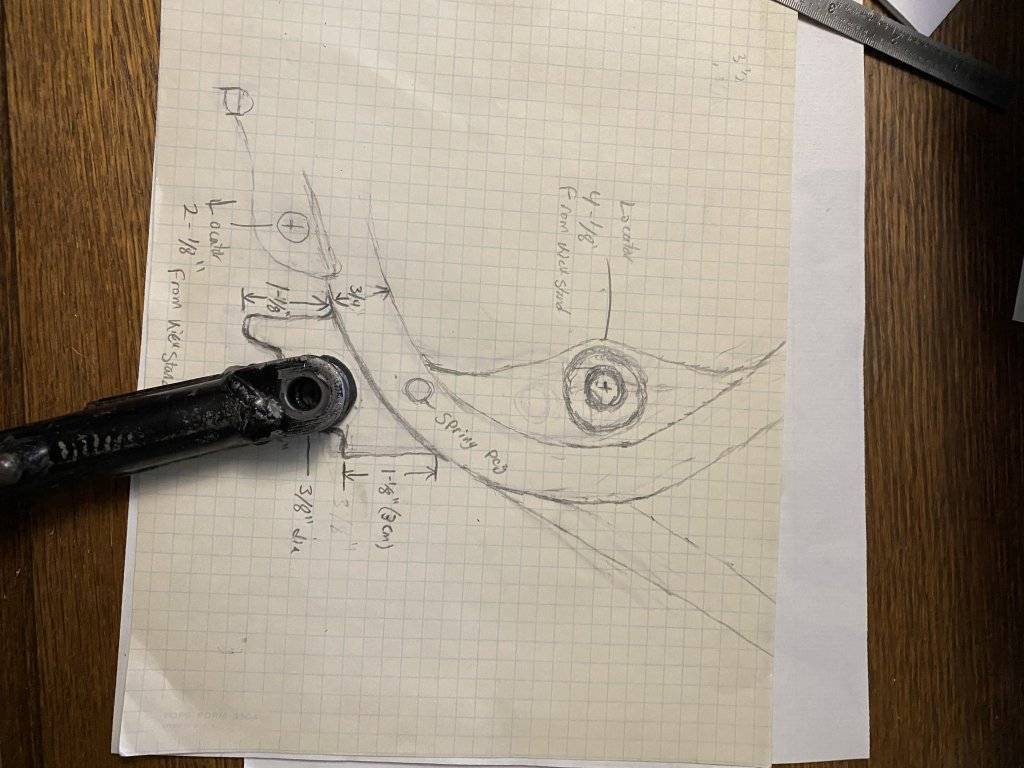

Also had to re build the kickstand mount as it had been torn off. This was a challenge as I had to shape and weld progressively thicker material to the thin tube.

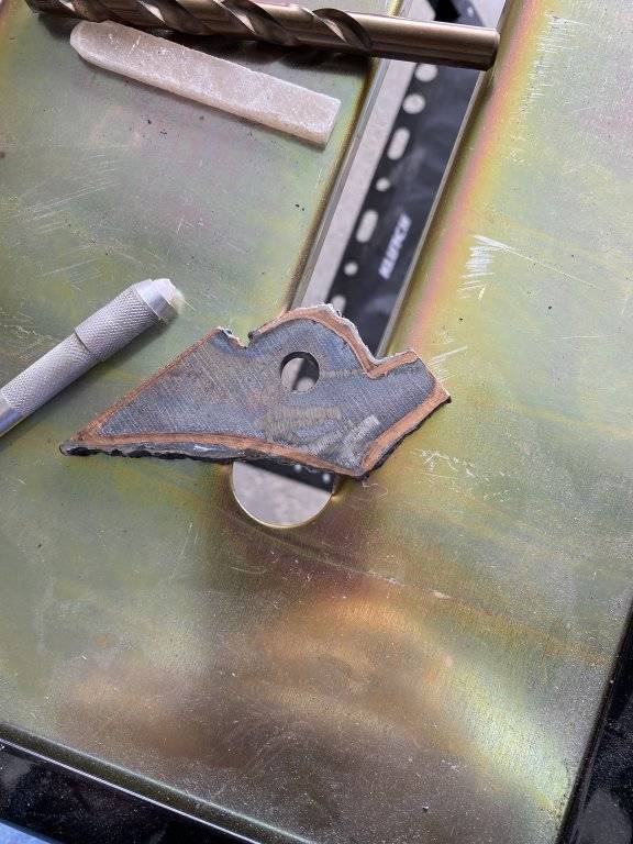

Started with tracing out a pattern using what was left of mine and pictures from the internet.
Positioning the kickstand saddle. Did a little hot forging. Also found that if I pre heated the thicker material it was easier to weld to the thinner material.
Checking the fit before cutting out the mount.
I am not too concerned about the weld penetration as I had to heat it and bend /hammer/forge it to the right angle and position.

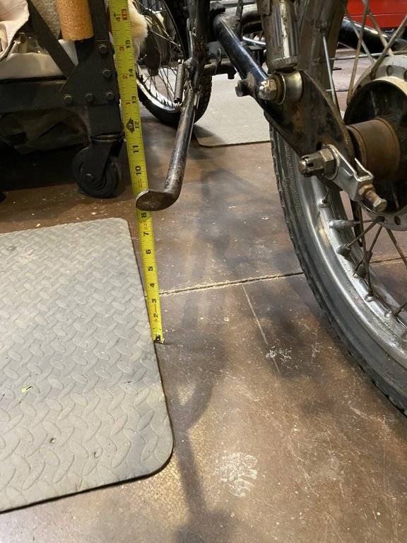

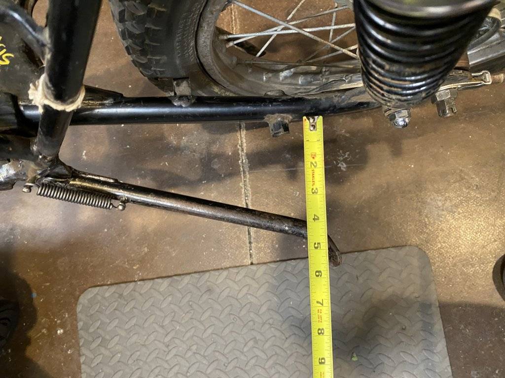

First attempt the bike sat up too straight and the kickstand was a little too far from the frame when up.
Getting a little better, but sticking out to far when up
Now about right. Nothing a little heat, large Crescent Wrench, Pipe wrench and hammer couldn’t fix.

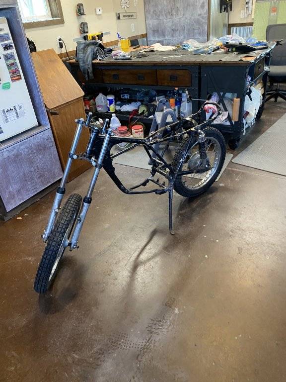

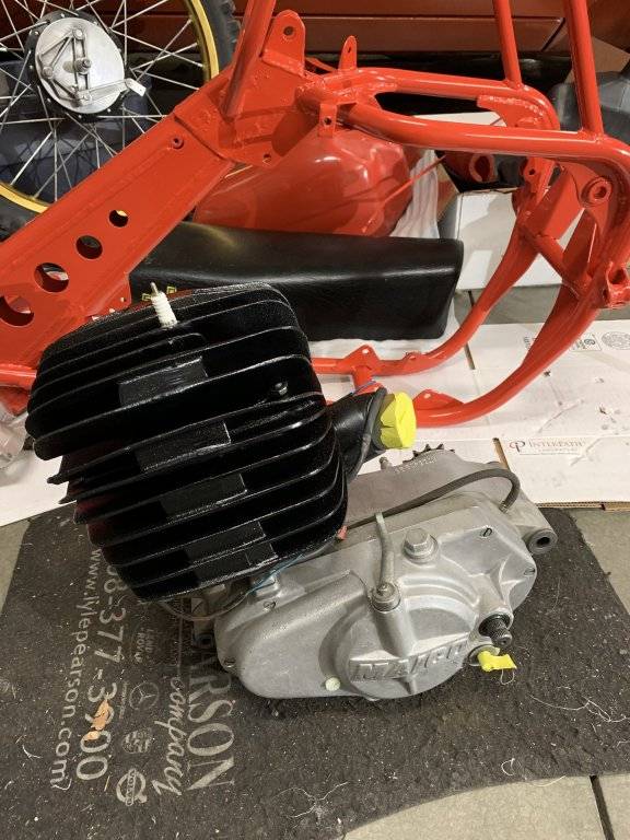

Now time for sand blasting and painting.

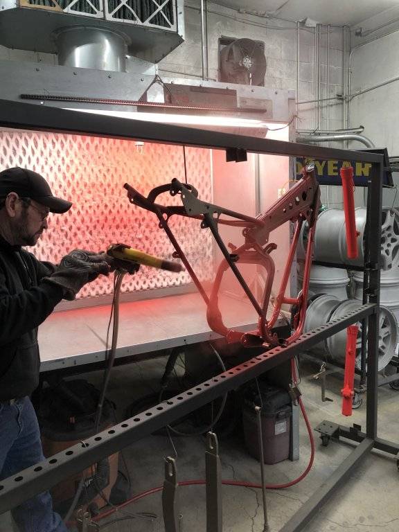

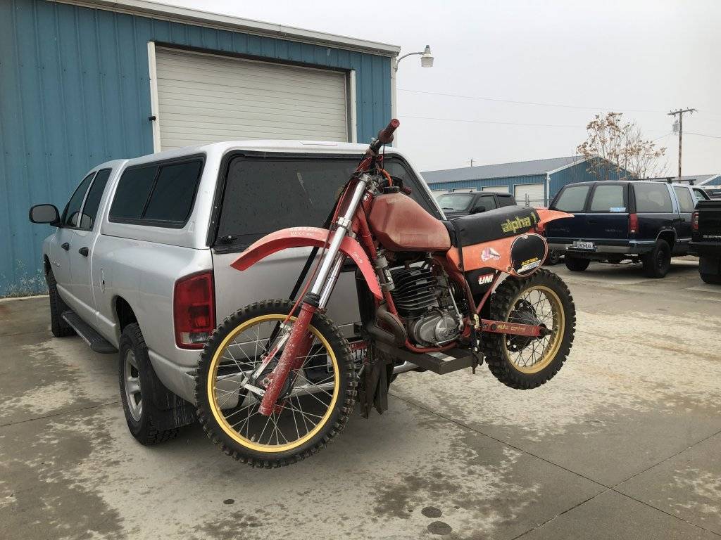

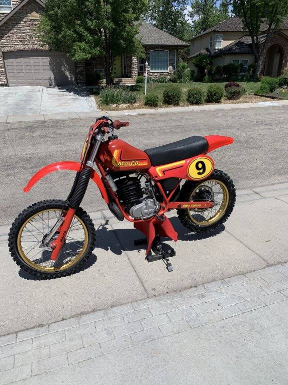

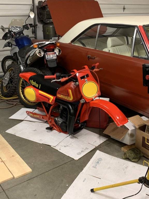

I went to town on my Maico 490 as soon as I got it. About 10 weeks start to finish . It helped that my buddy owns a powder coating business .
The last pic was taken at Washugal MX park in Washington.
