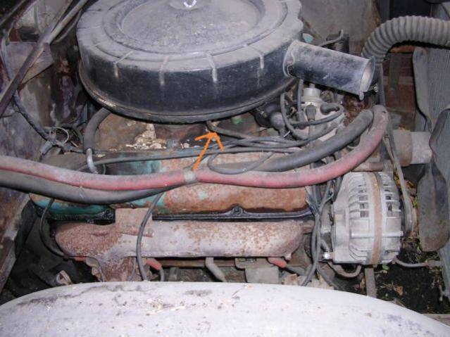

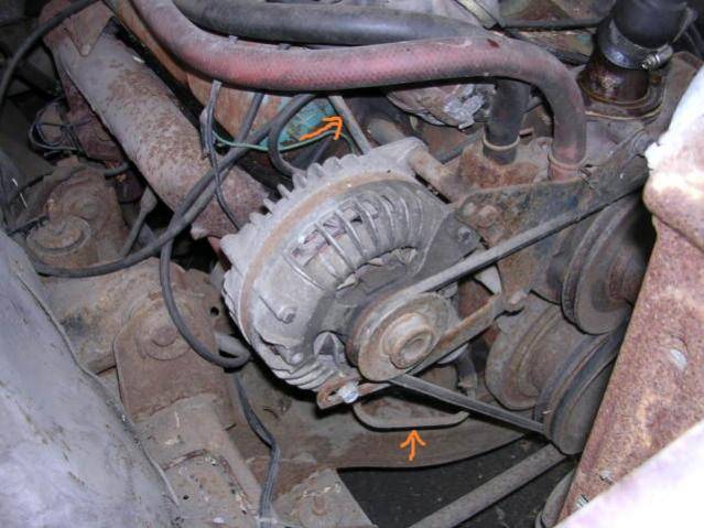

Here's an original setup. Of course, this is a 2 bbl, but the first shows the fuel line coming off the carb. The second shows the fuel line off the pump and up behind the alternator and you can just make out the filter behind the alternator.
