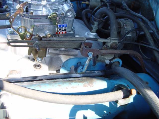

Old linkage picture of mine.....
Stan has an excellent linkage picture that shows perfect detail.

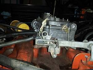

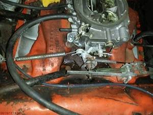

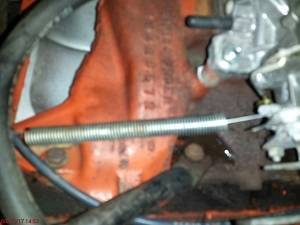

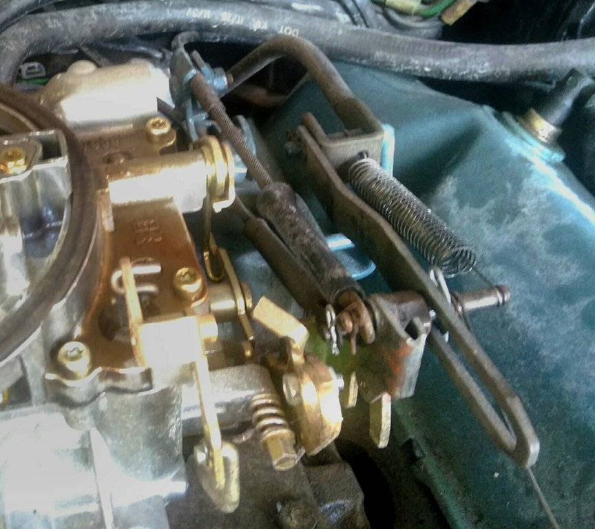

The throttle feels "OK" when I move it by hand. By OK I mean it moves with no binding of any sort. This is the same if the kickdown linkage is hooked up or not and it's the same with the green spring on or not. The throttle plates don't return to the closed position if I don't have the return spring connected. My return spring is much heavier than the one in the photos so???
It is an Edelbrock carburetor almost identical to the one in the photos and it is on the stock 440HP manifold.
Disregard the wetness on the intake manifold. I washed the motor this AM.
wrong spring. it's way too stiff. probably better suited for a screen door :) look at stan's pictures for the correct spring.
Yes it's the wrong spring BUT I didn't steel it off a screen door. I'd never do something so foolish.
It was a STORM door. The screen door is on the back of the house :D.
Seriously, if I may, the photo Stan put up has a lighter spring but there is also another wire? Is that just the same spring wire looped around the throttle post? It so long that I can't see an end on it and I don't know if that's the case or if it is something different?
