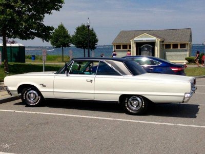

    Does anyone know who would carry preferably new gas tanks for a 65 Monaco?Or what other models use the same tank? IMG_0917.jpg

    No reproductions for '65's. You have to either fix yours or get a good donor from a '65 Monaco, Polara, or Custom 880.

    would a'66 tank be interchangeable?

    Is your fill pipe behind the license plate?

    It is. All '65 Monaco's, Polara, Custom 880's are. Not sure about wagons.

    Then my money is on the fact that a 67/68 C-body tank should fit.
    Just a matter of # of ports on the tank.

    I am not saying that there is a tank out there that will or will not be an exact replacement, but I have never seen a repro tank say that it fits a '65, it is always '66 and up. '65's are a different animal on a whole bunch of different fronts.
