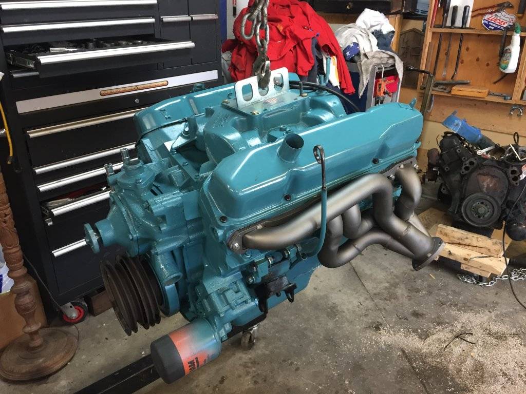

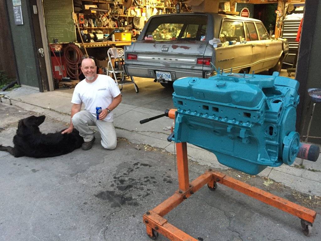

My 383 Coronet wagon is great with stock converter and 2.94 rear. I find it perfect for both city and highway. I have the engine torque up a bit. Strong RV cam, 440 source heads, Edelbrock performer intake, Thermoquad, curved distributor, shorty TTI headers with full 2.5 dual exhaust from TTI, 275/60r15 rear tires. etc Etc....

My papers show it is a 260H. It came with the short block in a deal for unpaid labour. I am still going to rebuild my original 383 one day to my specs. I will remove the shorty headers as well. I am sure it will hurt performance but I don't see any high RPM runs to much in the wagons future, the HP Manifolds and stock looking engines are cool by me.
Just looking through the wagons file, it could be a 268H in there. It's been a while and a bunch of other builds ago.
Look at Lunati Cams, some of which Summit sells for a good price. But with the smaller engine, it can be easier to over-cam it than with a 440, for example. They, like CompCams, have or used to have some cams with assymetrical lobes that puts more area under the lift curve for better cyl filling.
