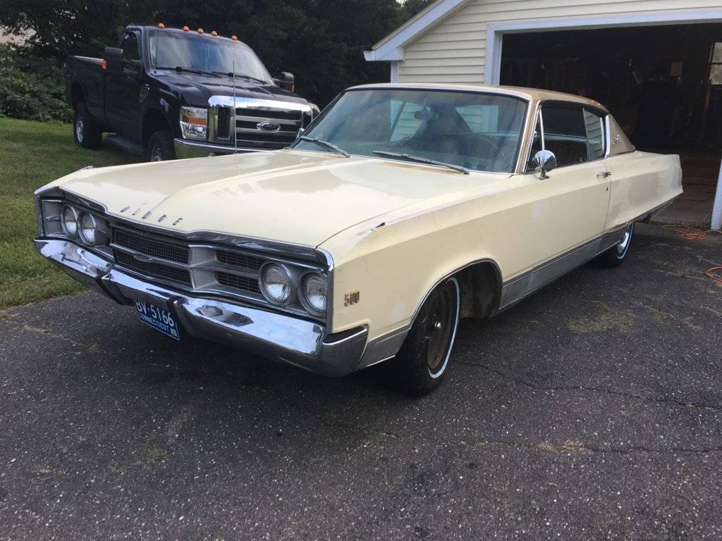

Alright. I wouldn't say she's 'responsive' but then who would say that about a C Body?

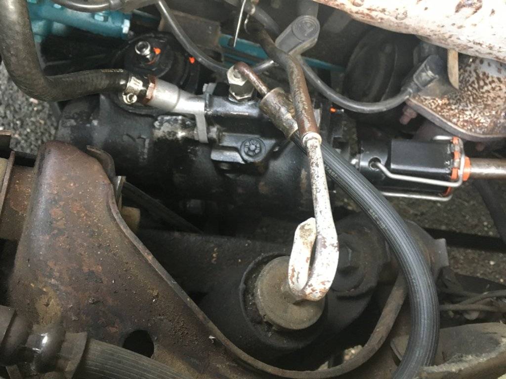

She tracks along straight, locks in at center in a way she never did while I've owned her. Only thing is that even after bleeding, she chirps a lot at low RPM. This was happeneing before as well but usually towards the stop. Not sure if this is a dying pump or if my idle is too low when in gear. Honestly, I'd prefer it was the pump as I've replaced everything else and the excuse to do the pump too would be welcomed.
Either way, I'll keep her close to home for the next little while. After that, it's foliage (the New England celebration of the DEATH of summer) time. Gotta get a few miles on with her before the salt hits the road!

I think the best part of owning this particular car has been learning to get off my own back. She's not a daily driver (unlike my first Monaco) so theres really no stress other than what I create. She's had a lot of issues and some really feel beyond my capabilities but sh**, If I have to get a professional to take care of the stuff I can't (mostly body), I'll figure it out. .. She's worth it.

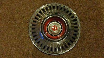

What are you planning regarding the wheels? those slightly rusty steelies do not make justice for the paint.
The wheel covers are off as I'd done the wheel bearings. I'm actually quite partial to the wheel covers (though they need a going over) but I'd really like 15" wheels. I'll either get a good set of 15" steelies and have them adapted to accept the stock wheel covers or I may go with magnums once the tires run down.
For now I haven't made it that far. I've been preoccupied with making it road worthy which it just barely is now. Big items are going to be basically the rest of the suspension (front and back) and the transmission leaks like crazy. There's also a very dry sound in the back end. I can't quite tell if it's a bearing or a U joint but since I'll have to have the tranny done I'll get into that at the same time. Hoping for pre spring 2019 on all that.
The engine is still strong though I'm pretty sure I have a valve cover leak that I've been mistaking for blow by out the breather (really hoping I'm right on that).
Which brings me to the body, ive still got to get the cowl vent and fenders off and clean the drain, there's some spots in the fire wall that need looking after. There's also spots in the trunk but not too much point in getting into that until the really ugly stuff around the rear window is dealt with. I'm only really going to know the extent of that once the interior is out. Floors are still a question but I'm certain they're no worse than the trunk.
Problem is that I've seen just enough to know that it's entirely doable but that there is a lot and while a large part of me wants to pick at it and drive in the summer, she's begging for a full restore. Just gotta get my a** off the fence on that one!
That sounds like a good plan! I`d recommend the Magnum 500s measuring 15´´ in diameter but it´s only my 2 cents.
Keep at it!! Took me 12 years to finish my C.
The Magnum 500's are pretty but tough to get a good balance out of them.
As an alternative go with the optional 15 inch disc brake wheel covers over 5th Ave/Diplomat 15 x 7 steel wheels.
