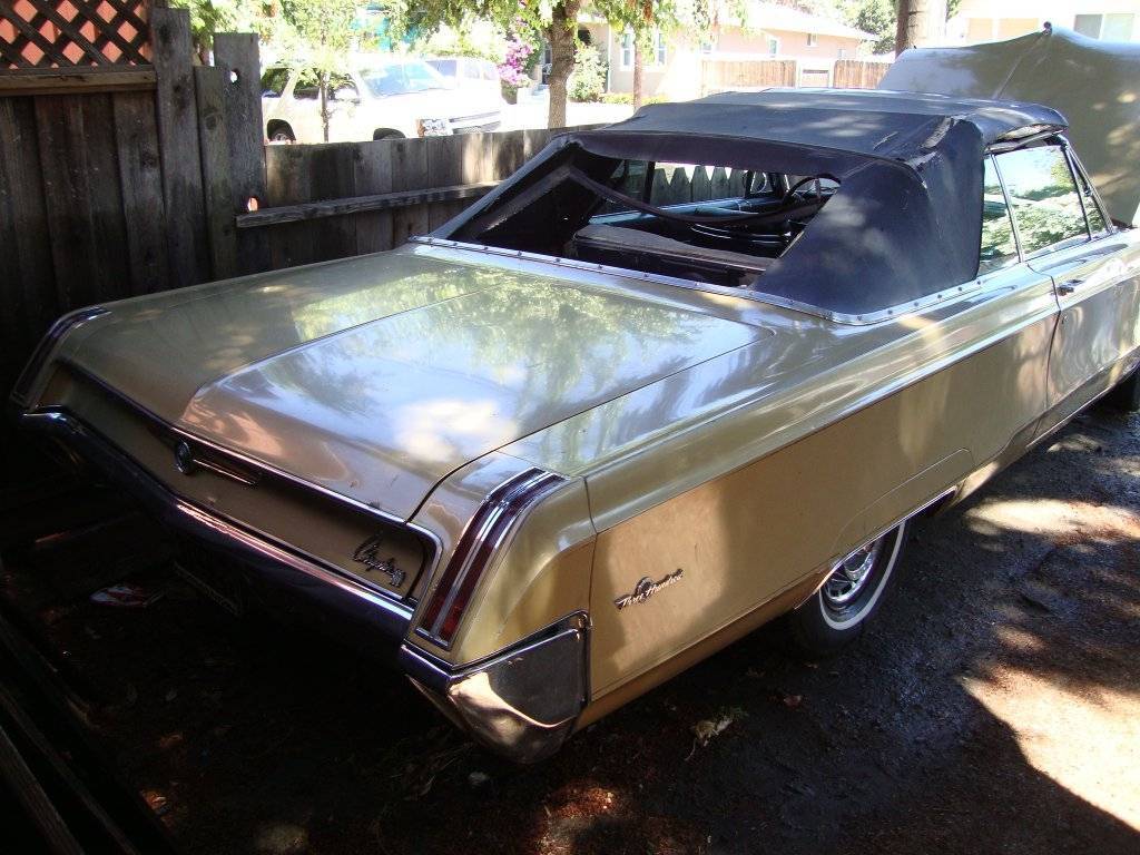

is your the top the same as 67-68 chrysler 300 rag , if so they offer a glass rear window or plastic . i sure the bowes are the same and so are windshields and side glass doors n quarters . not sure about the well that the top fits in when down . there is were the glass window might have issues . thats a 66 fury n two 67 chrysler 300 rags

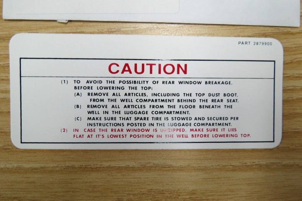

As side note, a 2016 Graveyard Cars episode had a convertible w/ glass window. They discuss being careful to not push packages in the trunk into the well area or the glass can crack when lowered. Don't recall if a B or C body and exact year. Originally, the wells had a warning label.
