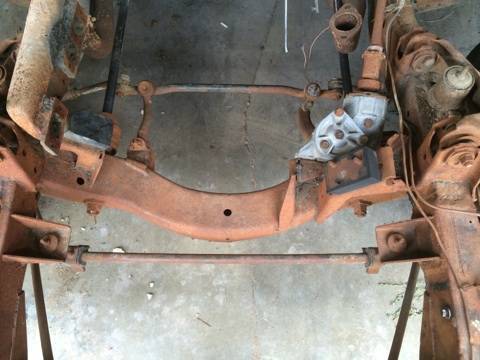

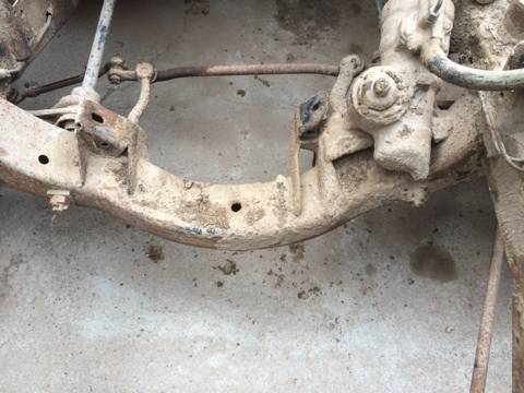

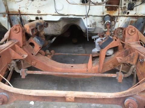

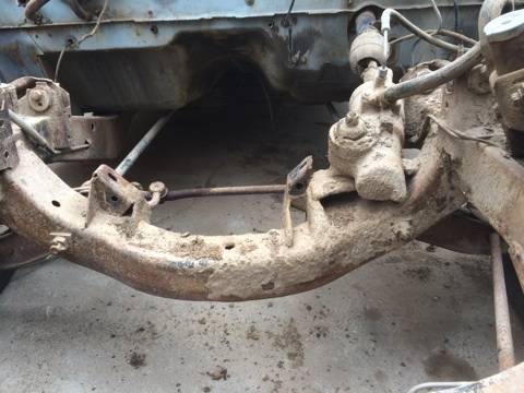

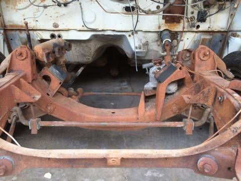

Is there any chance you can post pics of the two different sub frames? Particularly interested in what the engine mounting points look like on the 66 sub frame.
I'll try and get some at lunch. which is where i'm headed now! lol
What about the possibility of updating to a more modern transmission in that thing? Maybe going with the A-518 automatic overdrive transmission. Just a thought unless your trying to keep things all original.Might make it more enjoyable to drive in the future if you do alot of highway driving and want a little better mileage.
The mounting points on the 65 and 66 are not the same. Driver's side is farther forward. Also the power steering is located differently.

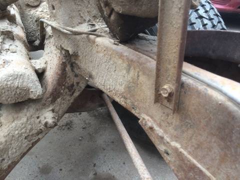

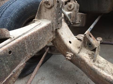

65 stub frame and damage

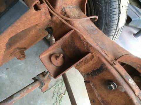

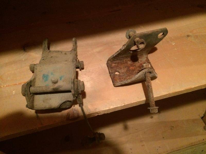

And are these my engine mounts? They were in the trunk of the 65.
The 66 frame will be simpler to mount any 440 into. The 65 frame requires a 440 block with a special mounting bosses. basically the smaller bracket pictured has to bolt onto the corner of the block on the driver side. I have a picture of a block to show what is needed. It is kind of a pain because not all 440 came with the needed mount points but it was frequently on the 383 engines.
