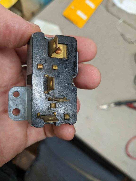

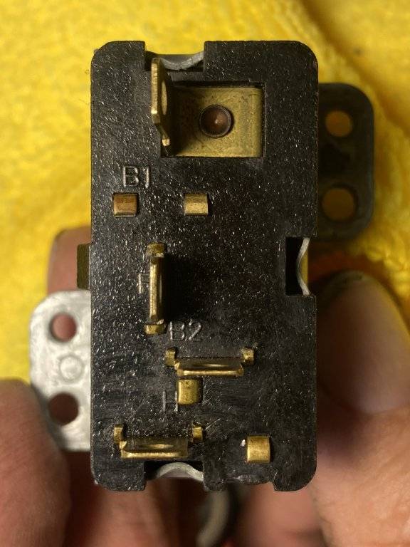

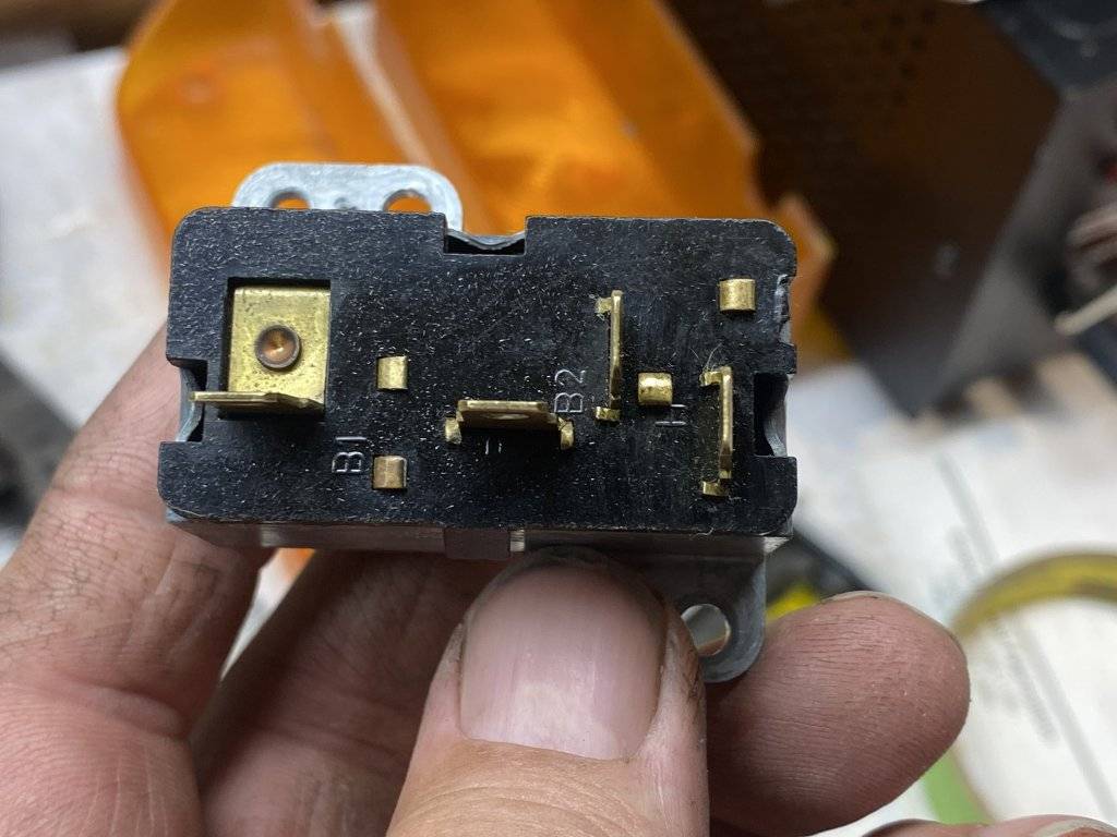

Backside, spades B1, B2, H, R factory marks
Input Current
B1 Upper vertical spade, L1 16BK, from junction with wire from Battery feed at FB, provides headlight power
B2 Upper horizontal spade, L8 18P, power from taillamp fuse at FB, provides taillight and IC light panel power (2nd wire provided power to key on buzzer, disconnected)
Output current
H (headlight) lower horizonal spade, L2 16LG, foot dimmer > HL, and concealed HL relay (time delay relay deleted)
R (rear) lower vertical spade, L7 18BK to TL and L7A 18BK to Dimmer, which provides power for IC light panel

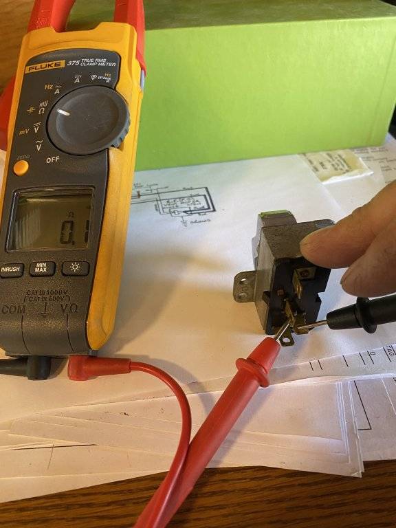

Resistance B1 > H: 2.3 ohms with headlight switch on, infinite with headlight switch off
Resistance B2 > R: 6.4 ohms, headlight switch in parking light position, varies from 127 ohms to 2000 ohms with headlight switch in on position. Resistance is infinite with headlight switch off.

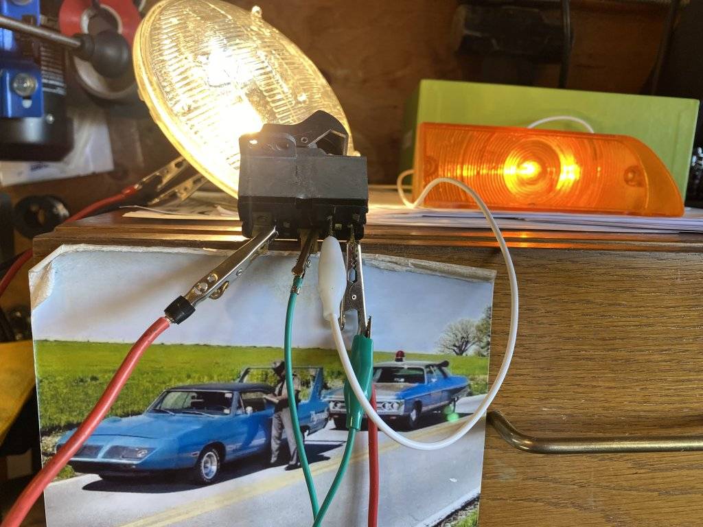

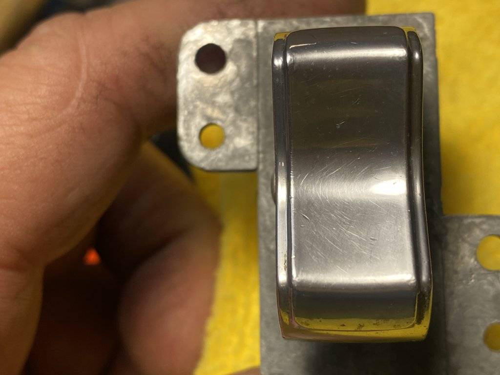

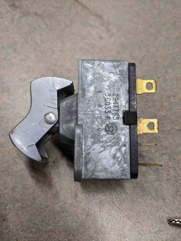

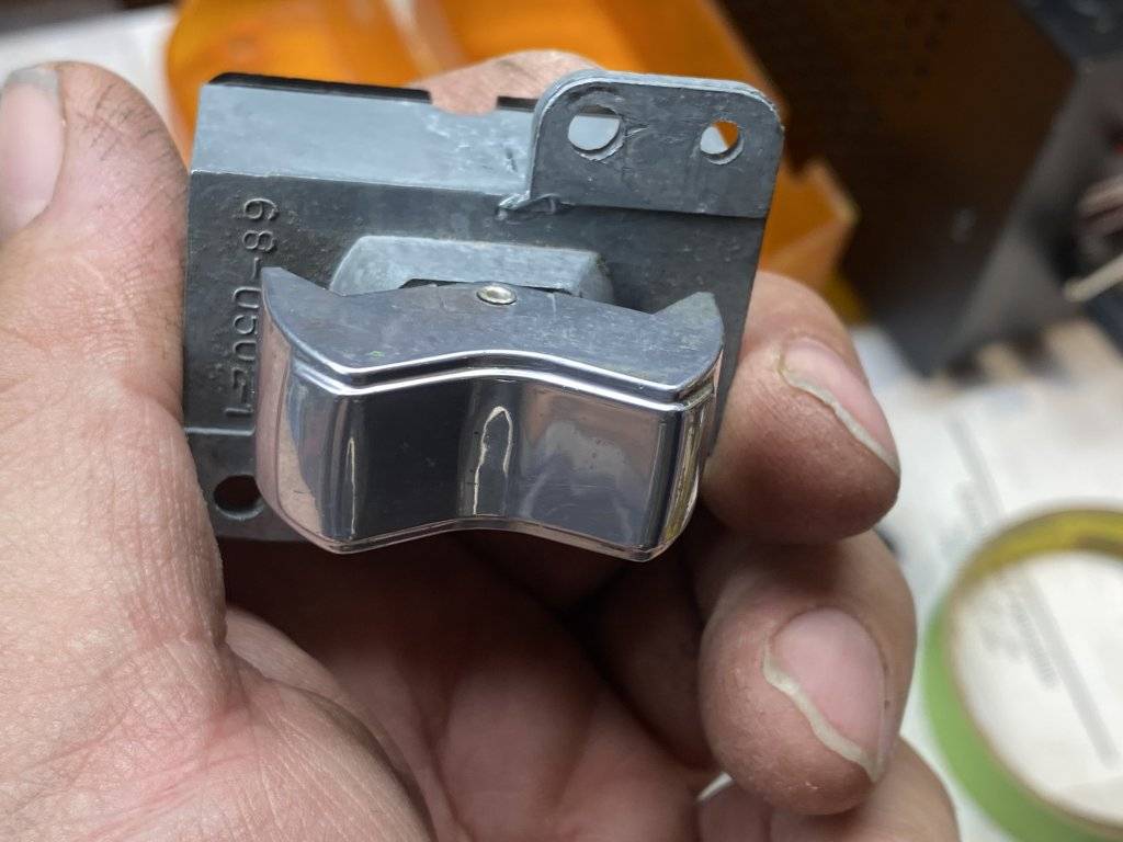

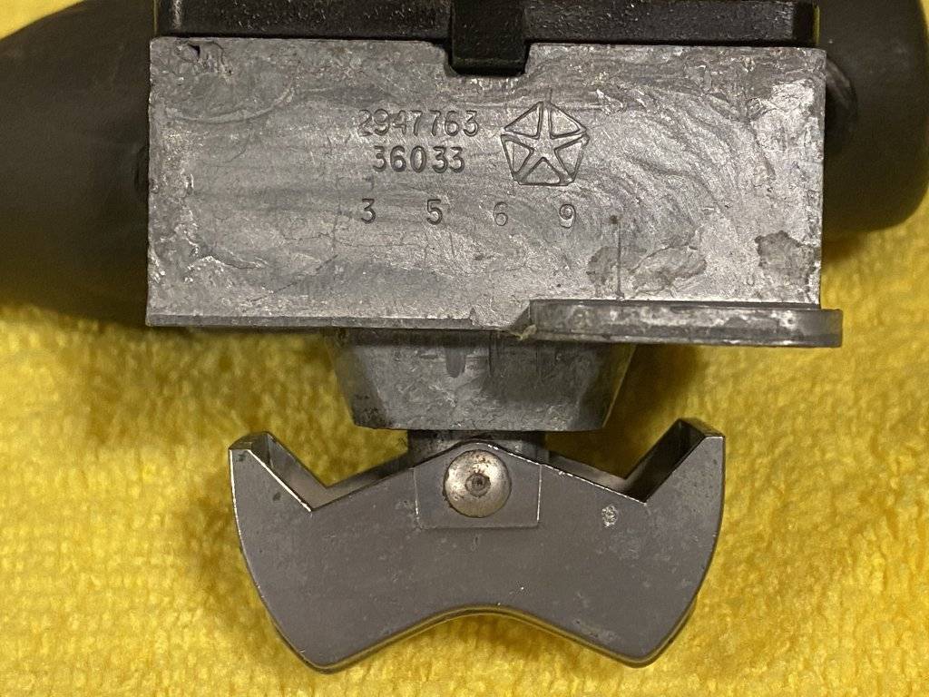

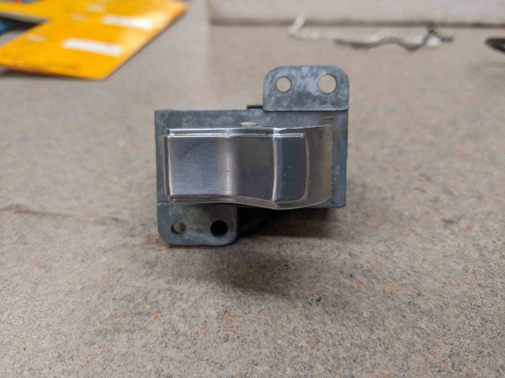

I have one of those switches if things don’t work out for you. the polished finish is in nice shape , the switch movement is great. I will test it with my multi meter if your interested. $10 and the ride. It was in a gauge cluster I had sitting on the shelf in my garage. Good luck on your switch rebuild.
I have one of those switches if things don’t work out for you. the polished finish is in nice shape , the switch movement is great. I will test it with my multi meter if your interested. $10 and the ride. It was in a gauge cluster I had sitting on the shelf in my garage. Good luck on your switch rebuild. View attachment 555659View attachment 555660View attachment 555661View attachment 555662View attachment 555663View attachment 555664View attachment 555665View attachment 555666View attachment 555667

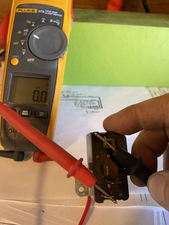

I'm interested. Please check the resistance and let me know. Thanks

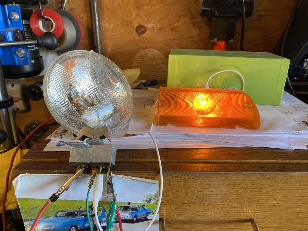

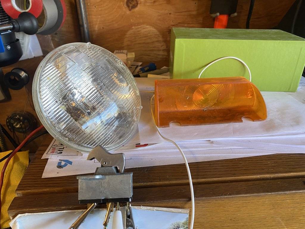

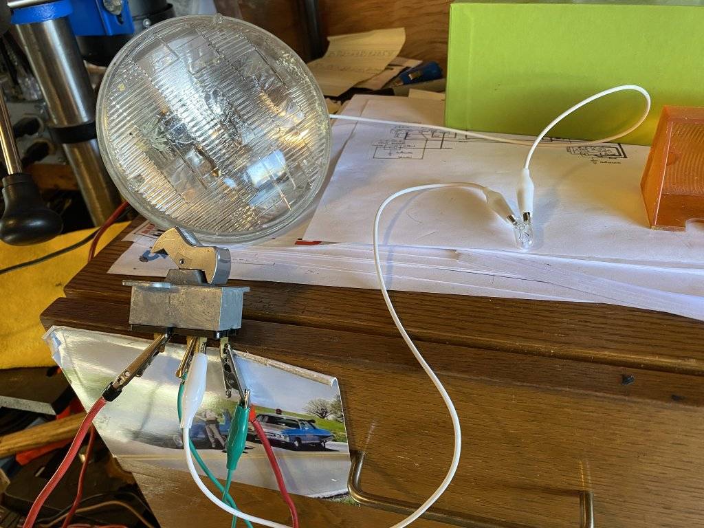

Well I wired it up with my 12 volt source. It had good off, park , headlight /park together.
