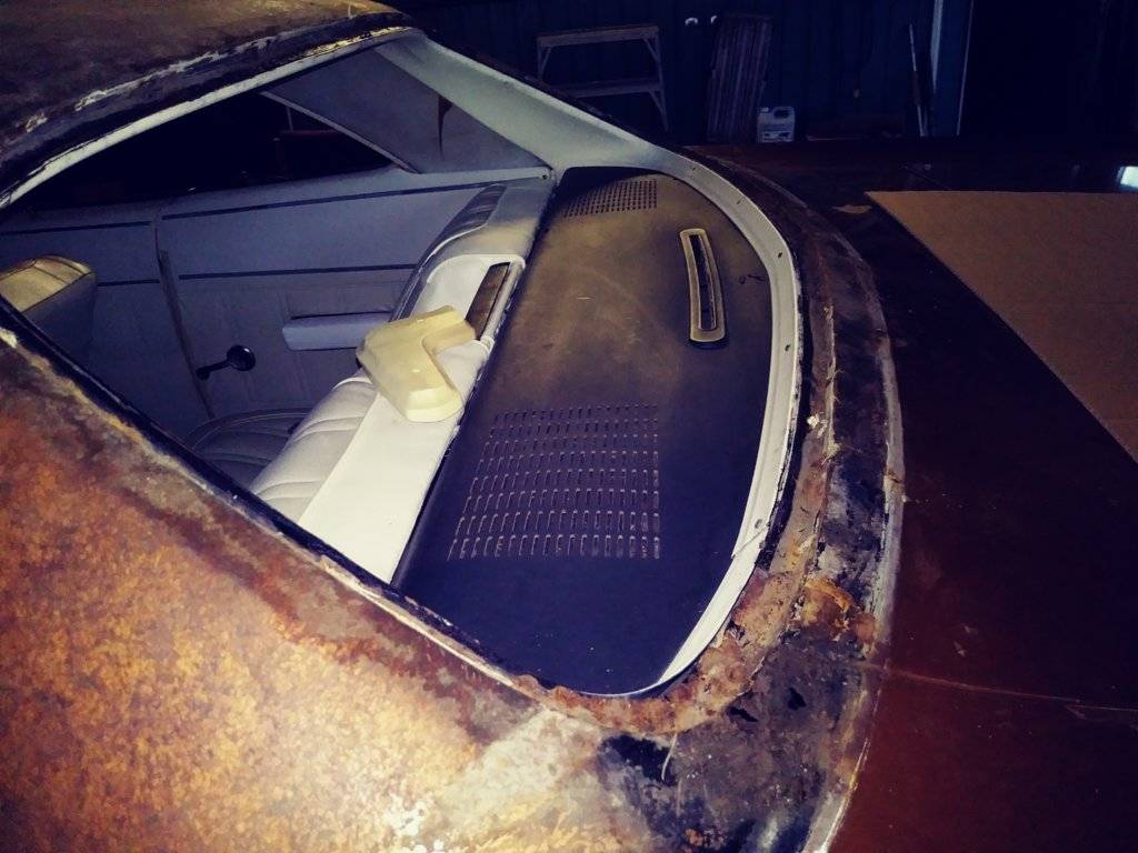

Frankie the 69 Fury III aka Maggie May needs a new headliner. Ripped in a couple places. (See a rip in C pillar )and a few mice munched on it as well.
I have my guy lined up that is doing the vinyl top and headliner.
The back window and tip trim is removed so now is a better time to do it.
