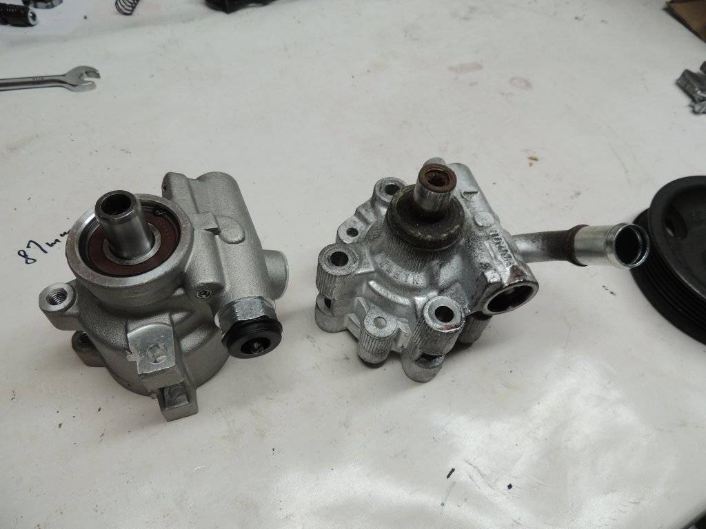

After hours of research I have found that Tuff Stuff sells GM Type 2 pumps with different configurations. So I ordered one with 1200 PSI and 3 GPM flow specs. It has similar dimensions to original Hemi pump, same shaft diameter. It will be arriving tonight.

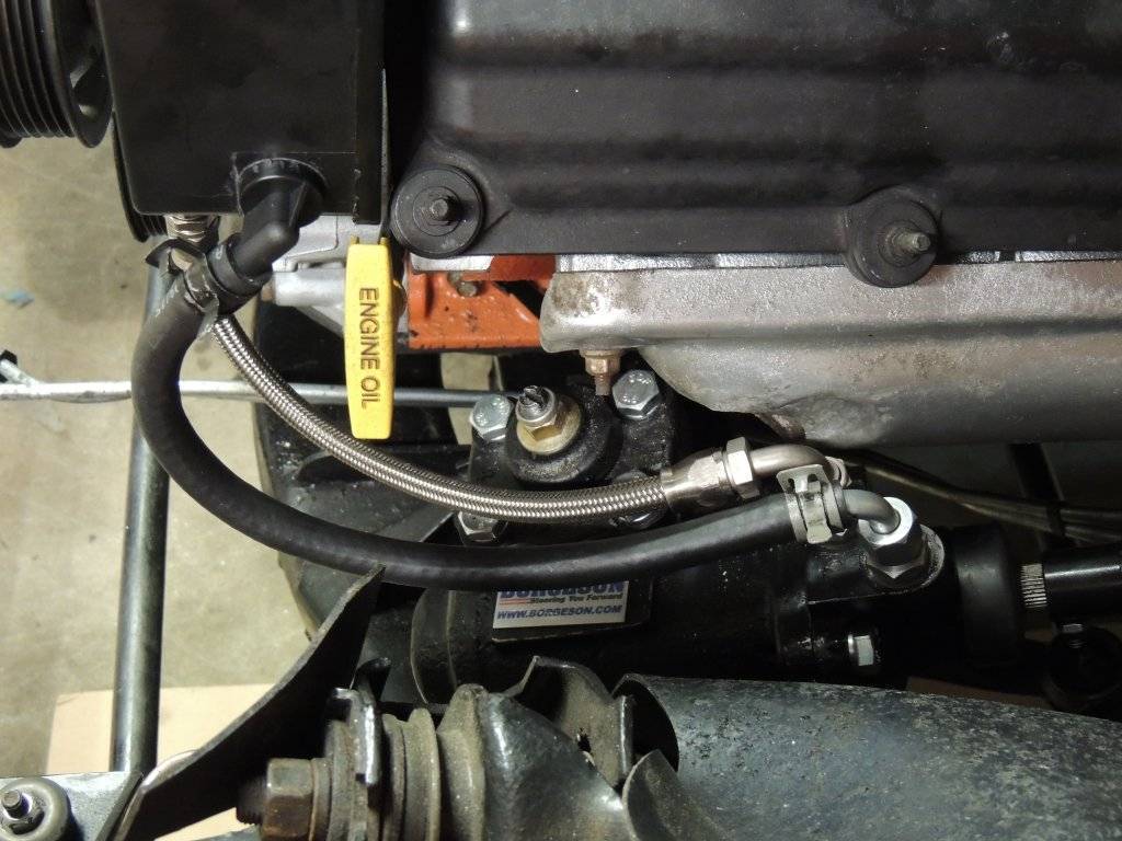

Steering pump came in last night.

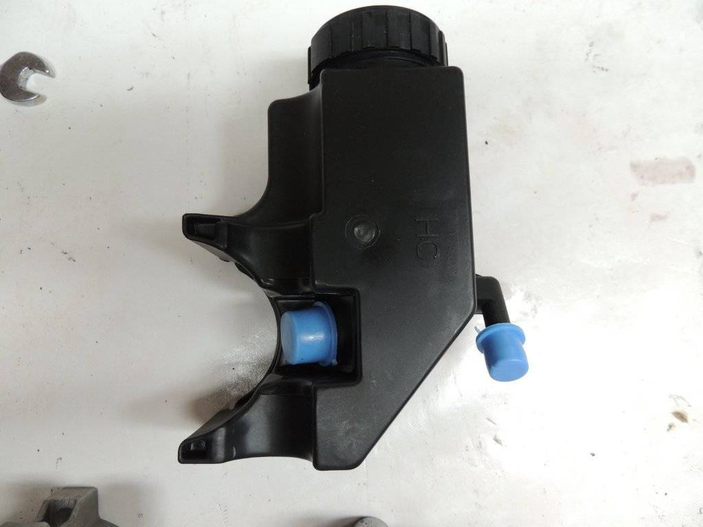

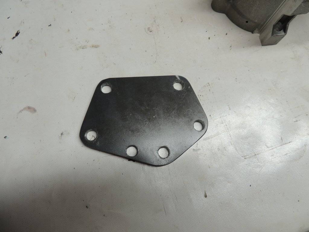

It is actually same size as Charger pump. Same mounting dimensions, same shaft diameter, same pressure fitting. If I was going to use remote reservoir it would have been a straight swap, but I specifically wanted a pump with a tank. In order for tank to be vertical I will have to make an adapter. Did not have time to finish it.

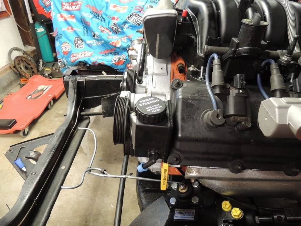

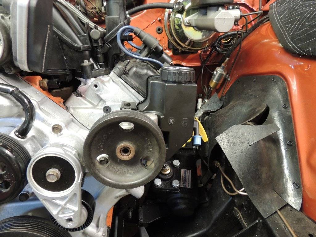

Steering pump assembled and installed.
Made pressure and return hoses. Filled up with ATF+4 and bled the air. No leaks do far

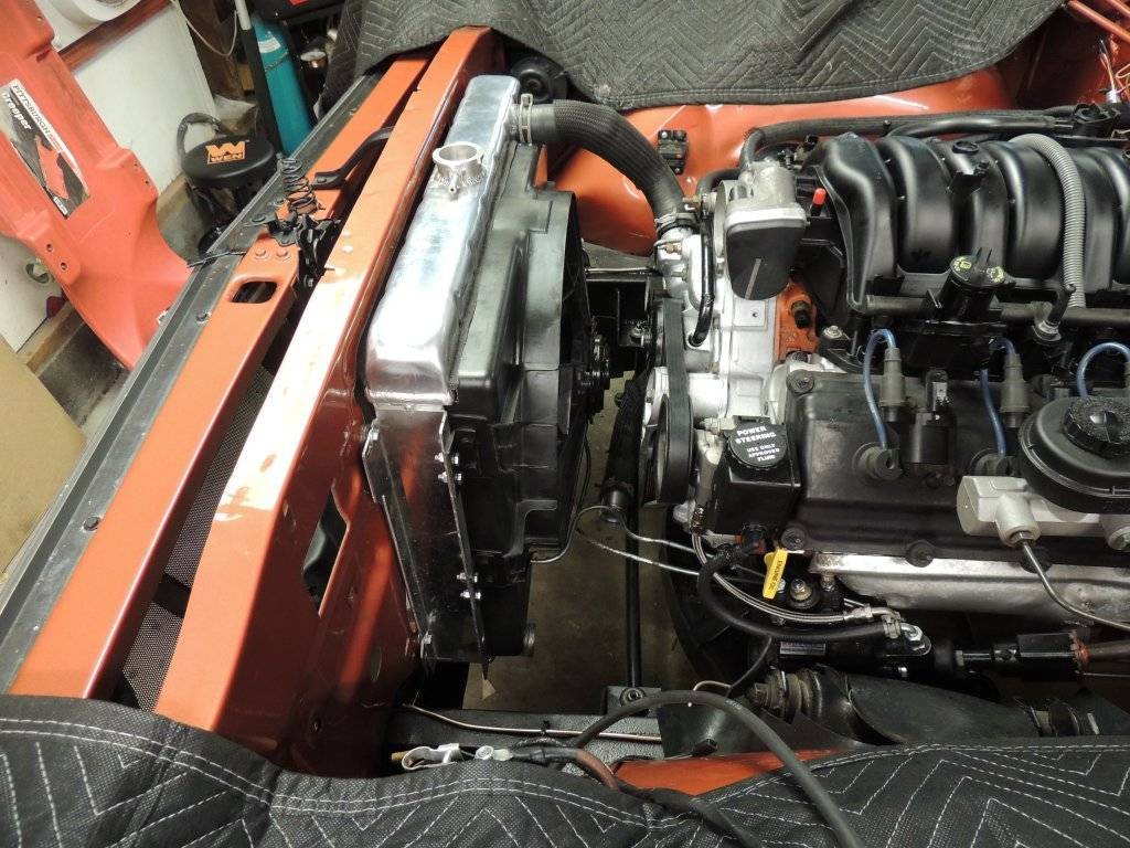

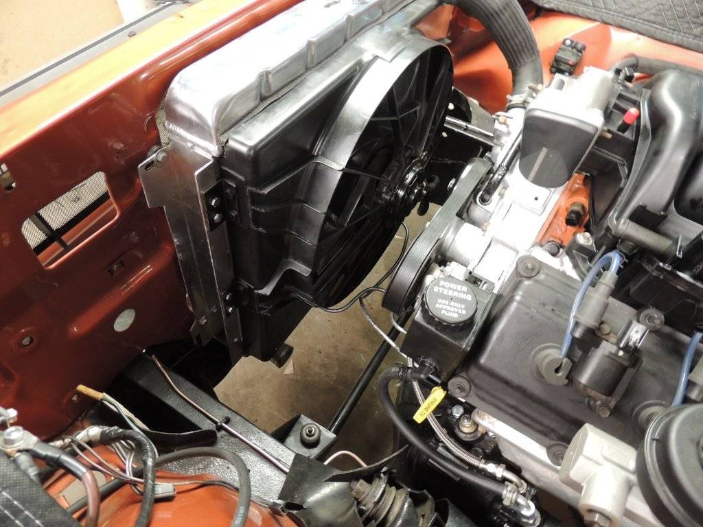

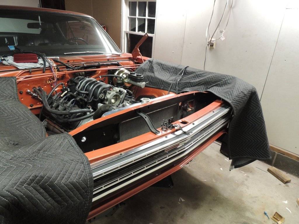

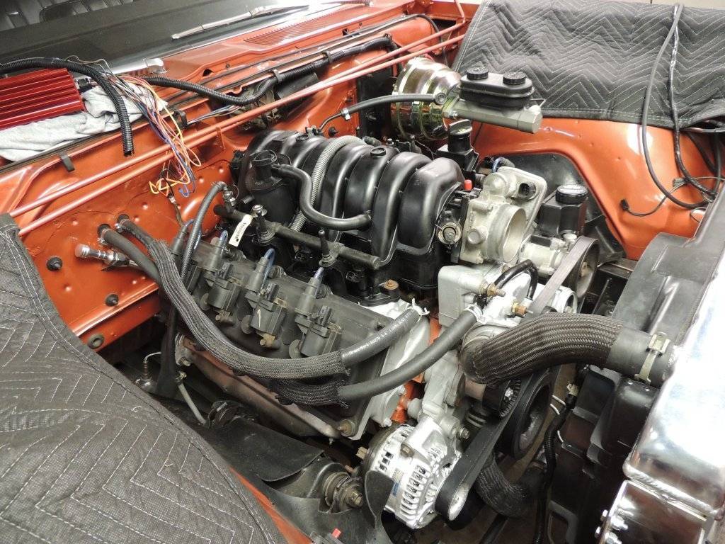

Rad. support and grille are back on. Installed electric fan, radiator, heater hoses. Plenty of room.
