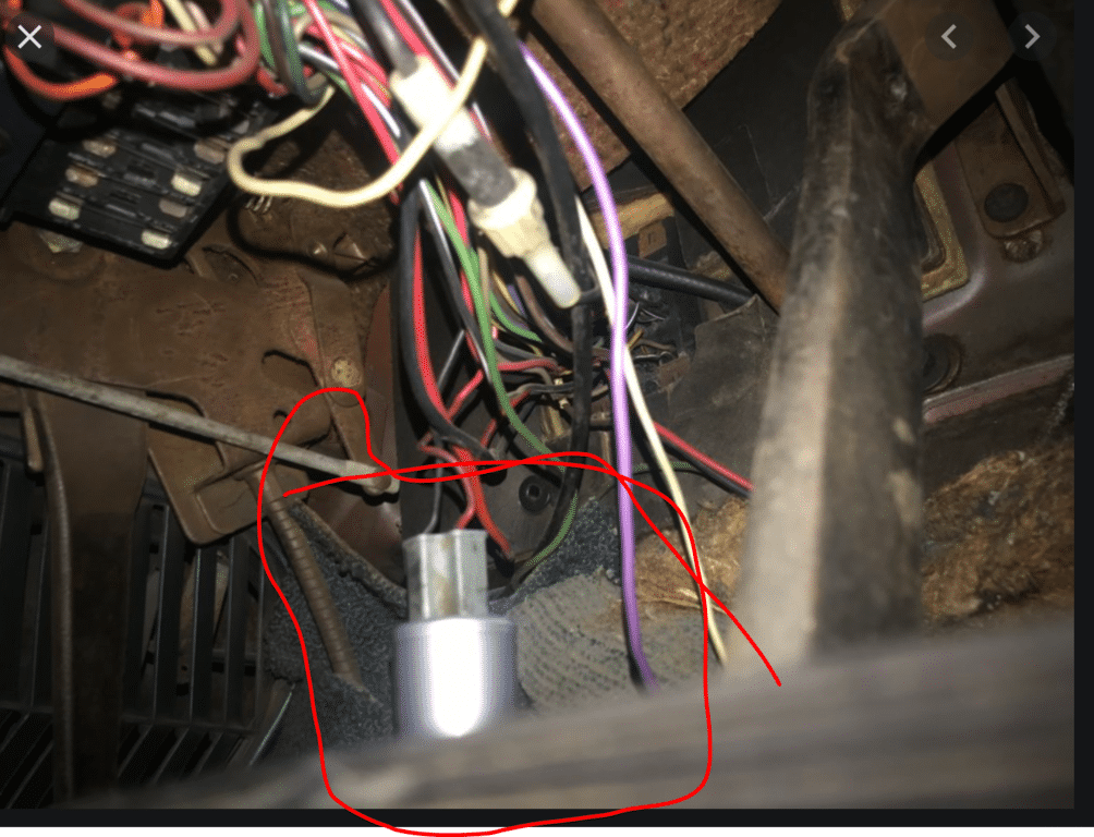

This is not meant to be insulting but the pic below is what you're looking for, circled in red. This picture is from a post from @Vinsanity in 2017 for his 67 Fury but it should be very similar.

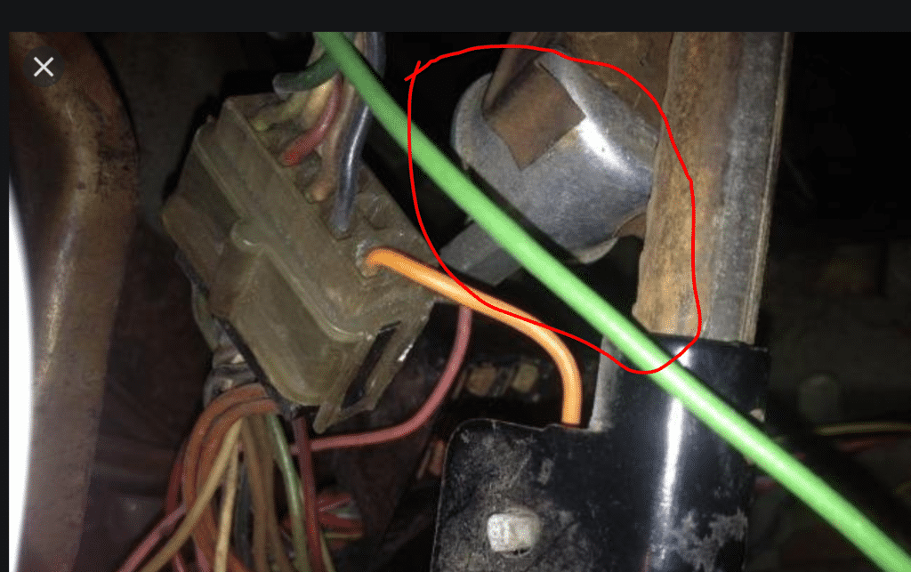

This is a pic from forabodiesonly for further reference.

Thank you!!! It's not near the steering column in mine, it is over in a receptacle under the heater switch and radio. I wasn't seeing it as a relay until I disconnected the wires and pulled it out of the cylinder holding it in place

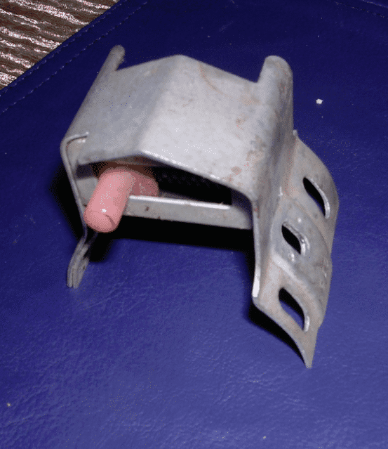

And I'm pretty sure the reverse light switch is mounted on the top of the steering column shaft just forward of the dash mounting point. The switch looks like this...... At least if your car is a 65, I've lost track now.

Connector for tail lamps/B/U lights is in the driver side kick pane IIRC... often the bachup lamp switch lije the one shown needs contact cleNing to work again. You can test it with a multi meter.
Can you clean it while installed or does the dash need to come out to fix it?
The connector is cleanable with DeOxit spray and a brass brush.
The backup switch is on the column, and can be removed without removing the dash. You may need to lower the column a bit by removing the collar that holds it to the dash.
