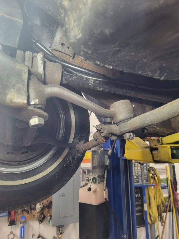

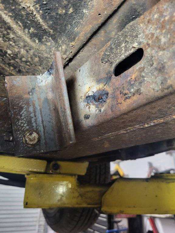

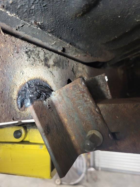

This 68 Fury 2dr post car was brought to me[customer's] to see if I could get it running/driving...As you can see from the pics it was a horrible hack job out of North Carolina. (Yes, it was a shop) Somehow, they thought a SBC was the answer to the /6 auto that was in it....

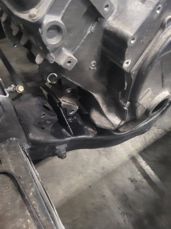

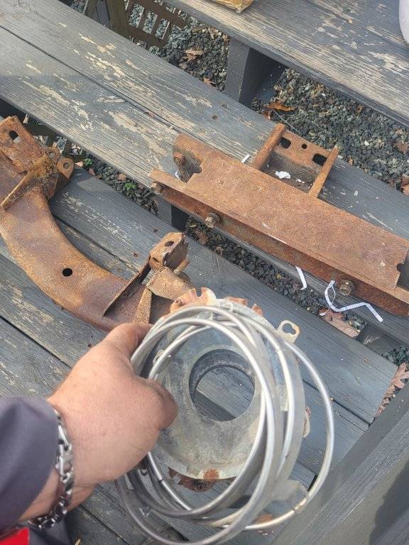

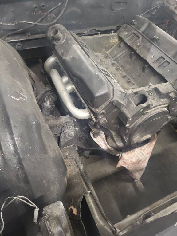

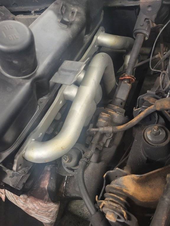

As you can see, I've completely reworked this travesty. First was to remove the SBC and related "engineering", then remove /6 mounting, and install proper V8 mounts on frame. Now to install full length headers and a mild 440.

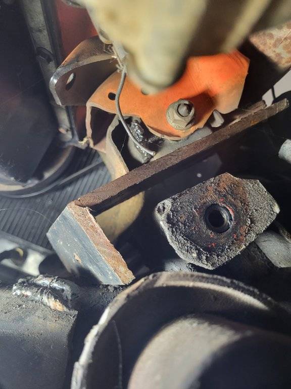

The angle iron they used looked like mattress bed frame, I use it for a lot of things to make because it's easy to acquire cheap but not motor mounts.

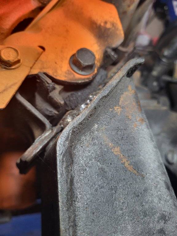

Yeah, the angle iron was tac welded to rear of subrame for *new* trans crossmember. The idler arm had bolt tac welded to keep from falling out after they bent mount down in order to clear SBC oil pan rear sump.

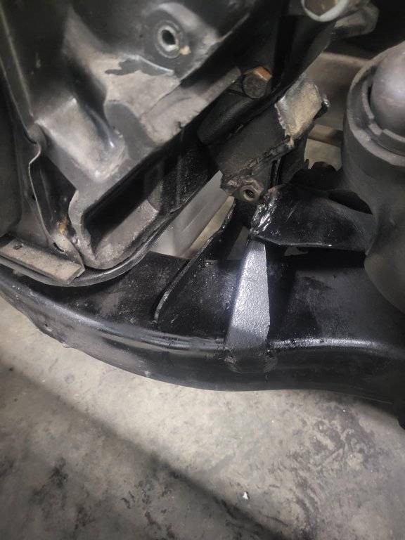

How did you measure for correct install of V8 mounts on slant 6 subframe? Thanks
A proper repair would have been to find the correct V-8 sub frame and replace the 6 cylinder one and bolt in the correct Mopar engine. A PIA. Failing that, the correct V-8 mounting system from a solid donor could probably be transplanted onto the existing frame but this will require a competent welder. The angle iron mess even with a small block chev would be likely to come apart the first time someone gets on the throttle as the welds appear to be poor quality and to be of insufficient mass. I find it hard to believe that any competent shop would have sent this car out as is with the SBC as it is an accident and a lawsuit waiting to happen. Noted the steering coupler. Good luck.

Actually wouldn't be hard,as the trans mount would be the same for any (proper, Mopar) trans of that era would be mounted in exactly the same location, so that would place the back of the engine right where it needs to be, so the front wouldn't be hard to locate from that point.
I thought the c bodies all took the same frame, much like the later b bodies did. And the difference was in the frame stands ) metal part of motor mounts) I have done a /6 to v8 in a 79 d150 years ago and that was how it was in that case.
And as for choice of materials for their makeshift motor mounts. . I thought Angle iron for bed frames was hot rolled instead of cold rolled for rigidity, but hot rolled doesn't weld very well to begin with,. Definitely more prone to cracking than cold rolled steel

We ordered a section of "k" member from Murray Park and I removed the original mounts, cleaned up metal, then measured carefully and rewelded to his car's frame in EXACTLY the same places. 440 fit right in. Full length Headers on other hand are proving to be the true PITA
Dave
So by that line of resolve, I should have removed the entire subframe in order to get BB engine mounts? Because only the factory can/is allowed to weld to the frame?
When replacing the mounts with V8 ones kept costs down in labor to a min.....
"Proper" is a relative term as you're not exactly talking to a novice at welding.

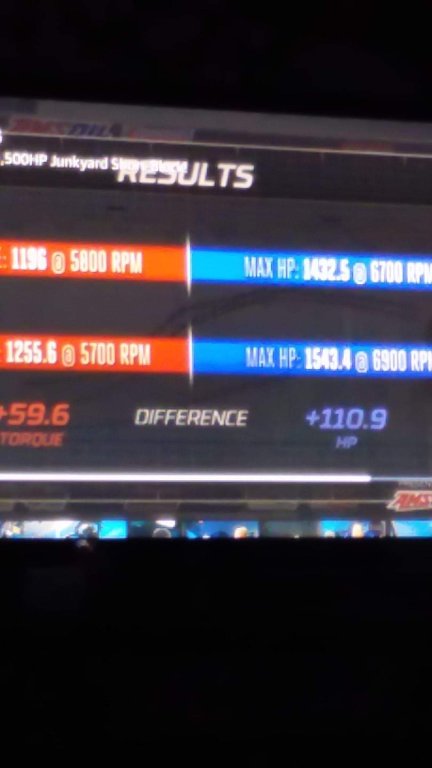

Well, being partial to my Chryslers, I'm in agreement as there's only two kinds of people who would even look at this with SBC...Those that wanna talk smack, and those that know nothing at all....BOTH are gonna laugh at this install quality I told him....So, he's agreed to "Do it correctly" so to speak. While I agree with you to an extent, there's just no denying the LS in stock form with boost. A 528 Hemi, @1543HP is cantankerous and evil to drive, let alone expensive.
Meanwhile.....stock bottom end, gen 4 rods 6.0 LS on 29.5lbs
